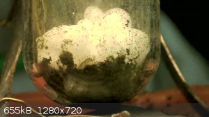

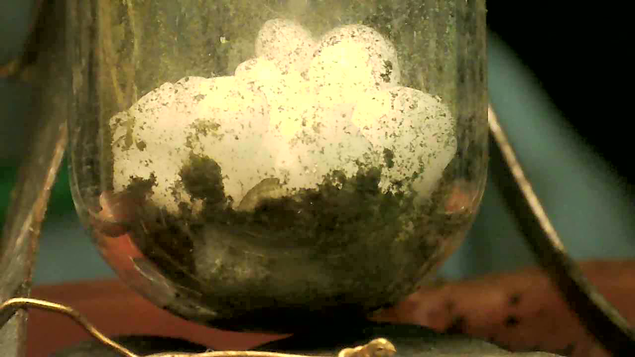

[*] posted on 6-7-2024 at 11:19
Hmm.
The copper reduced to a fine oxide powder in the test tube; kind of greenish-grey/black. ( Slightly less than 400C cooking temperature, roughly 35 watt ).
It's a bit of a pain to work with this small amount of copper oxide (I'm mildly disabled. )

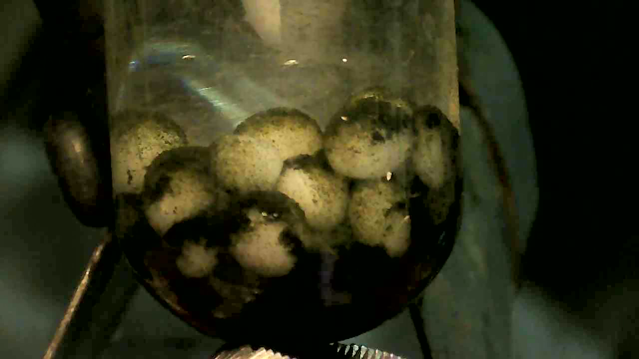

So, I'm going to just put about 1/2cc worth of urea prills on top of it, cover with kerosene (which just acts as an air barrier), and melt the urea into the powder. This ought to make bubbling from 'fizzing' as you called it, visible.
I can make more copper oxide, later, if this shows any promise at all.

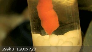

Picture of test tube just before capping with kerosene.
vlcsnap-2024-07-06-12h06m13s415.png - 655kB

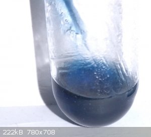

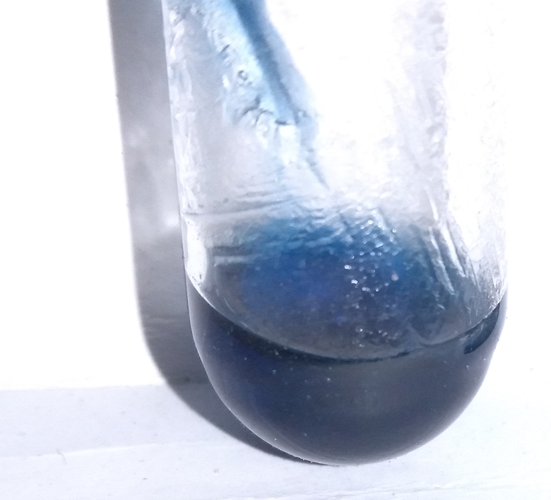

[*] posted on 6-7-2024 at 15:48

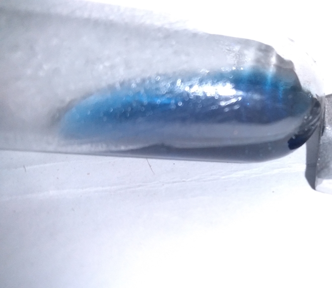

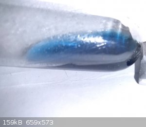

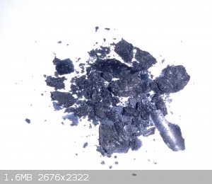

It will be very visible: it will foam a lot. I did today as you said, putting urea on top of copper oxide but without kerosene. I don't know if it would stop the foam from rising up the test tube (probably, yes). When solidified, it looks like the picture below.
20240706_201554.jpg - 1.6MB
A couple of pictures of the copper complex (tetraammine, or so it seems) dissolved in molten urea from yesterday.
20240704_193337.jpg - 222kB20240704_193319.jpg - 159kB
Edit: Typo.
[Edited on 7-7-2024 by bnull]

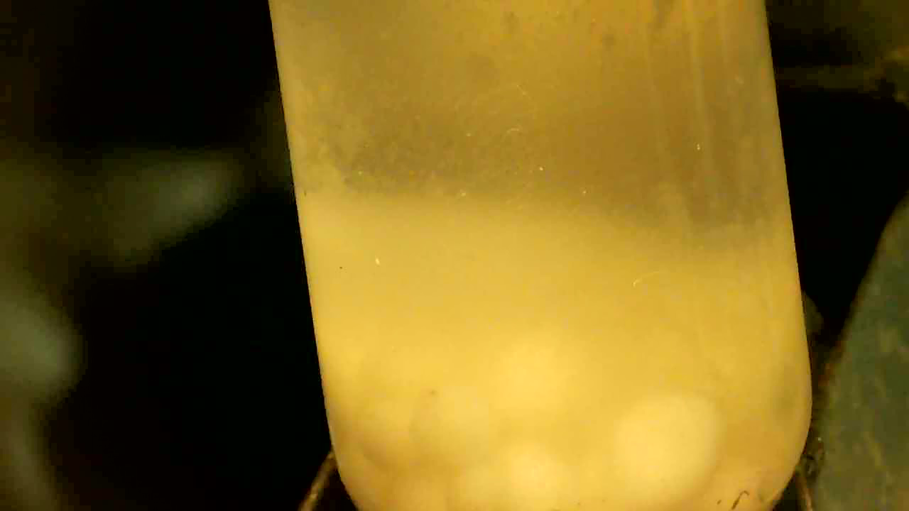

[*] posted on 6-7-2024 at 17:07

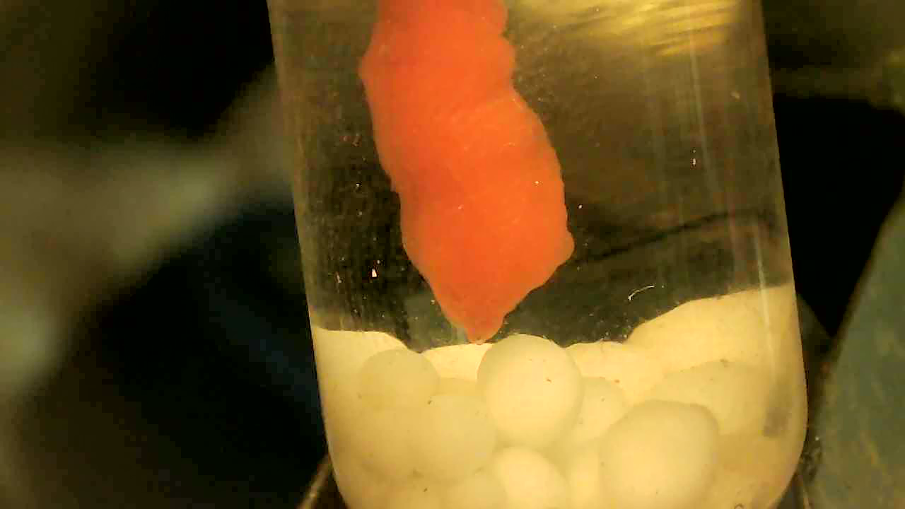

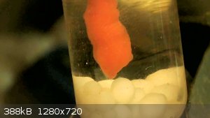

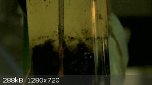

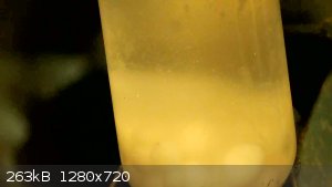

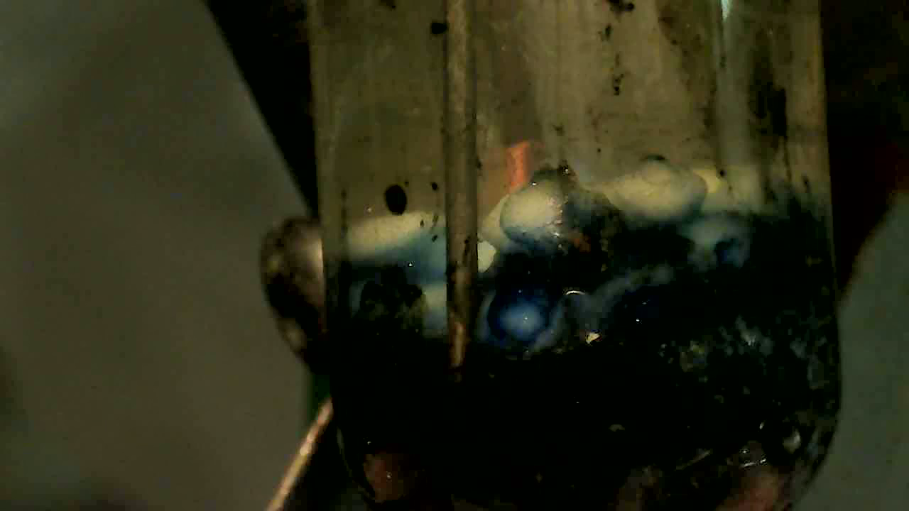

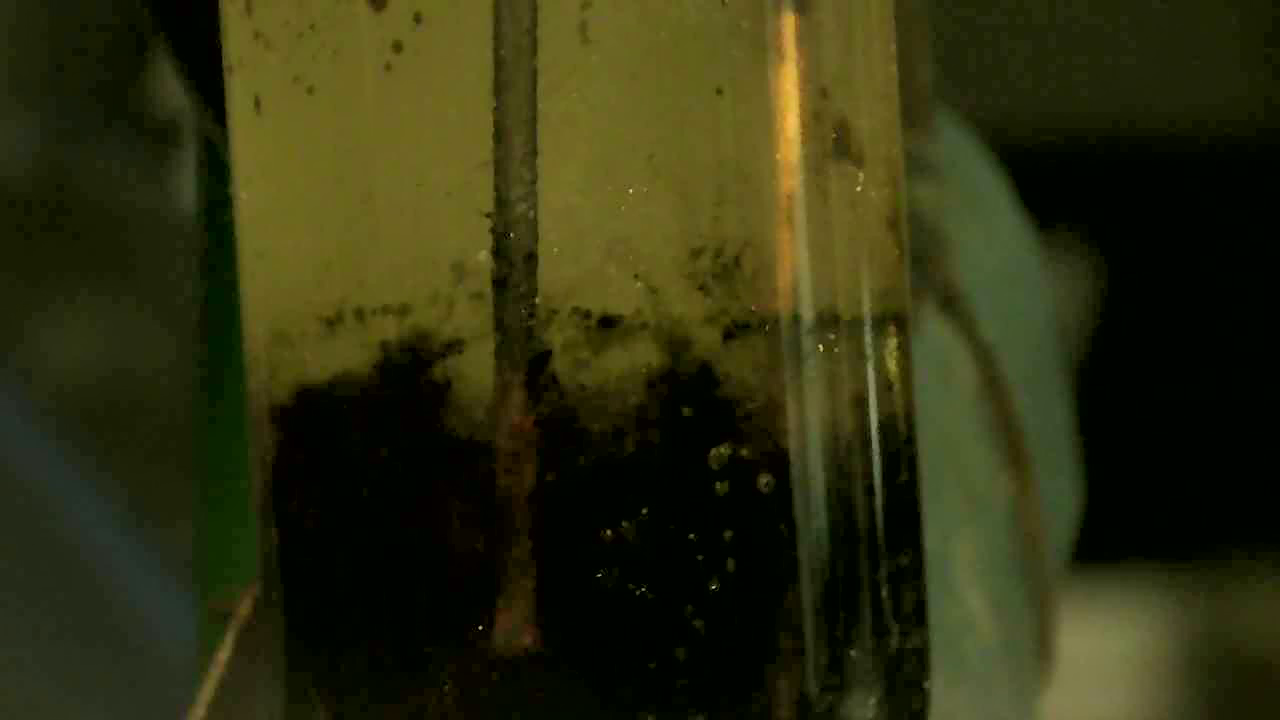

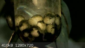

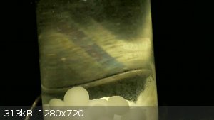

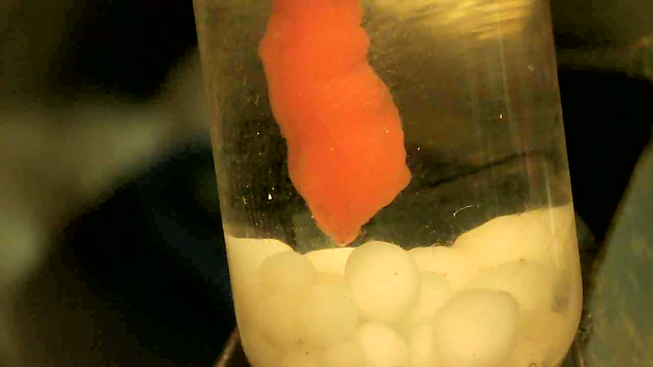

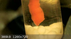

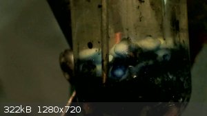

I have a lot of things to report. I took a bunch of pictures, and can post images for whatever is of interest; but I'd rather not post 100 shots of nothing... ;)
I put kerosene on top; and heated the kerosene rather than the urea. This caused a slow melting process of the urea and gave me good control. There was significant gas coming off the urea as it turned blue. It did not foam, at all, in my experiment.
It just released gas, some of which I think was steam.
vlcsnap-2024-07-06-12h32m04s699.png - 410kB
Conductivity rose before the urea had melted. I used a copper anode and a graphite cathode. It rapidly rose in conductivity as it started to melt, in fact it was too conductive. I had to put a resistor limiter in to reduce the electric heating. I've already got a 30W soldering iron touching the test tube from behind (the philips screw on it is just visible in the picture. ) This is enough heat.
Overcurrent, like I had, creates side products. I'm not sure how much it might have affected the rest of the experiment.
It's pretty obvious that the copper is extremely reactive with urea. And from the odor, I think copper oxide encourages transformation of urea into ammonia when water is present. The slight ammonia odor went away as the reaction progressed.
For my next attempt, I won't bother to oxidize the copper; because I'd like to test if urea is reactive enough to decompose carbonate; and if the ammonia smell will be avoided.
A couple of times, I got it too hot; but quickly reduced temperature. If significant gas came off the anode, I would cool it.
As the urea finally melted, I could see a thin layer of copper form on the graphite electrode. It re-dissoved shortly thereafter. The color reminds me of ammonia-copper etching color, sort of off-color salmon pink/brown. Once the urea was finally melted, I removed the graphite electrode; cleaned it, and replaced it in the liquid to make sure there was nothing on the electrode interfering with plating.
No furthur plating after returning it to service for two hours. The current level was easily adjustable from 3mA to 45mA, and gas in proportion to the current was forming at the electrode.
The color was so dark blue that it was difficult to see the electrodes. So I added about another 1/2 CC of urea prills on top. I watched the blue liquid wick up onto them as they melted. It's quite obvious that the melting point of the blue liquid was *much* lower than that of the urea prills. And it's also obvious that adding extra urea was raising the melting point of the whole mixture (not desirable.)
The liquid slowly darkened again, and I thought I had added too much heat. Since the tube was messy, I decided to change the kerosine and the test tube. After letting it solidify, I decanted; broke up the solid urea and transferred it to a clean test tube. I could see the solid chunks were slightly greenish in color, except for where the air could reach it, where it became pure blue again.
This makes me suspect that the blue color is actually a hydrated ammonia ion / ligand. But: Under kerosene, (hypothesis), the mass turns green slowly as it drys; and it's melting termperature rises, cauing solidification.
After quite a while, it would no longer melt. I raised the heat, and am not sure if I caused decomposition or not. But, it still conducts electricity even when semi-solid. It is not until the temperature becomes almost room temperature that conductivity stops.
At this point, I decided to add an ester that is liquid. I was hoping it would lower the melting point of the mixture. It did; although most of the mass remained solid. However, after about an hour and a half I could see the ester starting to brown; which means the heat was well above the melting point of normal urea.
On the other hand, in the presence of ester; copper began plating on the electrode.
It's dingy, not bright; but it still was plating out; This is at 2 [mA] current.
Shall we try again?
Suggestions / questions ?
vlcsnap-2024-07-06-15h01m01s539.png - 322kB
vlcsnap-2024-07-06-17h37m42s073.png - 288kB
[Edited on 7-7-2024 by semiconductive]
This makes me suspect that the blue color is actually a hydrated ammonia cation. Under kerosene, the mass turns green slowly; and it solidifies.
The green color may be due to the formation of a copper(ii)-urea complex (see, for example, Omar B. Ibrahim, Complexes of urea with Mn(II), Fe(III), Co(II), and Cu(II) metal ions).
Do you think it possible that the ester you added generated a copper salt that is soluble in urea and from which copper plates out more easily, while the organic anion reacts with the copper complexes in solution, repeating the process?
Shall we try again?
If you don't mind, by all means do so. It has been more interesting than I had initially suspected.
I've been thinking of trying copper(ii) acetate. I happen to be waiting for it to crystallise from a solution. The idea was to make large crystals but I can do that another day. If copper acetate dissolves in urea without decomposing it, it would be a better choice. Easier to make and purify, no need to roast it like coffee. The process would be essentially a Kolbe electrolysis with urea as solvent. There are some questions which I can't answer for now: (1) Kolbe electrolysis of acetate works by way of free methyl radicals. Will urea be methylated? (2) If urea is methylated, what will happen to the solution, and will copper be plated onto the electrode? Edit: I forgot that Kolbe electrolysis is usually done with alkaline cations. I don't think it proceeds with copper as cation, hence no methylation of urea and both questions are answered. Oh, well.
Only one suggestion. Try paraffin wax in place of kerosene. Apart from being non volatile and less inflammable than kerosene, you can pre-mix copper oxide with it and the reaction rate with urea in the molten state slows down considerably. It will need some stirring/shaking, that's the downside.
In the presence of water, I have observed esters breaking down into their constituents whenever acid or strong base is present. But, I didn't add any ester until after the solution had become nearly solid and green under kerosene.
On the other hand, I think there are too many steps and possible side reaction variables for me to really guess whether it could or could not. I'll need to do additional tests to figure that out.
The ester I used this time was citrate based, because citric acid is resistant to oxidation. I don't have enough experience to know for sure whether it would react since this is my first attempt at copper; BUT: It generally *doesn't* react with nickel ions present.
I don't know how the ethanol I esterified it with could get displaced when the urea has already been cooking long enough to drive out any free water and is solidifying even at high tempertature ?
I didn't see bubbling when adding the ester; so I don't think significant ethanol was released as it was hot enough to boil. eg: Adding an ester did not make a visible reaction before electrodes were re-inserted. The picutres are bubble free.
If it did react with electrodes, the obvious product would be copper citrate dissolved in molten urea. I could make copper citrate either in water, or perhaps (to avoid water) in methanol, DMSO, etc. ( Or suggest something simple! ) I have the citric acid; would that answer the question?

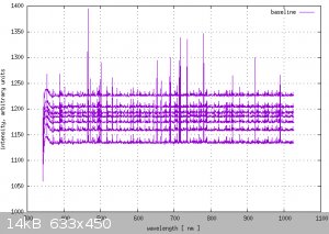

I'm winning the battle. I got a background noise fingerprint.
My Jaz spectrometer sensor looks like this in the dark, with thermal drift happening over 8 hours.
JazDark.png - 14kB
Each line is 4096 samples, at 1 second apart; so roughly an hour's worth of data.
The noise is fairly repeatable, like a fingerprint, but I see a few of the sensor noise peak's change visibly in the plot ... which is not good.
I'll probably let this run for another 24 hours, use the data to see if any of my pixels are problems; Then see about writing a filter program to reduce errors by injecting anti-correlated noise.
After that, I just need to calibrate the intensity scale against the built in Tungsten lamp. eg: It's time to look up blackbody radiation curves ... and refresh my memory. Power per frequency, not power frequency is what I recall the formula being; so I need to figure out how to convert power density into total energy at a wavelength.

I bought some TPLink™ KASA™ plugs, since those are on the market and can be controlled by a Raspberry PI™ using python; therefore qualified people with safety equipment can duplicate what I've done. This is just for educational purposes, only and I'm not recommending it. The KASA plugs use reed-relays, which means they will wear out; But, it's good enough for running a soldering iron. I'll report any failures if they occur and lifespan.
This is a picture of urea under kerosene with the soldering iron in the background.
vlcsnap-2024-07-25-09h33m25s399.png - 313kB
There is about 3cc's of kerosene in the test tube, and I have metallic shielding in case of fire as I don't trust KASA yet to run un-attended. There is roughly 1/2cc's worth of Urea Prills in the tube with a 30W soldering iron behind it. This is wired solidly to a chemistry clamp stand.
My multimeter says the tube is at 132.1 [ °C ], with the KASA program pulse width modulating the iron at 72% of full power via 1.5 second long pulses. The tube's been heating all afternoon and stays within ±1 [ °C ] stably.
Notice: no prills are melted, yet. I expect the Urea is now quite dry, with excess moisture driven off.
At room temperature, my ohm meter's thermal probe registered 3 degrees celsius higher than the wall thermostat does. So, it's possible the temperatures I report might need adjusting downward by up to 3 [ °C ]. I haven't calibrated the probe more precisely than that.
The wall barometer, shows 29.85 inches of water at my elevation. But, kerosine at these temperatures is not very volatile and will remain in the test tube for several days without issue.
A quick web search shows the lowest listed melting point of Urea as, 132.7 [ °C ]
I don't know how accurate that is.
https://www.accessscience.com/content/article/a722900
I will continue to raise the temperature this afternoon at 1 degree C every two hours, and report what temperature the urea prills start to melt at. I'll be checking for decomposition smells, and stability of the liquid also.
No odors, yet, except for slight oily feel of warm kerosene.
The following program is what I'm using; and if it gets interrupted during an on cycle -- it can cause problems by leaving the switch permanently on.
Fix it, or use at your own risk.
https://pypi.org/project/python-kasa/#description
Code:
#!/bin/env python # Script to run KASA heating plug # This is a gnu public license, 3.0, hack. # Andrew Robinson of Scappoose, July 2024. # https://www.gnu.org/licenses/gpl-3.0.en.html import time import asyncio from kasa import Discover async def main(): count=0 devices=await Discover.discover() for dev in devices.values(): await dev.update() power, maxpower = 0.50, 0.80 while (dev.alias == "heat"): # Power increase rate: # .00015 roughly one percent per hour at 50% # .0015 roughly ten percent per hour at 50% # .0045 roughly twenty five percent per hour hour at 50% # Rates will slow at higher powers, purposely # this allow rapid warm ups but slower sweeps of hot temperatures. power+=.00001 if (power>maxpower): power=maxpower s=1.5+20*power**3 print("\r Heat Power %8.5f "%power,end="") await dev.turn_on() await dev.update() time.sleep( s ) if (power<1.0): await dev.turn_off() await dev.update() time.sleep( s*(1/power-1) ) if __name__ == "__main__": asyncio.run( main() )
[Edited on 26-7-2024 by semiconductive]
Good morning.
I'm not sure what to say ... the repeat experiment did NOT go as planned.
The Urea, unadulterated, did not melt under Kerosene.
The prills are still quite visible. Although the Urea does appear to have partially dissolved into the Kerosene; and re-crystallized after cooling.
vlcsnap-2024-07-26-08h06m21s774.png - 263kB
I've ordered two more Owon BT41 meters, to double check the thermocouples.
It sort of looks like a design flaw in the meter; but since this is one of the few meters that actually works with Linux and windows, both, over bluetooth,
I'd really like to be able to use it with my Raspberry PI.
I also notice that it registers 0 degrees celsius about once in 100 readings; so the meter's sampling algorithm is flawed, too. ( Something I can write software to detect and reject, though. )
I've got a difference between the two meters that I have of about 6 degrees celsius. It's consistent. They're really inaccurate. I'm not sure what the temperature actually were, though, during the experiment. Argh!
I had an enclosed K type thermocouple in a steel sleeve for a different meter, and plugged it into the Owon only to get readings which were much worse.
I'm dipping one of the thermocouples into silicone, to see if I can at least make a temporary shield for it. But, this is not a really good idea, because silicone is chemically reactive.
I need to either figure out how to make a teflon sleeve, or get my inert gas setup finished so I can make a true glass sleeve. Stainless steel thermometers aren't really a good idea. Setbacks ...

I calibrated one Owon thermometer after dipping it in orange sensor-safe silicone from permatex.℠. It reads 5 degrees C high; but this is consistent at all temperatures so I wrote a program to adjust the temperature.
Reheating, again, using power+=.0009 # 5% in 10 minutes, 40% in an hour @ 19% start.
The thermocouple is at the front of the tube, where it should be coolest.
Most of the test tube de-fogged by 30 [°C]. But: The dust around the prills did not evaporate until about 108 [°C]. Picture is 110 [°C]. The prills are not melting.
vlcsnap-2024-07-26-14h27m26s965.png - 373kB
130 [ °C ] @ 72.9% of 30W power.
131 [ °C ] @ 73.3% ...
132 [ °C ] @ 74.0% ...
133 [ °C ] @ 74.6% ...
vlcsnap-2024-07-26-15h04m12s638.png - 387kB
134 [ °C ] @ 75.0% ...
vlcsnap-2024-07-26-15h05m41s402.png - 389kB
135 [ °C ] @ 75.8% ...
vlcsnap-2024-07-26-15h07m23s324.png - 387kB
137 [ °C ] @ 77.3% ...
vlcsnap-2024-07-26-15h11m01s675.png - 387kB
139 [ °C ] @ 78.6% ...
vlcsnap-2024-07-26-15h14m25s102.png - 388kB
141 [ °C ] @ %80.0 ...
vlcsnap-2024-07-26-15h18m34s874.png - 387kB
143 [ °C ] @ %81.3 ...
144 [ °C ] @ %82.0 ...
145 [ °C ] @ %83.0 ...
146 [ °C ] @ %83.8 ...
147 [ °C ] @ %85.4 ...
vlcsnap-2024-07-26-15h34m11s961.png - 392kB
148 [ °C ] @ %87.2 ...
149 [ °C ] @ %88.0 ...
150 [ °C ] @ %88.75 ...
vlcsnap-2024-07-26-15h44m29s589.png - 399kB
I don't get it.
This is hot. Burns my finger, hot. Not even the tops of the urea prills have melted.
Does driving off water slowly before melting raise the melting point???
151 [ °C ] @ 89.5%
152 [ °C ] @ 90.5%
153 [ °C ] @ 91.3%
154 [ °C ] @ 92.2%
155 [ °C ] @ 93.2%
I give up (for today). Stumper.
The silicone part that was submerged in hot kerosene, softened. Silicone's weakness is gasoline; and Kerosene is not far from it. But, the silicone dip survived intact; it's good enough, I can use silicone for a while.
( AND YES, those really are different pictures taken a few minutes apart. )
