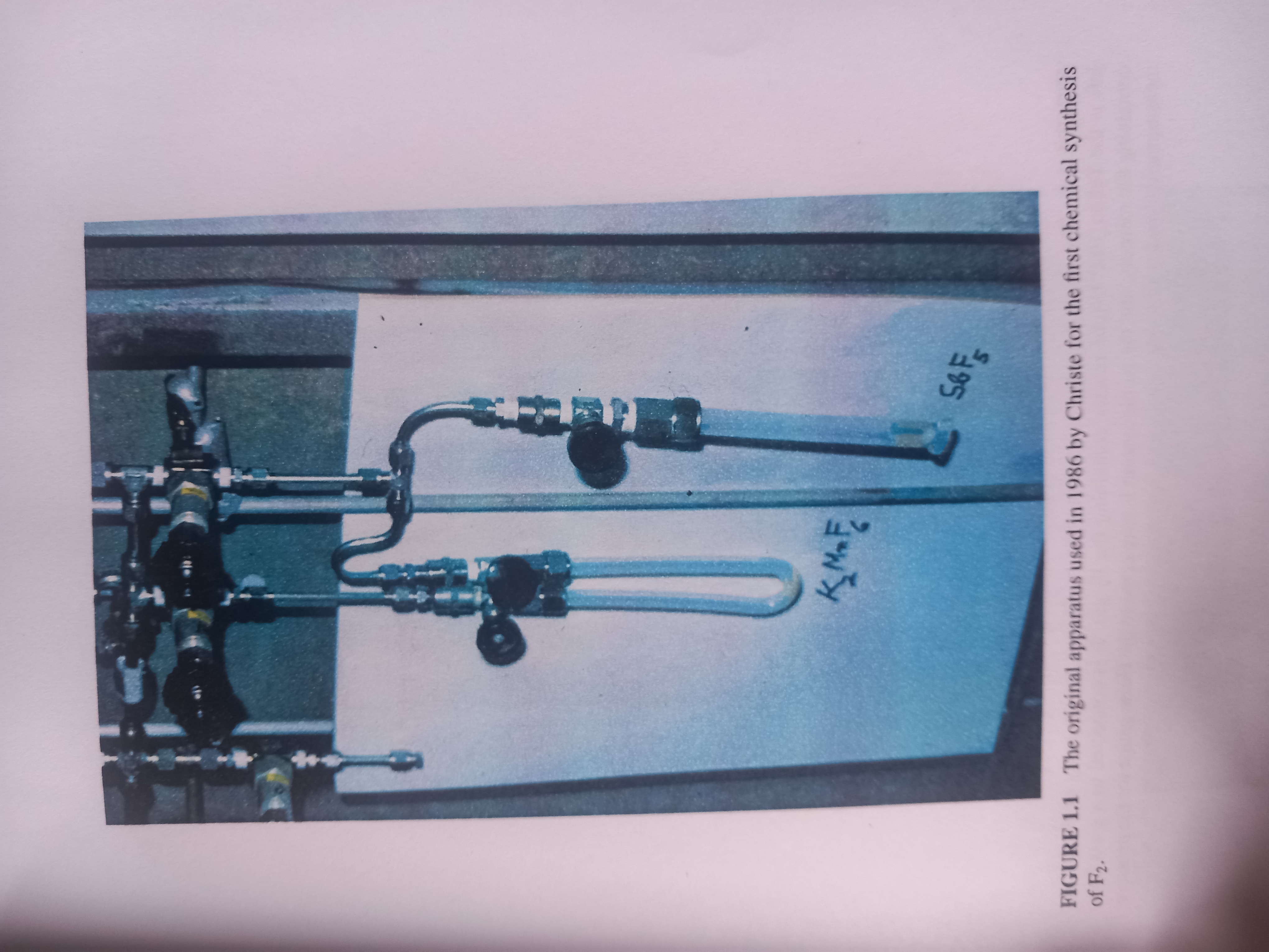

Only very recently, a synthetic method was found, in which fluorine can be made without electrolysis of anhydrous HF or molten fluoride salts, and without using chemicals, which were made with the help of elemental fluorine. This synthesis, however, is not a main route for preparing fluorine, it is a lab curiousity and is of academic interest, but does not have practical industrial applications. It involves a manganese (IV) intermediate in concentrated HF and SbF5. Not something for the average home chemist.
While it's very hard to make fluorine without electrolysis, there was a recent paper about making AgF2 directly through electrolysis without proceeding via elemental F2:
https://chemistry-europe.onlinelibrary.wiley.com/doi/abs/10....
This would allow some fluorination chemistry -- and it could be slowly decomposed at 700 C to produce F2 in situ by using e.g. a Fresnel lens or a high-powered laser.

teodor
Posts: 1142
Registered: 28-6-2019
[*] posted on 15-4-2025 at 06:35
Quote: Originally posted by imidazole
I vaguely remember KMnO4 reacts with HF to make an unstable Mn compound that releases F2, but I don't see any mention of that here
Correction: I needed to read more
[Edited on 15-4-2025 by imidazole]
It was mentioned here but no details of the method was given, only the formulas.
The publication of the method with photos of original apparatus I found in the book "Efficient Preparation of Fluorine Compounds" (ed. H. W. Roesky). Probably I can repfoduce here two pictures to give the idea of the equipment required.
17447277337182404758016861469505.jpg - 3.1MB17447277016572565903247186459707.jpg - 2.8MB
