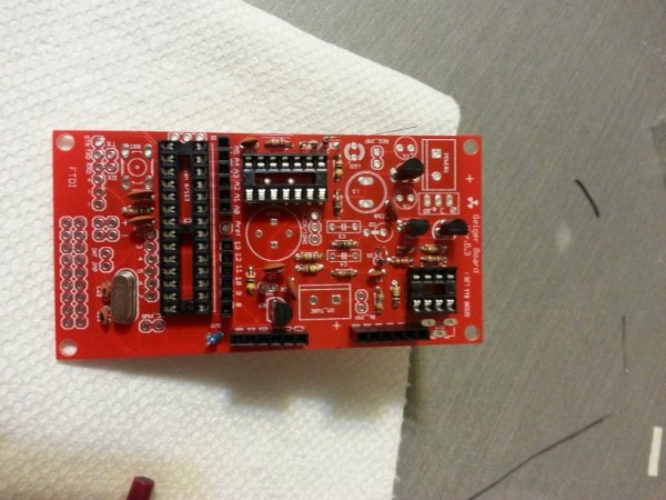

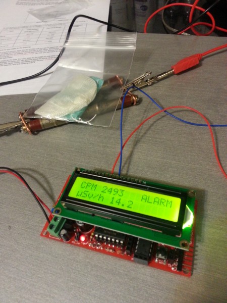

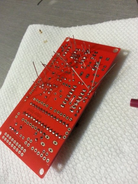

Just finished a geiger kit
I recently purchased another type of Geiger kit through trough the DIYgeigercounter site. I had compared it to the MightyOhm kit and decided to go with the DIYgeiger counter as it was virtually the same price and seems to have a little more flexibility in tubes to drive and accessories to use with it; but mostly just because it looked more challenging to solder :) .
After completing the kit, it works fantastically, and I hope to be able to find some samples of uranium ore for my periodic table display from a local abandoned copper/silver/lead mine. I am going to be running two SBM-20 tubes in parallel for enhanced sensitivity, although I would love to get a pancake type tube.
Here are some pictures of the build:
And here is a shot of it up and running with the two SBM-20's in parallel. The source is a thorium lantern mantle I got off eBay for a few bucks.

Very nice. I've been thinking about trying one of those kits. I'm curious, though; with the additional SBM-20, have you adjusted the dose rate calculation accordingly?
I haven't yet adjusted the dose rate to compensate for running the two tubes in parallel. I'm not really all that concerned as I'm really just going to be using the counter to hopefully find some samples of ore for my element collection. In the future if I do any logging or that sort of thing, I will adjust the code to compensate for it.
I really want to get one of the GPS modules, and log the average counts according to location, as I live somewhat near an active nuclear power plant. Of course I wouldn't expect to see any above average values near the plant, as its never had an incident, but it would be neat to try just out of curiosity. The site has a good writeup of it here: https://sites.google.com/site/diygeigercounter/daughterboard... It would be be a neat experiment, just no extra funds to do it!
