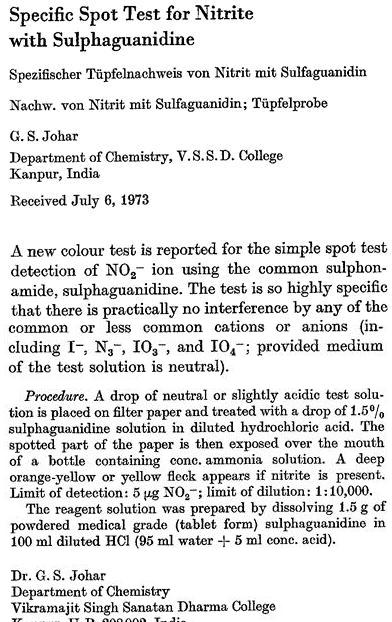

Another test (attached picture) from link below:
http://www.springerlink.com/content/p425v73427852116/
Test strip below:
http://www.sigmaaldrich.com/catalog/ProductDetail.do?D7=0&am...
