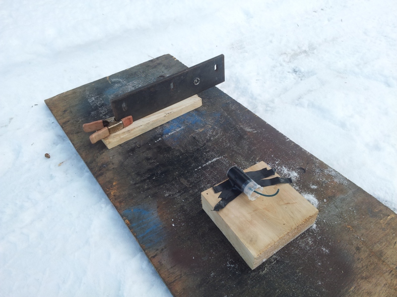

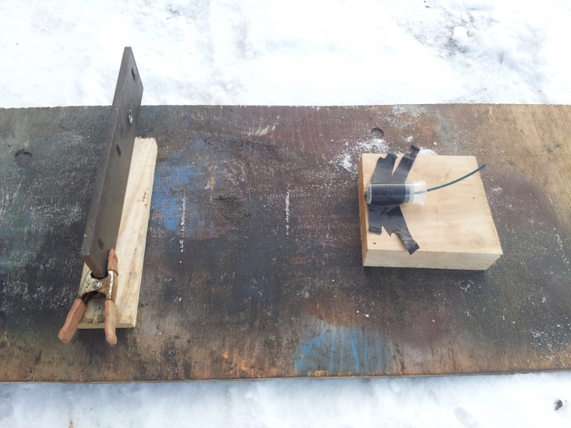

22.3mm Diameter Liner EFP Experiment
A Canadian quarter was used this time. A ball peen hammer, vise and an appropriately sized nut were used again to form the curved dish.
EFP Liner Specifics:
Diameter: 22.3mm
Depth: ~4mm
Thickness: 1.58mm
Mass: 4.4g
Composition of coin/liner (according to Wikipedia):
94% steel
3.8% Cu
2.2% Ni plating
Stand-off:
30cm
Explosive Used:
14.2g of 80% ETN Plastic Explosive
80% ETN / 10% Polybutene / 10% Paraffinic mineral oil
Initiation:
7.6mm aluminum casing
0.8g PETN
0.3g lead azide
bit of basic lead picrate flash igniter
Core burning safety fuse
Casing:
~0.5mm thick side wall polypropylene pill bottle
Backing Plate:
~15mm thick disc/slice of softwood broom handle
Target:
3/8 inch (~9.5mm) mild steel plate
Penetration:
>8mm
The slug did not go completely through, but it came very close. If the explosive had been 90-95% ETN instead of 80%, or if there had been stronger confinement and a stronger/denser backing plate, the slug would likely have easily penetrated the 3/8" target. More standoff might have resulted in complete penetration, but then the hole would have been smaller in diameter as well. Using a copper liner would have resulted in a certain increase in performance as well.
The 80% ETN plastic explosive was used because it has very desirable handling properties, and although not an optimized explosive for shaped charge applications it is a good general purpose explosive.
The curve of the liner was not perfectly symmetrical (because the press wasn't lined up right during pressing), the liner was not perfectly centered in the casing and the blasting cap was not centered properly, all because of being in a rush. The charge performed reasonably well, but it is obvious that for best results things should be as symmetrical and well centered as possible.
Here are a few pictures and also a few stills from a video taken of the blast:
Pre-blast set-up
Set-up 1.jpg - 243kB Set-up 2.jpg - 241kB Set-up 3.jpg - 211kB
Stills
BLAST 1.jpg - 337kB BLAST 2.jpg - 359kB
BLAST 3.jpg - 348kB BLAST 4.jpg - 347kB

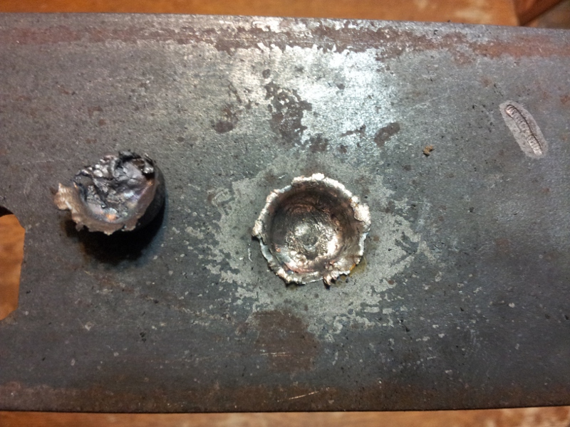

Results: (the slug was easily remove with fingers from the target)
Slug.jpg - 275kB Hole.jpg - 216kB Lump.jpg - 151kB

Anyway, I took a depth gauge and more carefully measured the penetration depth this morning and when excluding the bulged up steel around the periphery of the hole penetration is about 7.2mm not 8mm. The diameter is however ca. 16mm. Assuming a perfectly cylindrical hole, the volume can be calculated as follows:
V = pi/4 * D^2 * depth
V = 3.14159/4 * (1.6cm)^2 * 0.72cm
V = 1.45cm^3
The volume is quite high and if desired a lot more penetration could be obtained by creating a slug that was smaller in diameter and had more length. At the small scales of our tests, the ease of slug formation and performance increase that comes from using a copper liner over a steel liner could very well be even more significant than it is with larger EFPs.
Attached below are a few pictures of the slug. The slug has an uneven distribution of mass which is characteristic of when there is asymmetry in the liner and/or charge or uneven confinement, etc.
Mass of unaltered quarter: 4.50g (Wiki gave 4.4g, which is the value quoted above)
Mass of recovered slug: 3.85g (0.65g of material is missing)
1.jpg - 277kB 2.jpg - 123kB 3.jpg - 121kB 4.jpg - 120kB 5.jpg - 118kB

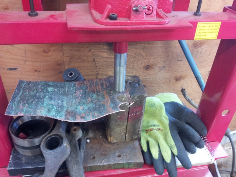

Made a few copper liners today. A 3lb piece of scrap copper pipe, 3 inch diameter, 1-1.2mm wall thickness was used as the source of copper. A hydraulic press and homemade cutter/punch were used to cut out copper discs and then they were formed by pressing between a ball peen hammer and steel nut the same way the coins were shaped. Some dies for pressing should be made, something like LL did, to ensure consistent symmetrical liners (I may make a set soon). I am going to do a test the same as the last test except that a copper liner will be used. The thickness of the copper liners is also a bit less which is likely a good thing.
Pressing out Copper Discs.jpg - 258kB Copper EFP Liners.jpg - 195kB
