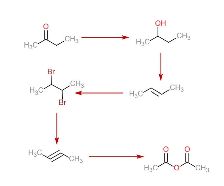

Could there conceivably be a route to 2-butyne from 2-butanone? In the interest of OTCness.
Triflic Acid
Posts: 486
Registered: 27-9-2020
Exactly how would the 1-phenylpropyne work? A rnx diagram would be helpful. I came up with an idea to make the 2-butyne. Starting with methyl ethyl
ketone, its reduced to 2-butanol. After that, thats dehydrated to 2-butene. This reacts with bromine to make 2,3-dibromobutane. Reaction with Na in
anhydrous liquid NH3 to give 2-butyne. That reacts with ozone to make acetic anhydride. Any problems with this? Also, can I get 2-butanol without
needing to do an expensive NaBH4 reduction?
Posts: 2927
You actually need to do the double dehydrohalogenation in two steps because otherwise you'll probably get a diamine when the 2,3-dibromobutane
immediately reacts with the NH3 solvent. First remove one bromine with pyridine, then the other with NaNH2. But the other problem is that the
preferred product is the allene, IIRC.
