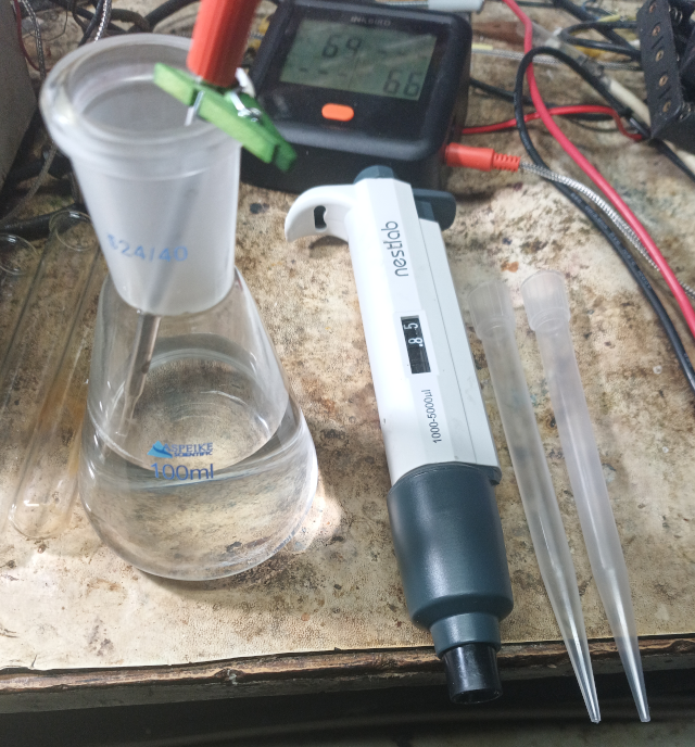

So, Let's see what I can do with density. I have bought a NEST lab pipette that transfers by using suction into a plastic tube. This isn't a highly accurate (or expensive) device, but I'm hoping it will last more than five uses which is all the disposable ones seem to handle before the plastic cracks.
I have a 1.000 to 5.000 [cm³] NEST device, and I bought two of them. If I can accurately measure 1 [cm³] of glycerol, then I might be able to figure out how much water there is from the mass.
Let's test with water first, which is more troublesome (vapor pressure is higher).
I'll set the NEST device to 1.000 [cm³]. Put 100 [mL] of reverse osmosis water in an Erlenmeyer in the microwave, and bring it to boiling.
Now I'll transfer water five times, into a weighed and tared test-tube.
!That didn't go well!
The erlenmeyer cooled down to 40 [°C] before the pipette was ready and assembled to use. I got between four and 5 samples before the water changed by two degrees [°C].
I had to learn not to push the button all the way down, but only to the point where it meets spring resistance. Otherwise it jams.
Note: The temperature recorded is the start temperature of the sampling:
Code:
T= 40.1 [°C] x̅= 1.186 σ= 0.044 [g] μ₀= 1.190 σ₀= 0.045 [g] 3.741% T= 34.9 [°C] x̅= 1.183 σ= 0.016 [g] μ₀= 1.185 σ₀= 0.016 [g] 1.346% T= 30.1 [°C] x̅= 1.176 σ= 0.012 [g] μ₀= 1.178 σ₀= 0.012 [g] 1.032% T= 25.1 [°C] x̅= 1.162 σ= 0.015 [g] μ₀= 1.164 σ₀= 0.015 [g] 1.326%
I got too much water each time and lots of variance. I'm not very consistent/steady at pipetting.

If my Reverse osmosis water filter is expired, then I get some calcium through it in addition to CO₂ gas forming carbonic acid. But I expect briefly boiling would precipitate any calcium out -- so I think the water's volume vs. NIST specifications ought to be correct because I brought the water to a boil before hand.
If this pipette really is backward, then I suppose I could put pieces of nylon inside the pipette tip until I reduce the volume just enough that air expansion and temperature cancel out.
I can also put nylon washers under the depressor to stop it in the spring area at a repeatable spot. The only annoying weakness of this device is that the volume is set by spinning the depressor. It's not stiff enough to prevent me from accidentally changing it's volume setting when trying to rapidly use it.

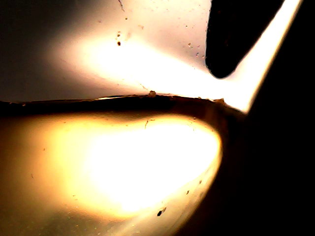

In order to get the PP-ol to discolor at all, I had to add some calcium chloride (anhydrous). That made the PP-ol turbid and a very slightly yellow. Then I added sodium-metabisulfite, and it floated on the surface (see picture) and caused gas bubbling. But it also made the slight yellow color begin to fade.
vlcsnap-2026-01-30-19h18m00s559.png - 307kB
I'm waiting to see if the bisulfite ever dissolves or not.
But, there's was never any odor.
Very curious.
Edit: The bisulfate began to dissolve, slowly, but as it did the 1,2,3-PPol turned black rapidly (less than 2 hours to totally opaque) and began to have strong odors. Duda™ energy, 1,2,3-PPol is advertised as 99.7+ pure. Mine has been opened for over a year, so I estimate it's still 98%+ still pure.

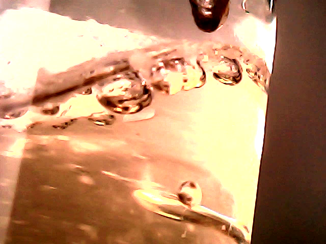

Redoing the experiment, 600 [mg] PP-ol, 2 [g] kerosene, unfortunately a couple of air bubbles got lodged in the PP-ol. I'll let it run anyway, and see at what temperature the bubbles dislodge.
The air bubbles never dislodged. They absorbed when the bottom of the test tube was at around 175 [°C]. This caused the PP-ol to golden-yellow slightly. I'm watching it to see if it will darken.
This photo is slightly misleading, because the camera is aimed along the refraction line. There isn't actually a dark band of material between the kerosene and the PP-ol. The color, to the eye, is golden yellow but not quite as dark as it shows in the photo.
vlcsnap-2026-01-31-16h58m31s915.png - 234kB

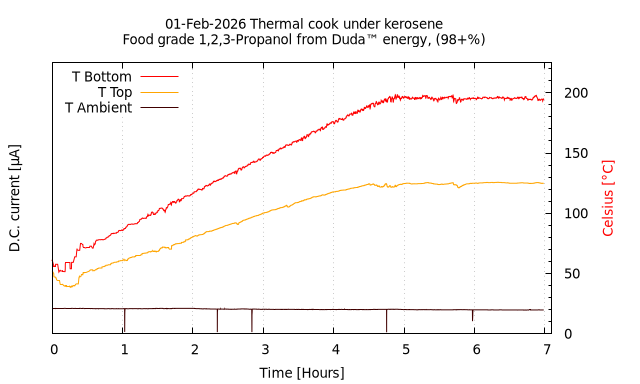

Note: The bottom of the test tube is holding steady at 195 [°C], while the kerosene just above the 1,2,3-PP-ol, is at about 125 [°C].
On this temperature graph, the air bubbles shrank between hours 3 and 5. This is where the yellowing occurred and the index of refraction of the 1,2,3-PPol changed remarkably. The white you see in the picture is a piece of teflon plastic behind the test tube so I could see the color changes of the liquid.
pngsnap.png - 34kB
My 30 watt soldering iron can't get any hotter, so this is pretty much the best I can do for a test tube experiment. I'm not sure if I can get a tiny heating mantle that would fit a test tube bottom.
There are temperature spikes in the graph, which is a bug in the INKBIRD bluetooth thermometer system. I'm working on that in another thread.

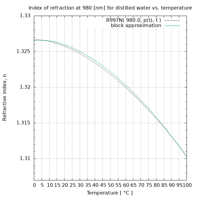

Refraction data for water over temperature, how I am proceeding -- what I am learning:
I contacted someone in Turkey about an article on water refraction. In my last correspondence, they mentioned that they thought I was something like a 'data' assassin and recommended that I do a high precision refraction measurement myself and 'publish it somewhere' -- rather than try to figure stuff out from other people's data. ( So I won't mention her name here. )
I am attempting to follow her advice.
Building a refractometer:
I have capillary glass tubes, and am able to construct a refractometer based on the original Lorenz design:
https://riviste.fupress.net/index.php/subs/article/download/...
Jamin mirrors for optical surveying are common, and I have some.
I also have found that I can stretch glass fiber by melting it and pulling it, which thins the fiber and jacket. The shape becomes somewhat like a catenary/hyperbolic bend. This leaks more light depending on the refractive index of the fluid that surrounds it. So, I might be able to use a partially melted fiber as a second way to check the Lorenz measurements.
I don't have temperature control totally automated yet with calibrated glass thermocouple probes. ( I really need my 3D printer to work already!!! )
Tentatively,however, my first attempts match with the Turkish fiber optic experiment's plotted data. (which I can only get by picking it off a graph, as she doesn't publish the numbers!).
Which is to say, that my earlier comment to her on the her equation's dis-agreement with NIST has nothing to do with her actual data.
Her raw data isn't bad. BUT -- her published curve fit equation, and her data, do not describe the same curve.

Unfortunately, a mouse broke my glass HCl jar (distilled, 40+% using a vigereaux and gas trap) and it predictably exploded into a cloud of gas -- ( but the mouse survived!!!) . So, I'll need to get muriatic at the hardware store and re-distill it, or use just use sulfuric acid.
Because my vacuum pipettes suck for accuracy ... I also bought glass borosilicate 3.3 TD 1 ml pipettes designed for 20 [°C]. It has 0.01 [cc] gradulations. I was going to buy some temperature regulators for my milligram scale, and see if I can get the precision of my scale to increase. These are the only tools beside reagant grade chemicals that I presently have to make measurements with that could possibly make accurate denisty measurements to figure out anything about dissolved gasses or ions.
I have an optical spectrometer, but I don't have a way to calibrate it yet.
I also have multiple thermometers, but they are only partially functional. ( I'm paying someone to fix it, but they are slow. )

This post is a derivation of an improved model for refraction index of a substance vs. density.
Relative dielectric constant of a substance is a value equal to the index of refraction (of that same substance) squared. It varies with frequency, but is constant at any specific frequency.
ε_r = n²
Which means that a Lorenz-Lorentz model OUGHT (but isn't) to be identical to a model where every molecule is an electronic capacitor having a constant dielectric constant inside and the space between molecules is a capacitor with the dielectric constant of empty space.
Unfortunately Lorenz and Lorentz, both made a simplifying assumption that is not rigorously correct in three dimensional volumes of liquids or gas. They used a polarization model with a single charge cavity and no corrections for series vs parallel dipole moments.
eg: This neglects the different series and parallel effects of molecules spread out in space. Capacitors do not add in only one way.
For an analytical solution that predicts the quality of the error made by Lorenz and Lorentz, I'm going to make a simple linear assumption. I am going to assume that molecules can be modeled linearly as a cubic shaped capacitor with two imaginary conducting plates oriented perpendicular to one arbitrary dimension of the space.
For water, then, the mass and volume of each water molecule 'capacitor' can be found from the maximum water density 3.98 [°C].
Note: At 980 [nm], 3.98 [°C], 1 [ atm ] the refractive index of water is computed as 1.3266 from IAPWS formula. This means the dielectric constant is ε_r = 1.3266² at 980 [nm].
If the total volume of water material is (1 [cm])³, but the total volume we measure the capacitance of is is (B [cm])³ , then the difference in volumes is empty space between and around the water molecules.
Note: It does not matter how many smaller molecular cubes the 1 [cm] cube of water is broken up into, because in electronic circuit theory, capacitors are linear circuit elements. The only things that *really* matter are the relative number of water molecules found longitudinally ( in series ) when passing through any given cube vs. transversely ( in parallel ). For this determines the number of series to parallel elements in a capacitor network.
But, this means I can compute the exact same (bulk) capacitance answer by imagining all water swept into a corner of the volume B³ and the rest left as empty space.
By definition, the density of the entire cube is still 1/B³ even though we've compressed the 1 [cc] of effectively 3.98 [°C] water into a single corner of the cube.
The capacitance of the entire cube can be computed from a network of cuboid shaped capacitors that contain one and only one kind of 'thing' each.
I break the entire cubic volume (B³) up into one cuboid capacitor formed of maximum density water, and three capacitors of different sizes that represent the remaining (empty) cuboid spaces around the water.
The nominal capacitance of a cuboid is defined as:
C = dielectric constant · area_of_face / length_between_faces
I can then describe the entire volume as four cuboid capacitors.
C₀ = ( ε₀ · ε_r ) · 1² [cm²] / 1 [cm] # Capacitor made only of water
C₁ = ε₀ · 1² [cm²] / (B-1) [cm] # Empty space in series with water
C₂ = ε₀ · (1·(B-1)) [cm²] / (B-1 [cm]) # Small space in parallel with water
C₂ = ε₀ · (B-1)·(B) [cm²] / (B [cm] ) # Larger space in parallel with water
I'm neglecting electric field fringing effects, and molecule shape effects, because the error is a fixed percentage based on geometry and this error usually cancels when converting a capacitor value back into a dielectric value. The capacitance values are crude, but the dielectric values ought to be quite accurate.
The total capacitance of the composite cube is:
C = 1/ ( 1/C₀ + 1/C₁ ) + C₂ + C₃
C = ε₀·( 1/( 1/ε_r + B - 1) + 1-1/B + B-1 )
Therefore, for the whole cube, the average dielectric constant is:
n² = ε_a = 1/( B² - B + B/ε_r) + 1 - 1/B²
eg: This is (theoretically) the "average" or "equivalent" dielectric value that light would encounter at a given density when moving through equally dispersed water molecules in a volume.
Here is a graph of IAPWS prediction for 980 [nm] light's index of refraction in freshly distilled water from freezing to boiling at 1 [atm]. I've also included a plot of what my lumped electronic circuit model predicts for the same color of light.
pngsnap.png - 14kB
Code:
#!/bin/env gnuplot # Compute an 'average' index of refraction for a 1 [cm³] volume of ε_k media # distributed in a vaucuum volume of B³, where refractivity is ε₀. # Written by Andrew Robinson of Scappoose, 2026 # Copyright 2026; Released under the GNU pubic license GPL3.0. # https://www.gnu.org/licenses/gpl-3.0.html # # 980 [nm], IAPWS calibration n_k = 1.3266 E_k = n_k**2 # Block model of how permittivity changes with molecule spacing E_B( B ) = 1/( B**2 - B + B/E_k ) + 1 - 1/B**2 n_d( d ) = E_B( (d/1000.)**-0.3333333333 )**0.5 # IAPWS -- characteristic equation # l is wavelength in nanometers # p is density in kg/m³ # T is temperature in kelvin R997(l,p,T)=(_a0+_a1*(p/p0)+_a2*(T/T0)+_a3*(l/l0)**2*(T/T0)+_a4/((l/l0)**2)+_a5/((l/l0)**2-Luv**2)+_a6/((l/l0)**2-Lir**2) + _a7*(p/p0)**2 )*(p/p0) _R997(x)=sqrt( (1+2*x)/(1-x) ) # Caution, this inputs temperature in Celsius and converts it to Kelvin. R997N(l,p,t)=_R997( R997(l,p,t+273.15) ) T=293.15; T0=273.15 l0=589.0 Lir=5.432937; Luv=0.229202 p=997.0 ; p0=1000.0 _a0=0.244257733 _a1=0.00974634476 _a2=-.00373234996 _a3=0.000268678472 _a4=0.00158920570 _a5=0.00245934259 _a6=0.900704920 _a7=-.0166626219 # IAPWS -- density equation for water 0-100C ( <0.02% error ) # https://chem-casts.com/knowledge/density-of-water p(T) = ( 999.83952 \ +16.945176*T \ -7.9870401e-3*T**2 \ -4.6170461e-5*T**3 \ -2.805425e-10*T**5 )/(1 + 1.6879851e-2*T) # set title "Index of refraction at 980 [nm] for freshly distilled water vs. temperature" set dummy t set grid set xlabel "Temperature [ °C ]" set xrange [ 0 : 100.0 ] set xtics 5 set yrange [1.307:1.330] set ytics auto set mytics 5 set ylabel "Refractive index, n" plot R997N( 980.0, p(t), t ) lw 3 lc 'grey', n_d( p(t) ) ti 'block dielectric'
What is important in this graph is not how accurate the IAPWS density vs temperature equation is, but the relative shape difference between the IAPWS curve and my own prediction of index of refraction based on density.
The IAPWS graph represents assumptions based on a Cauchy curve fit of the index of refraction data. My curve has a very similar shape but is slightly higher in value in general but crosses over near boiling.
Now:
Find a graph of experimental data for water at 980 [nm] using fiber optics, vs. a Cauchy curve fit in an article referenced in one of my earlier posts. (Esra K. and and S¸ Yaltkaya are authors, Indian Journal of Physics. ) Esra's actual fiber optic data at 980 [nm] tends to be above her Cauchy curve fit.... (Equation #5 in the article) and crosses over near boiling.
eg: The actual data compared to a Cauchy curve fit agrees (qualitatively) with the electronic correction model I just computed compared against a standard IAWPS curve fit.
[Edited on 20-2-2026 by semiconductive]

Avagadro's number was estimated by Lorenz (a dutch physicist) based on refraction inferences; but his approximation is a homogenous one plane calculation and has the correct exponent ·10¹⁹ but isn't even one figure accurate in the decimal places.
Yet, his equation is what IAPWS is using for calculating water density and states.
The equation I derived in the immediately preceeding post is a modern correction to the L-L refraction formula. But, the main difference is that it assumes a hetrogenous matrix of molecules such that light can move alternately through vacuum and through water either in parallel or series.
It is not a 'homogenous' single cavity approximation.
Anyplace around a water molecule that isn't 1 gram/cc of space density, must be modeled as a cavity of vacuum that the molecule is inside of.
In more modern theory, vander-walls computes a 'volume' or radius of distance between molecules that they 'will not approach' each other.

I know that cooking glycerol turns it a golden yellow when exposed to oxygen at temperatures above 155 [°C].
I don't have a way to calibrate my spectrometer for photon counts; but I certainly could compare the relative brightness of two color pixels after adding known volumes of oxygen to 1 gram of 1,2,3,PP-ol and cooking it. This would give me a way to correlate amount of oxygen exposure in the form of air bubbles absorbed by glycerol to color change.
That, at least, would allow me to objective test how much ultra-pure kerosene leaks oxygen vs. paraffin. (I have solid USP paraffin as well)
eg: I could watch how long it takes for glycerol to yellow underneath paraffin wax vs. lamplighters kerosene.
On rather curious point, ultra pure kerosene can be frustrating in that when the liquid below it has been boiled that it will suddenly begin mixing with the upper layers. It's as if the polar vs. non-polar idea stops working and the two liquids mix once boiled. Only density makes a difference as to which liquid floats and which one sinks.
But, I'm reasonably confident that it excludes oxygen better than most other organic liquids that I've tried. Hexane isn't one I've tried because it's listed as a mild neurotoxin.
