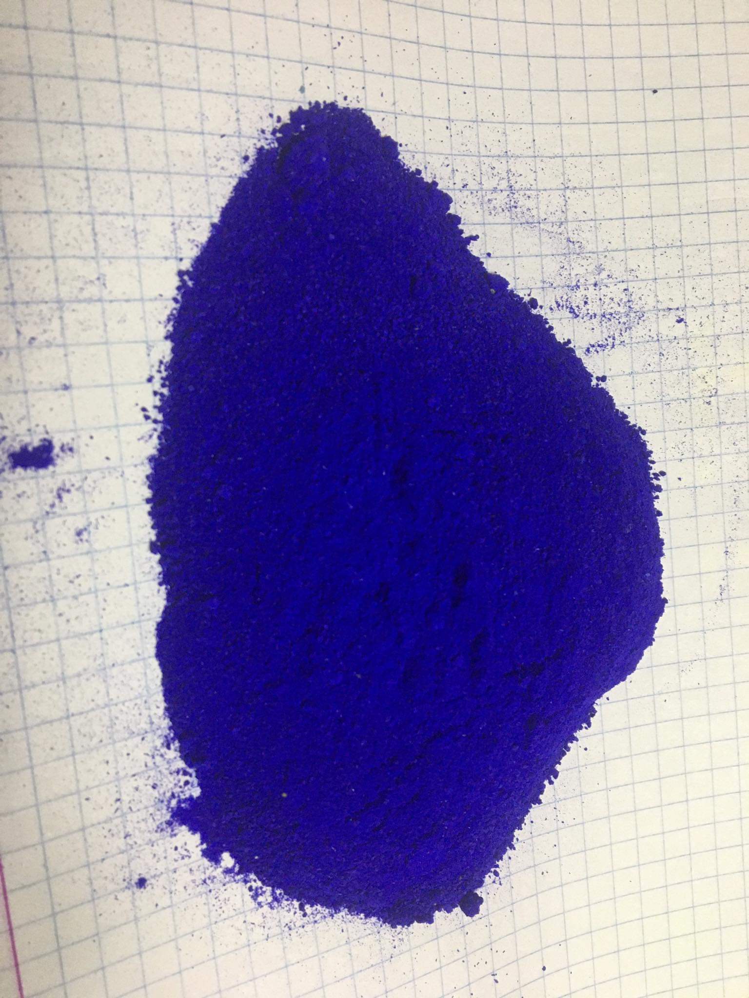

[*] posted on 11-12-2020 at 09:31
tetraamminecopper(ii) nitrate

[*] posted on 11-12-2020 at 09:55
Vano that's a really pretty copper salt.

[*] posted on 11-12-2020 at 11:35
Tetraamminecopper(ii) nitrate is energetic, correct? That seems like a lot of explosive material to make at once, no?
samarium14
Posts: 661
Registered: 22-3-2019
Location: Georgia
[*] posted on 11-12-2020 at 22:07
It isn't very energetic material like nickel hydrazine nitrate or perchlorate complexes. If you heat it will explode. But if you add a few grams of HMTD for every hundred grams then it will be quite explosive at room temperature.

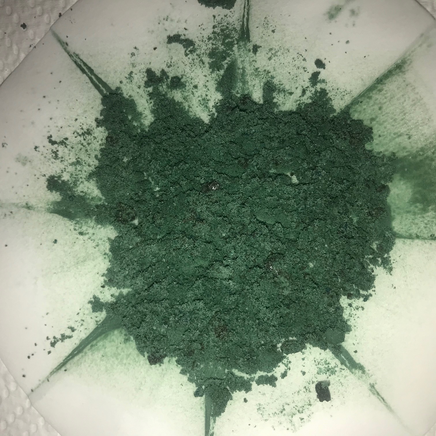

[*] posted on 25-12-2020 at 20:10
I tried to make copper gluconate C12H22CuO14 by double displacement reaction between calcium gluconate and copper sulphate. Calcium sulphate ppt out and after filtering the solution was first reduced in volume by slow boiling and then left out in a dish to dry.
After some 2 weeks a wet sticky blue-green substance was left. I tried to dry this in the sun a few days but it stayed sticky. It was then placed on a steam bath for some 4 hours but it is still a very sticky glob - color now dark olive green. See photo.
It does not seem hygroscopic. Any ideas how to get this to a dry powder state?

Posts: 4524
[*] posted on 25-12-2020 at 21:01
Triturate with alcohol?

[*] posted on 1-1-2021 at 02:03
DraconicAcid thanks for the suggestion!
Yesterday I stirred the blob of copper gluconate with about 100ml of very hot ethanol for some 30 minutes. This resulted in a green fine suspension with a few pea sized pieces. I filtered it off and got the below remainder.
IMG_0474.jpg - 697kB

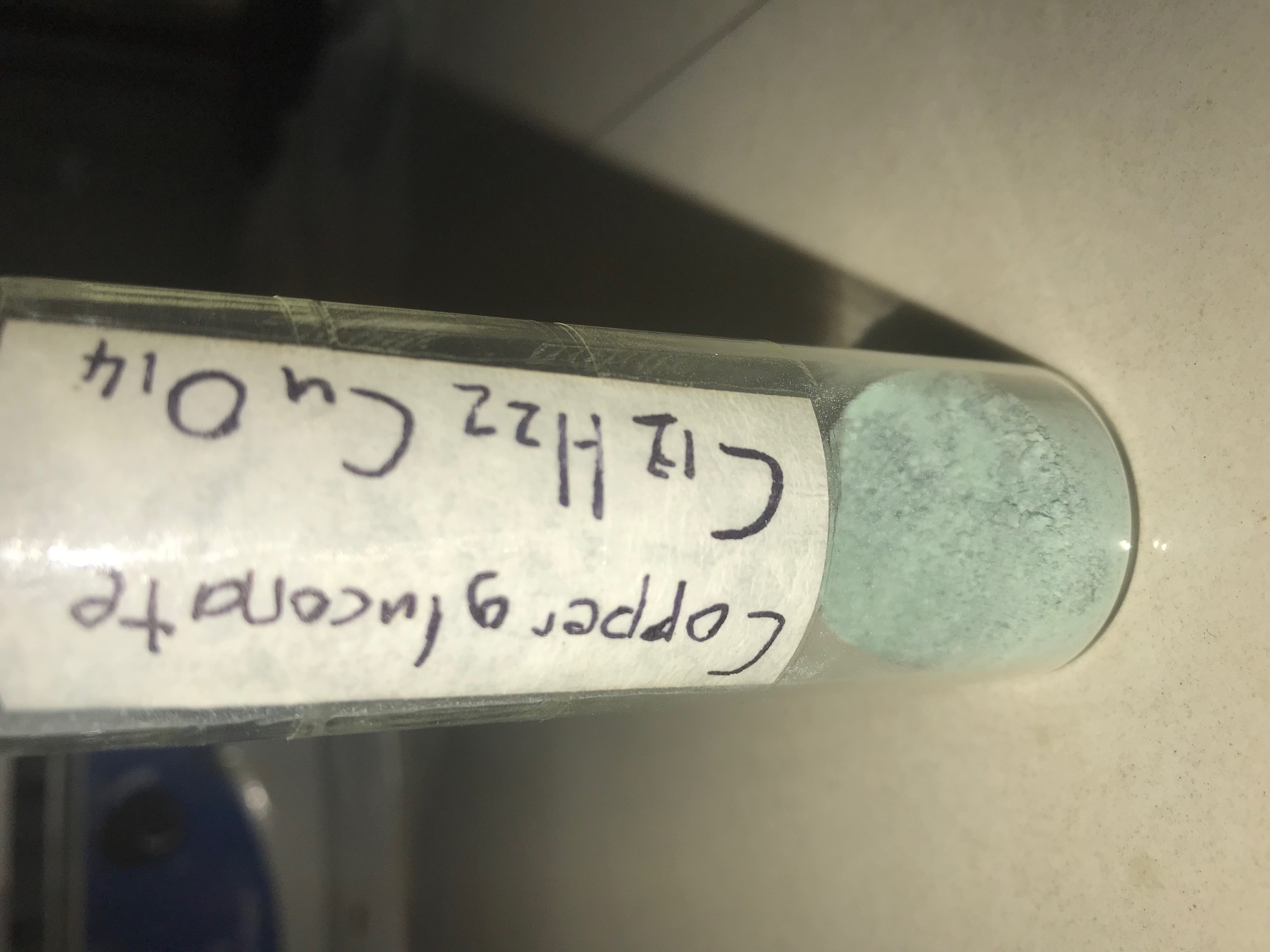

I left this to dry on the bench overnight but this morning it had gained 0.2g of weight and was starting to get sticky again. I then boiled and stirred it in methanol (I ran out of ethanol) for 40 minutes. This again broke it up but into a more coarse powder. I filtered it and the green remainder went onto a steam bath for some 15 minutes. It was then ground in a mortar and the final result is the below dry free-flowing pale green powder, which I presume to be copper gluconate.
Final.jpg - 396kB
