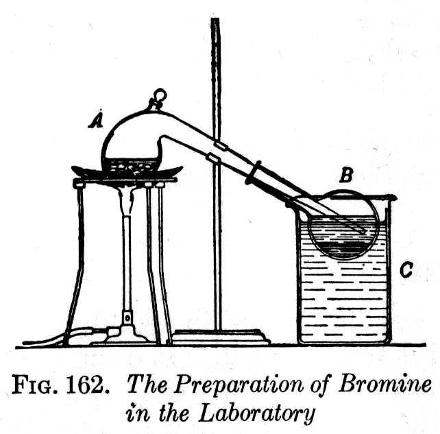

Picked up an old book yesterday at a thrift store. Feel like transcribing something. Enjoy:
<div align="center"><strong>CHAPTER 18<br />The Chlorine Family<br /><hr width="70" />BROMINE</strong></div>&nbsp;&nbsp;&nbsp;&nbsp;<strong>Preparation of bromine.</strong> The laboratory method and the industrial method for preparing bromine are as follows:<br />&nbsp;&nbsp;&nbsp;&nbsp;1. <strong><em>Laboratory method.</em></strong> Just as chlorine is set free by the oxidation of hydrochloric acid by manganese dioxide (p. 203), so bromine may be prepared by a similar reaction, substituting hydrobromic acid for hydrochloric : <table style="float: right"><tr><td>fig162_full.jpg - 122kB</td></tr></table><br /><br />4(H<sup>+</sup>, Br<sup>-</sup>;) + Mn<sup>++++</sup>, 2 O<sup>--</sup> &rarr; Mn<sup>++</sup>, 2 Br<sup>-</sup> + 2 H<sub>2</sub>O + Br<sub>2</sub> &uarr;<br /><br />Hydrobromic acid is unstable and on this account is not usually available in the laboratory ; so a mixture of sodium bromide and sulfuric acid is used instead. The equation for the complete reaction is like the one for chlorine (p. 203) :<br /><br />2(Na<sup>+</sup>, Br<sup>-</sup>;) + 2(2 H<sup>+</sup>, SO<sub>4</sub><sup>--</sup>;) + Mn<sup>++++</sup>, 2 O<sup>--</sup> &rarr; 2 Na<sup>+</sup>, SO<sub>4</sub><sup>--</sup> + Mn<sup>++</sup>, SO<sub>4</sub><sup>--</sup> + 2 H<sub>2</sub>O + Br<sub>2</sub> &uarr;<br /><br />&nbsp;&nbsp;&nbsp;&nbsp;<strong>Laboratory apparatus.</strong> The materials are placed in a retort, <em>A</em>, arranged as shown in Fig. 162. The delivery end of the retort dips slightly into the water in flask <em>B</em>, which is partly immersed in ice water (<em>C</em>;). As the contents of the retort are headed, bromine distills over and is collected in the cold receiver.<br /><br />&ndash; <em>Introduction to College Chemistry.</em> McPherson, Henderson, Fernelius, & Quill. Ginn and Company, 1942/46. (<a href="http://catalog.hathitrust.org/Record/009227908" target="_blank">Hathi Trust</a> <img src="../scipics/_ext.png" />;)
Perhaps a little easier to read:
<strong>4 HBr + MnO<sub>2</sub> &rarr; MnBr + 2 H<sub>2</sub>O + Br<sub>2</sub> &uarr;</strong>
<strong>2 NaBr + 2 H<sub>2</sub>SO<sub>4</sub> + MnO<sub>2</sub> &rarr; Na<sub>2</sub>SO<sub>4</sub> + MnSO<sub>4</sub> + 2 H<sub>2</sub>O + Br<sub>2</sub> &uarr;</strong>
