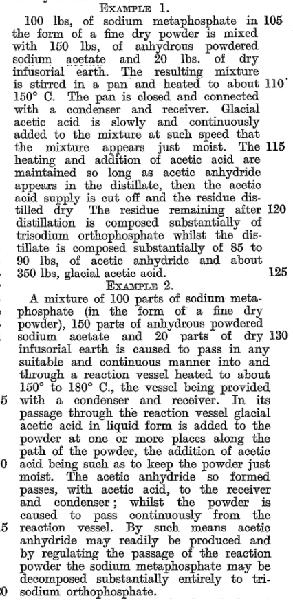

[*] posted on 27-1-2021 at 04:39
Or why someone didnt try NaPO3(Sodium Metaphosphate) with AcOH/AcONa according to GB299342
Where can I find a copy of this patent? Google is not showing anything.
non-US patents can be found on espacenet
https://worldwide.espacenet.com/
https://worldwide.espacenet.com/patent/search?q=GB299342
https://worldwide.espacenet.com/patent/search/family/0017418...
go to "original document"
The patents says to take the mixture of Ac2O and GAA and use it as solvent for a fresh NaPO3/NaOAc batch, increasing the yield of Ac2O recovered every time.
[Edited on 27-1-2021 by dicyanin]
acetic anhydride GB299342.png - 282kB
sic transit gloria mundi
