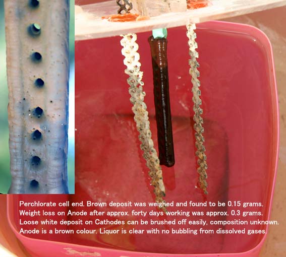

The Anode I have made (described above) seem to be holding up pretty well in perchlorate cells. There is little or no wear. They have been running now for about 40 days.
One of the Anodes is shown in picture. It was mostly used to scavange chlorate, ie. reduce the chlorate concentration of Perchlorate cells from about 20 grams per liter down to below one gram per liter. Chemical treatment of the liquor will be used to get rid of the last remaining remenents of Chlorate.
