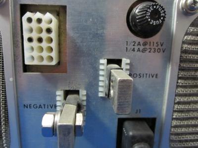

My power supply is a dual output 200A constant current or switch to constant voltage, whatever floats your boat. I haven't quit settled on a reaction
chamber yet, but I'm leaning towards a 6.5 gal plastic bucket with a screw top o-ring sealed lid. Cutting this .25" plate down to size is the next
hurdle to surmount. That's a 13.75" square plate by the way. I got it off ebay for 25.00 plus about 18.00 shipping. They have more if you want to
do a massive titanium welding project
These things would make one hell of a Captain America style shield except for it being square instead of round. Might make a good insert for a kevlar
laced fiberglass buildup on top of it....
I picked the power supply up off ebay. No one seems to know what brand it is or much about where it was manufactured. If anyone recognizes something
in these pics, let me know. This is all the description I got for it:
Mode 1&R 0-50V Dynamic Load: DC 120/1KHz Current Range: 10A, 50A, 100A, 200A This item does not have a Manufacturer, Model or Serial no.

If you take off the cover you might see some manufacturer name or model number?
hyfalcon
Posts: 1003
Registered: 29-3-2012
Took the top off and there is no identifiable marking of any sort. The hunt continues.

It looks like a dual supply. Is there a wattage placard? That'd speak volumes about what sort of energy the unit can deliver to a cell. Dumb
question, what is the input voltage? Usually something of that capacity will do 240V one or three phase. If you can do 0 to 10V and 0 to 100A then
you're golden.
I personally never have used carbon or graphite anodes, so you may have me confused. I know dann2 has used them extensively.
One thing to keep in mind with that monster is the relatively poor conductivity of titanium. Without an adequate shank cross section, you're going to
get some serious heat output. I've seen probably 250 degrees C at 70 amps on a titanium shank that measured 1mm x 25mm. This of course can melt
plastics with ease.

It's a dual output, 200 amp 50v max power supply.
