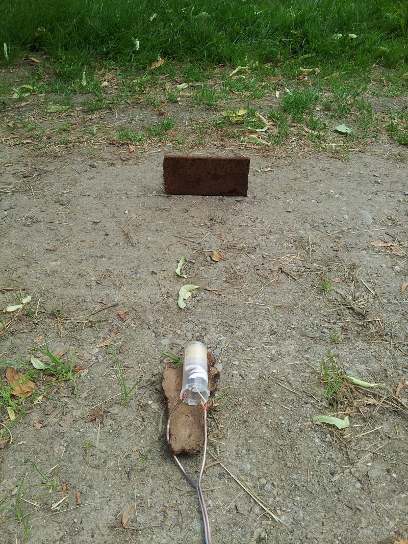

EFP Powered by 87% ETN Putty Explosive Initiated by EBW, ETN, Detonator - Success Again
This test was performed in exactly the same way as the last, except that the target was 1/2" of steel instead of 3/8". I noticed that the standoff may have actually been a little under 16" the last time but this time it was carefully set at 16".
The charge was 12.2g of 87% ETN / 13% PB. The casing was a thin polypropylene disposable pill bottle. The cap holder was made from the pill bottle top liner/seal. The cap used was an exploding bridgewire type, with copper bridgewire, one of three which were made about a month ago. Details of how I have been constructing them are in the thread, "Has anyone made a EBW Setup". The only explosive in the caps is ETN. The 0.5uF capacitor bank was charged to about 3800V before firing. The firing line used was 50ft of RG-6 coaxial cable and another 5ft or so of 18 gauge speaker wire added to the ends as sacrificial cable.
The 24mm diameter liner was made from a piece of 3/4", L grade copper plumbing pipe. A short piece of the pipe was cut lengthwise with a hack saw and pried and hammered flat into a sheet. A blank was cut out with a homemade cutter and hydraulic press and then annealed and shaped into a dish with a dapping block and ball bearing punch. The thickness of the liner was about 0.03" or about 0.76mm or about 3% of the liners diameter. The depth of curvature of the dish was about 4mm or about 16.7% of its diameter.
The copper projectile made a nice clean hole through the target. The best piece of steel I could find in the scrap pile was tapered, but careful aiming allowed me to hit it right where its thickness was slightly over 1/2". All the nice even pieces of plate I could turn up yesterday in the scrap pile seemed to be 7/16" for some reason. I think I need to try a 5/8" target next, since it looked like the projectile possible could have done more. Of course now that I have the formula right EFP technology no longer seems finicky at all.
BTW, a good targeting laser is nice especially for long range targeting, but a low tech method that works really well at close ranges like these is to simply use a straight piece of wood such as a straight meter stick. The EFP can be easily aimed/lined up with the target by holding the straight edge along the EFP casing side and also top.
1.jpg - 850kB 2.jpg - 887kB 3.jpg - 853kB 5.jpg - 877kB 6.jpg - 434kB 7.jpg - 413kB 8.jpg - 644kB 9.jpg - 631kB 10.jpg - 332kB

nux vomica
Posts: 268
Registered: 18-7-2013
[*] posted on 11-7-2015 at 17:20
Nice one hennig what are the outher 2 hits , too far away and moveing closer?
greenlight
Posts: 796
Registered: 3-11-2014
[*] posted on 11-7-2015 at 18:08
Outstanding effect on target again with such a small amount of explosive and halfway to penetrating a full inch of steel.
[Edited on 12-7-2015 by greenlight]
Hennig Brand
Posts: 1284
Registered: 7-6-2009
[*] posted on 11-7-2015 at 18:13
Thanks. This is the first shot since the one described earlier on this page of this thread, the other shallow holes are the result of a bit of liner breakup again I guess. The bulk of the liner seems to have stayed together and gone through the main hole though. The amount of penetration is much more limited with EFPs than with Munroe effect SCs but they can be used at much greater standoff, the exact standoff used is not nearly as critical and the hole made is normally much larger in diameter. This last test produced over 0.5D of penetration (1/2"). Penetrating 5/8" would be well over 0.6D of penetration.
[Edited on 12-7-2015 by Hennig Brand]
nux vomica
Posts: 268
[*] posted on 11-7-2015 at 18:41
Haha you nearly got 3 for the price of one there.:D
I wonder why the liner broke up like that , it would have been interesting to see what it would do if it stayed together.
Maybe the liner is slightly too thin and is being over formed.
[Edited on 12-7-2015 by nux vomica]
