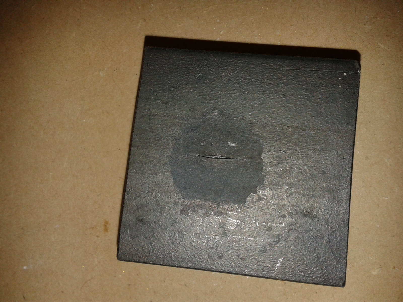

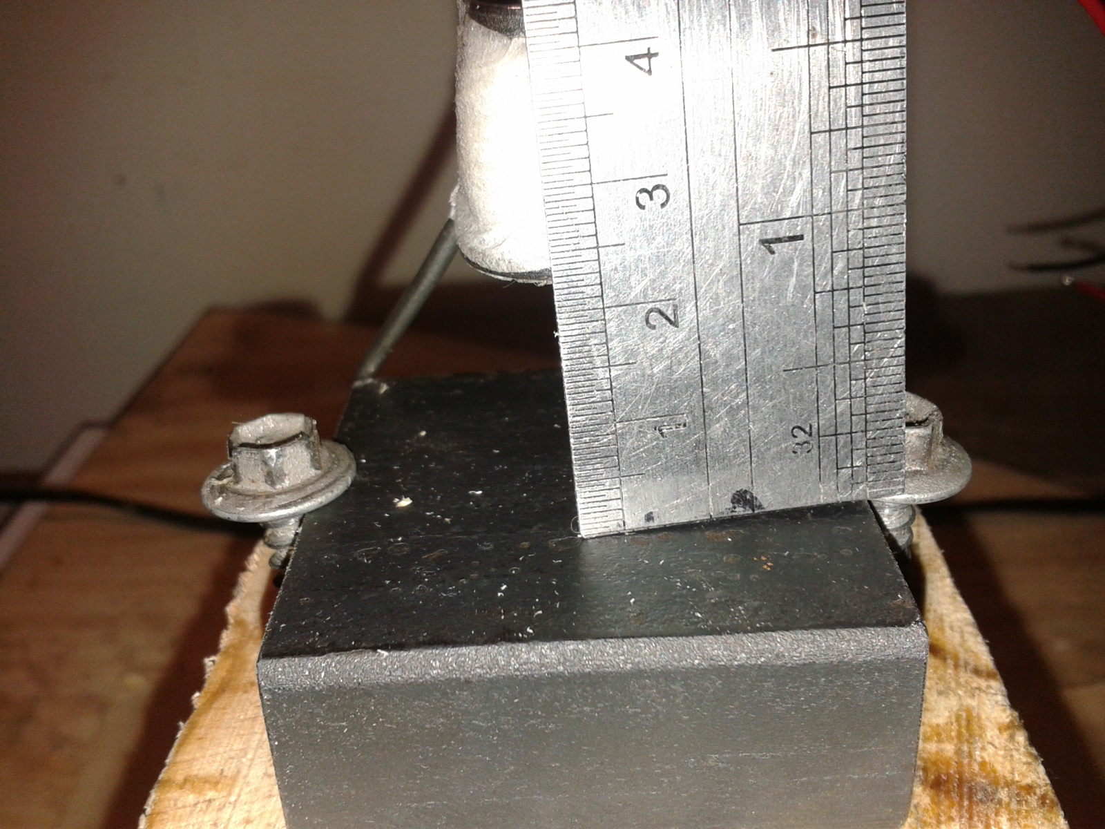

[*] posted on 15-7-2015 at 00:14
I had a go at penetrating 20mm m/s plate, just couldn't get through though it cracked and bulged the back of the plate.
I had 23mm standoff and I think it was too close as the entry looks smaller than normal and there is hardly any copper spatter on the target 2.5 to 3 times standoff might be a better proposition.
Setup was my standard ebw one ie 1.2 grms etn and firing voltage was 3500v.
Cheers Nuxy.

@Nuxy, thats pretty close to complete penetration by the look of the picture, well done.
I agree about the standoff, I think it would have made it through if you had used 40mm standoff like your last test.

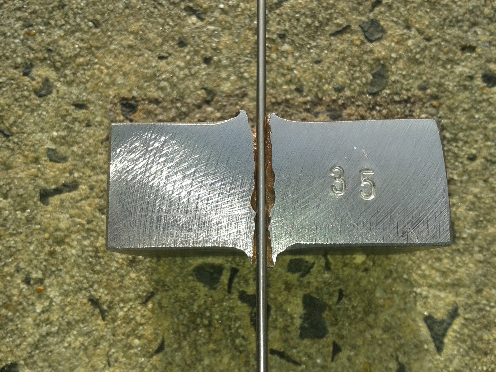

[*] posted on 23-7-2015 at 22:00
Cut the 20mm steel plate that I got full penertation in half looks even better than I thought 3mm dia to 16mm depth then narrowing to 1.75mm for a small amount of etn it sure does some work.
Rod in pic is 1.6 dia.
Cheers Nuxy
