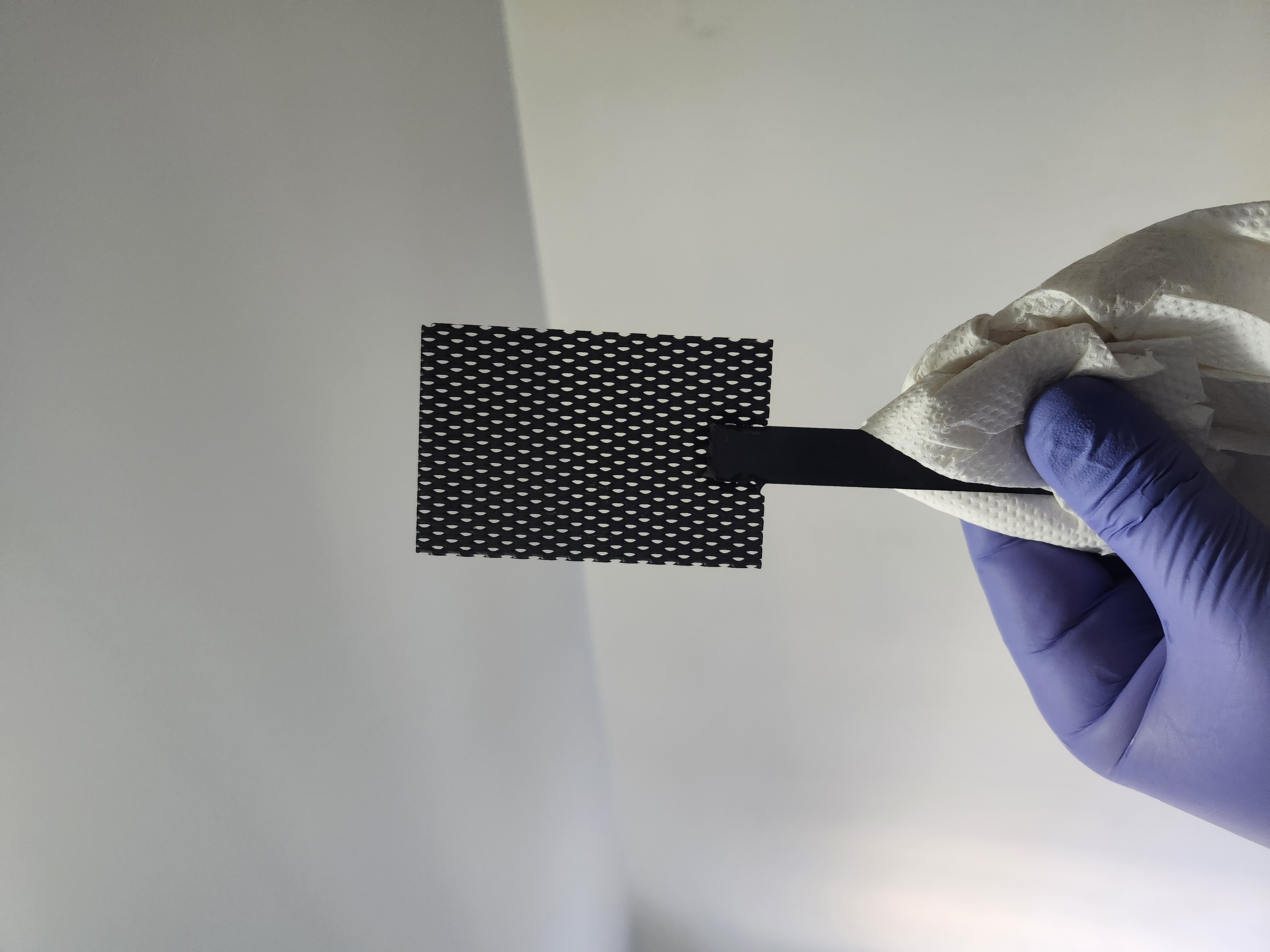

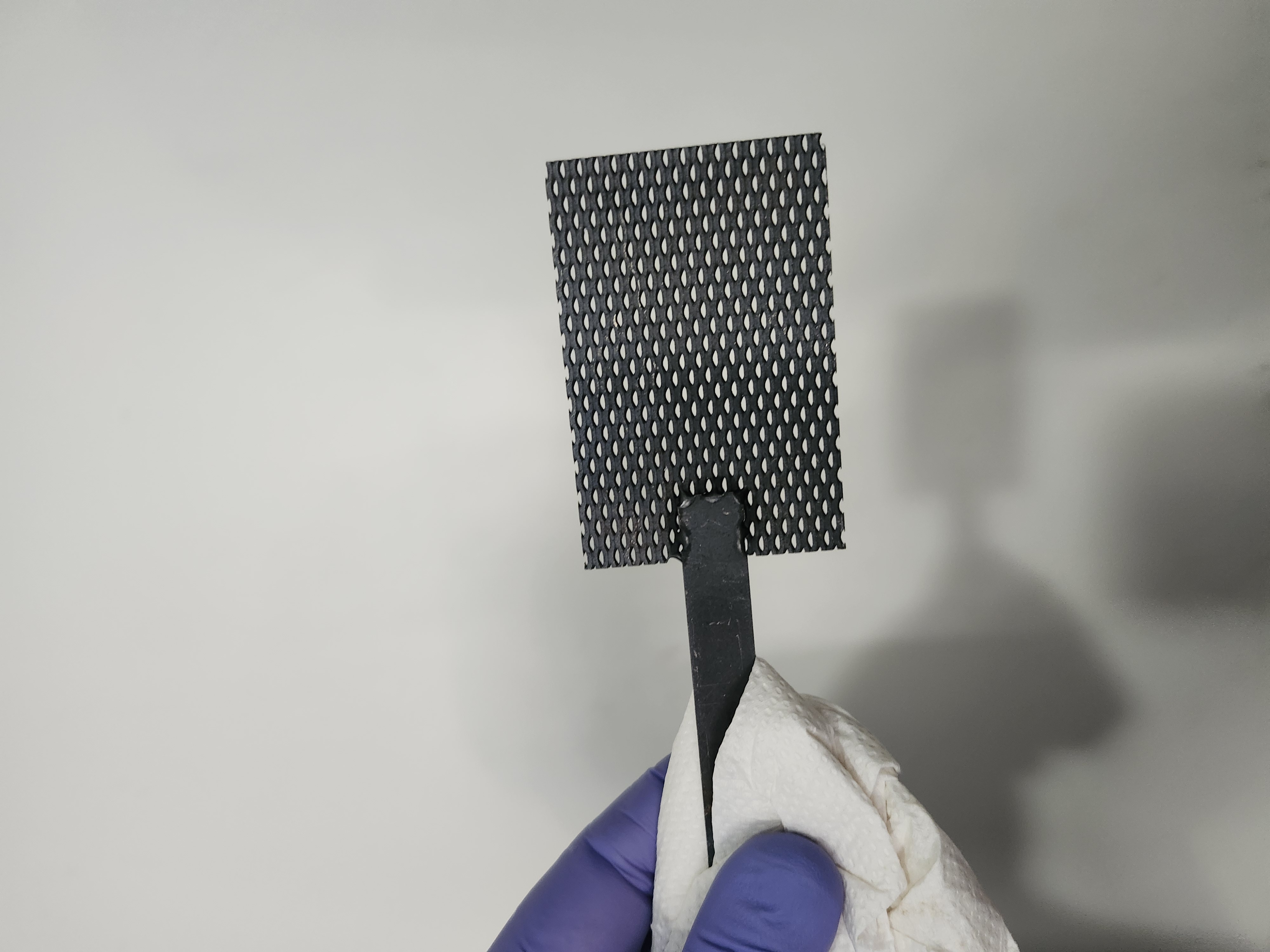

Does anyone currently, for example this year, have experience with purchased PbO anode? Which seller to choose? Low-quality goods, or even almost non-functional anodes, are often sold in this field.
Thanks.....:cool:
Development of primarily - secondary substances CHP (2015) Lithex (2022) Brightelite (2023) Nitrocelite (2024)
mysteriusbhoice
Posts: 477
Registered: 27-1-2016
[*] posted on 25-11-2022 at 10:14
Thanks.....:cool:
either directly from aliexpress or this guy
https://www.ebay.com/itm/204114088089?hash=item2f8625d099:g:...
The issue with this anode is it needs a minimum operating current of 30 amps and thus water cooled cell is preferred.
https://www.ebay.com/itm/204114084203?hash=item2f8625c16b:g:...
this smaller one has rating of 6 amps with 2 cathodes.
Otherwise I do have a full video on how to make PbO2 anodes entirely from scratch using ATO precoat fully capable of going from chloride to perchlorate.
https://www.youtube.com/watch?v=zrJswGKtmDg
https://www.youtube.com/watch?v=xECCZYFDK30
