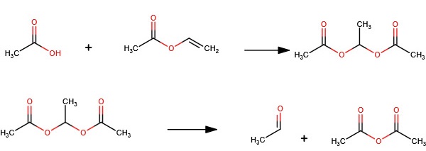

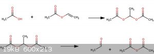

Waffles. Could Polyvinylacetat also be used? It is sold as Glue it could be bought in 5l containers.
No,
Actually you need the monomer, not the polymer. There is a double bond on the monomer which reacts with acetic acid to produce acetal (ethylidene diacetate).
marvinjs-output(1).jpeg - 19kB
If you have access to the starting materials, there are simpler methods for synthesizing Ac2O (than the VA method).

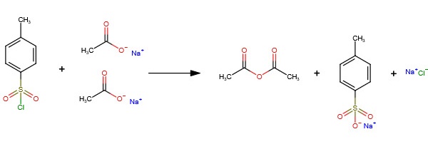

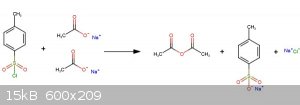

Another simple method is to react Tosyl chloride with dry sodium acetate. Do you have access to them?
