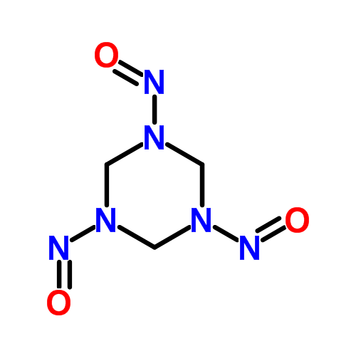

1,3,5-Trinitroso-1,3,5-triazinane (R-Salt)
Molecular Formula C3H6N6O3
Average mass 174.118 Da

Has anyone had success oxidizing TMTN to RDX?
I have tried:
Acetic Acid/Sodium Perborate
Fail-
No reaction
Acetic Acid/Ammonium Nitrate
Success?
foam volcano @70C after about 45m-1Hr, Solution changes color from lemon to white, no yield on crashing with water.
H2SO4/AN
Fail-
Instant decomposition
Acetic Acid/H20/H2SO4/AN
Success-
Solution foams turns color from lemon to white temp rises to ~70C and releases white fumes RDX (what I assume) appears to come out of solution even in
acid but on crashing with water, very little product.
Literature claims AN/H2SO4. I have trouble believing that. Has anyone successfully converted TMTN to RDX? Also, while Im in this thread, has anyone
made RDX from DPT? DNPT is much higher yielding from nitrosation of hexamine in acetic acid than is TMTN. I'm curious if a high yield RDX or HMX could
come from DNPT>oxidize to DPT>Nitration via WFNA to RDX/HMX. Of course that would hinge on first finding out how to properly oxidize TMTN or
DNPT, which is proving difficult.
[Edited on 9-11-2022 by Hey Buddy]
Alkoholvergiftung
Posts: 241
Registered: 12-7-2018
I think you should use nitric acid alone to oxidize it.
[Edited on 10-11-2022 by Alkoholvergiftung]
Hey Buddy
Posts: 444
Registered: 3-11-2020
Location: Bushwhacker Country
Nitric Acid does oxidize r-salt to rdx, according to Lawrence Livermore analytical RDX procedure with H2O2. However, nitric acid can simply form RDX
instead of R-Salt route. I have read many assumptions that R salt can simply "be oxidized" to RDX, but I get the impression some of this may be
speculation. I would enjoy synthesizing RDX in lower yield via TMTN foregoing the reliance of nitric acid.
There are a couple more routes, but they are getting whacky now that the conventional oxidization methods failed.
1) Electrolytic oxidation in ammonium sulfate bath (works very well with NQ reduction to amino guanidine with simple lead anode.)
2) Bubbling ozone through r salt solution
3) oxone (would like to avoid)
4) peroxy-nitrite from NaNO2, HCl, perborate or percarbonate
Literature also claims AN/H2SO4 will oxidize R Salt to RDX but I have not had success. I am curious if *ANYONE from SM has had success with ANY
method?
