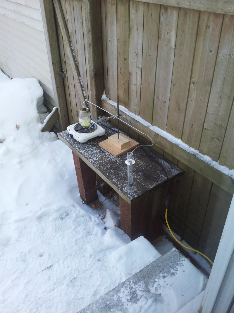

I have been reading about DDNP for about 6 years now, off and on, and it has always seemed sort of illusive. Reading posts here and from the old Rogue science forum it was clear that the big problem was obtaining a suitable reducing agent. The most common and effective selective reducing agents seem to be sodium sulfide, sodium hydrosulfide and ammonium sulfide. After reading one of the excerpts from an early twentieth century chemistry book posted on this forum, I decided to try generating hydrogen sulfide gas and bubble it through a sodium hydroxide solution in order to obtain sodium sulfide or hydrosulfide. The method involves heating a mixture of low volatility hydrocarbon with sulfur. In this case Vaseline was used, but I have seen examples where paraffin was specified. A pdf of the excerpt is also attached at the end of this post.
I have taken a lot of pictures, which should do most of the explaining. A Vaseline and sulfur mixture was put in a mason jar, which had a perfect hole cut in its top to accept a rubber stopper. A piece of mild steel brake line was used to lead and cool the hot gas from the generator to the clear vinyl tubing and bubbler at the other end. An aquarium air stone or bubbler was used as the diffuser.
Safety was of utmost importance, as very small amounts of this gas can kill you. It was a very cold (-20C) and breezy day. The generator was outside and I was inside, behind a glass door that is reasonable airtight, controlling the power to the hotplate remotely with a variac (variable auto transformer).
I increased the power to the hotplate gradually over the course of 30 minutes or so until a fairly steady, but slow, stream of bubbles was coming from the diffuser. I didn't increase the power to the hotplate at this point because I believed slower production was safer. After an hour and a half I was forced to stop as the sulfide/hydroxide solution started to freeze and the diffuser also froze which filled the backyard with H2S stink for 10-15 minutes. It was such a cold day, however, that no one was outside anywhere near where I was operating which was fortunate. Judging by the volume increase at least 3/4 of the sodium hydroxide was converted to sulfide. According to Wiki the yellow colour of the solution is from polysulfide contamination.
The last picture shows the reactants which were to be used for the following partial reduction producing sodium picramate. The sodium (hydro)sulfide solution is on the left and picric acid made (days ago) from aspirin is on the right.
Simple and Cheap Sealed Vessel.jpg - 402kB H2S Bubbler or Diffuser.jpg - 231kB Hydrogen Sulfide Generator.jpg - 414kB Hydrogen Sulfide Bubbling.jpg - 419kB Near End.jpg - 407kB Variac or Variable Auto Transformer.jpg - 413kB Hydrogen Sulfide or Hydrosulfide Solution.jpg - 431kB Reactants for TNP Reduction.jpg - 204kB

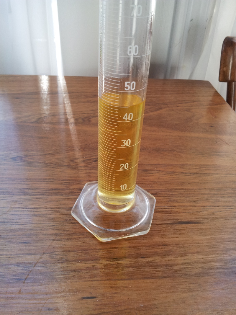

Next, a reduction of the ortho nitro group of picric acid, the one in the 2 position, was performed. Five grams of picric acid (from ASA) was dissolved in a methanol-water solution and neutralized with sodium hydroxide. The solution was made from about 75% methanol and 25% water by volume.
I found a page with the reaction equations, going from TNP to DDNP, which was part of a Chinese primary explosives presentation. I have included a jpg of that reaction equations page, as well as a link to the whole presentation.
http://www.cecd.umd.edu/documents/presentations/Hong-Kong/Yi...
The article I was reading when I performed the reduction is attached, and was also found on this forum. I believe Rosco posted it. I didn't follow it accurately unfortunately, because of not knowing the process well and being distracted. The reaction time was much longer than recommended by the article and it took me a long time to get the temperature up to where it should have been. I also was unsure of the concentration of my previously prepared sulfide solution and I am sure I didn't use enough. A ferrous sulphate solution was used to test for reaction completion, but in retrospect it was obvious that the endpoint hadn't been reached. I obtained about a 60% yield, and the article reported yields in some cases in the high 90's. I still have at least 3/4 of my sulfide solution, so I will try again.
The colour change going through the reduction reaction is really very beautiful. The product in the last picture is (or should be) sodium picramate.
Conversion of the sodium picramate to picramic acid was easily accomplished by dissolving it in water and acidulating with sulfuric acid. Pictures of the picramic acid produced, as well as the DDNP produced from it, will be shown in the DDNP thread.
DDNP from Picric Acid Reaction Equations.jpg - 53kB Ferrous Sulphate Solution.jpg - 314kB Reduction 1.jpg - 256kB Reduction 2.jpg - 254kB Reduction 3.jpg - 235kB Reduction 4.jpg - 236kB Reduction 5.jpg - 236kB Sodium Picramate (1).jpg - 282kB Sodium Picramate (2).jpg - 226kB
Attachment: Picramic Acid using Sodium (Hydro)Sulfide J[1]. Chem. Soc., 1945, 663 - 665,.pdf (344kB)
This file has been downloaded 1882 times
[Edited on 27-1-2014 by Hennig Brand]

"According to Wiki the yellow colour of the solution is from polysulfide contamination."
I've been told that sulfur contamination is detrimental, and you've gotten around that by going for H2S. Do you know what effect the polysulfides would have on the final DDNP?
Hennig Brand
Posts: 1284
Registered: 7-6-2009
[*] posted on 27-1-2014 at 17:17
I think the polysulfide contamination is only present in very small quantities. The yellow colour gradually developed after an hour and a half of bubbling hydrogen sulfide into the sodium hydroxide solution. I believe a lot of lab grade solutions have a slight yellow tinge to them for the same reason. If it was absolutely pure it would be clear, from what I have read.

Actually after reading a bit more, it seems that sodium hydrosulfide is easily converted to polysulfides by oxygen. There could be more polysulfides in that solution than I thought. There is a very good chance that I converted a lot of the sodium hydroxide all the way to sodium hydrosulfide.
From Wiki page on sodium sulfide:
"Sodium sulfide is the chemical compound with the formula Na2S, or more commonly its hydrate Na2S·9H2O. Both are colorless water-soluble salts that give strongly alkaline solutions. When exposed to moist air, Na2S and its hydrates emit hydrogen sulfide, which smells like rotten eggs. Some commercial samples are specified as Na2S·xH2O, where a weight percentage of Na2S is specified. Commonly available grades have around 60% Na2S by weight, which means that x is around 3. Such technical grades of sodium sulfide have a yellow appearance owing to the presence of polysulfides. These grades of sodium sulfide are marketed as 'sodium sulfide flakes'. Although the solid is yellow, solutions of it are colorless."
From Wiki page on sodium hydrosulfide:
"Solutions of HS− are sensitive to oxygen, converting mainly to polysulfides, indicated by the appearance of yellow."

[*] posted on 29-1-2014 at 15:33
Just so it's clear, the green solution in the second picture above is slightly acidic aqueous ferrous sulphate. It was used as an indicator in order to test for the presence of sulfide. A little of the reduction reaction mixture was extracted with a pipette from time to time and placed in a small beaker, to which a little ferrous sulphate solution was added. A black precipitate of iron sulfide would show that the reduction was complete and that there was unreacted sulfide in the reaction mixture. Obviously waiting a certain length of time after a sulfide addition before doing the test is required.
Fe2(SO4)3 (aq) + 3 Na2S (aq) ---> 3 Na2SO4 (aq) + Fe2S3 (s)
The ferrous sulphate solution was prepared by dissolving fine steel wool in dilute sulfuric acid.
[Edited on 30-1-2014 by Hennig Brand]
