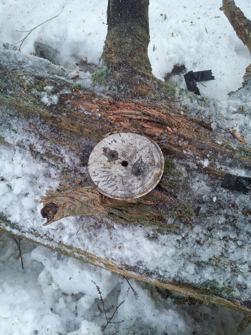

Success Initiating Picric Acid at 7.6mm id with 0.7g of DDNP
The same setup as was used for the 1g DDNP test above was used. This time, however, instead of 1g of DDNP only 0.7g of DDNP was used. Also, instead of 2g only 1.5g of Picric Acid was used, which maybe I shouldn't have changed. The DDNP was not recrystallized. One gram of picric acid was pressed into the detonator capsule with a lever press and then another 0.5g was pressed in by hand. DDNP (0.5g) was pressed into the homemade reinforcing cap and 0.2g of DDNP was poured into the detonator capsule loose on top of the picric acid base charge. Care was taken to not overpress the DDNP. Finally the reinforcing cap full of DDNP was pressed into place in the detonator capsule, with the lever press. A little loose black powder and visco fuse were put in place and the open end sealed with a bit of hot melt glue. The 0.7g of DDNP detonated the picric acid, which makes me feel that using 1g of DDNP in this configuration should be reasonably reliable.
From the pictures it can be seen that the hole produced in the 3mm thick steel witness plate is not as large or clean as from the last test. Two things were different in this test. The first was that only 1.5g of picric acid was used. The second was the way the bottom of the cap was waterproofed. For the first test, the cap bottom was waterproofed with a thin layer of lacquer, but this time a corner was cut and a bit of hot melt glue was smeared over the end. The lacquer had negligible thickness but the hot melt glue was estimated at over 1mm. The cap and witness plate were not as well connected for this test.
BTW, the hole on the right in the pictures is the one corresponding to this test.
Witness Top View.jpg - 488kB Witness Bottom View.jpg - 493kB

It will be found that there is information in the literature with which I do not agree about the conclusions and analysis of what is occurring. I believe that testing based on weight scaling of charges without scaling the weights according to the geometry will skew results and lead to incorrect conclusions about for example the "efficiency" of detonators with regards to performance alone and without regards to economy of materials. The focus of the research done seems biased towards economy of materials alone, but tests are not done to show the actual performance increase or maintenance of the performance as a function of geometric scaling for different diameter detonators.
I believe that the early researchers and possibly later researchers as well have erred in the supposition that geometric scaling is not very much a factor in detonator scale explosive devices. To illustrate what is my meaning, for example with regards to the Miniature Cartridge Test, if the amount of primary used for the larger diameter detonator was scaled upwards geometrically along with a proportional scaling increase for the base charge, I believe that there would be a greater than arithmetic proportional bump in the performance as measured by the sand test as would be expected by simple multiplication. Such tests are conspicuously omitted, because they would likely reveal a parameter about performance without regards to economy that is not wished to be highlighted.
The minimum effective initiating charge for the smaller diameter should be increased for the larger diameter detonator output potential to be realized. There is an aspect called "overdriving" which applies to reveal the true performance potential of a detonator generously larger than its critical diameter, where "performance" in terms of economy of materials is secondary to reliability and potential output that can be realized, without being constrained by highest economy of materials as defining also what is to be regarded as being the "highest performance". Some evidence of this is shown by the plate tests which would seem contradictory to the Miniature Cartridge sand test. The plates are actually showing the truer result that would likely be also revealed by the sand tests if the proportionally increased diameter detonators were also proportionally greater primed with a proportionally increased amount of initiator also matched with a proportionally greater base charge. I predict that in such case there would be a proportionally greater output shown by such tests not done. And I also predict that the failure rate would be lower for the larger diameter detonators, loaded at a comparable multiplier increase beyond the minimum loading found to produce a true high order output for 10 out of 10 tests. The larger diameter detonators will have a failure rate that is lower as the initiator loading is decreased towards what is the bare minimum requirement.
For example the "operational theory" applied by the naval ordnance designer, will differ considerably from what is the operational theory of the bean counter at the bureau of mines. :D The coal miner may rely upon a lot more duds as a result than will any 16 inch shells or torpedoes or mines be found failing to go off at their appointed time.
Your tests are showing the effect of "tuning" the device parameters. For specific materials you will find there is a reliable configuration, and there will be a range of factors that define what are its design limits and expected performance. If you are familiar with handloading ammunition and working up a load that works well for a specific combination of components, you will recognize the parallel of finding what combination works by trial and error and charting the results which can lead to a highly refined configuration for the components being used.

Yeah the plate test won't lie to you about what you have. If you are blowing a nice hole and you get that signature radial pattern surface spray of particle impacts, you have got what you want to see.

I haven't done a lot of testing of this but the more brisant explosives, like picric acid, tend to make and propel shrapnel and shatter and cut even steel. Less brisant explosives need confinement to be efficient. The less brisant explosives can bend and tear steel if enough is used, but it's not the same shattering effect as with brisant explosives. I don't think there are too many blasting agents or dynamites that would work at a 7.6mm diameter either. The first chapters of many explosives texts will explain this better than I just did.

If the plate isn't pierced, more brisant explosives tend to give deeper dents while more powerful and less brisant give wider and shallower dents.
I normally use aluminium plates for plate tests and when they are pierced, rounder holes indicate higher brisance. Shattering too of course. I could upload some pictures later if you want.
