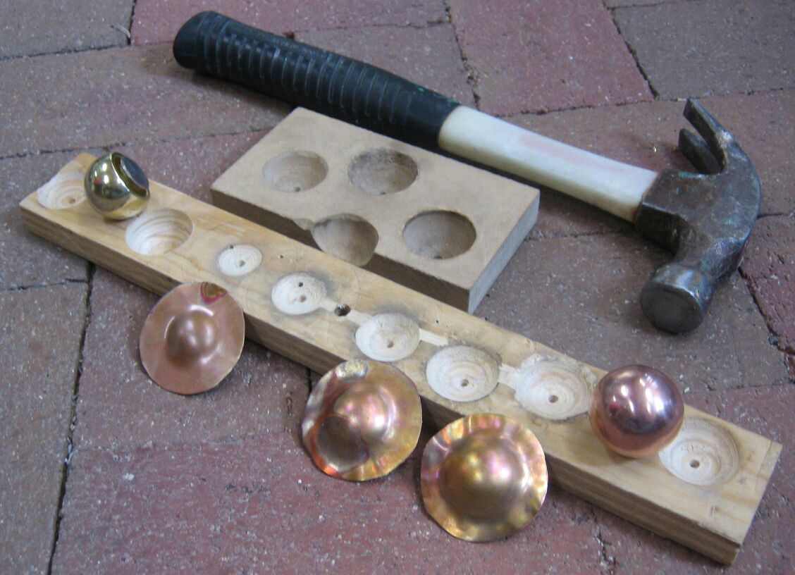

[*] posted on 26-8-2015 at 02:00
Hi All,
I think making concave metal hemisphere shaped charge is much easier than a cone. check figure below.
The cone should be symmetric , apex should be in the center, .....etc , this makes cone design a real challenge
Most of the videos I saw and papers I read prefer cone ! , What I know that a cone would have deeper penetration distance and the hemisphere would have wider hole in the target.
is there any other preferences for using cone rather than hemisphere ?
IMG_20150724_WA0012.jpg - 132kB
