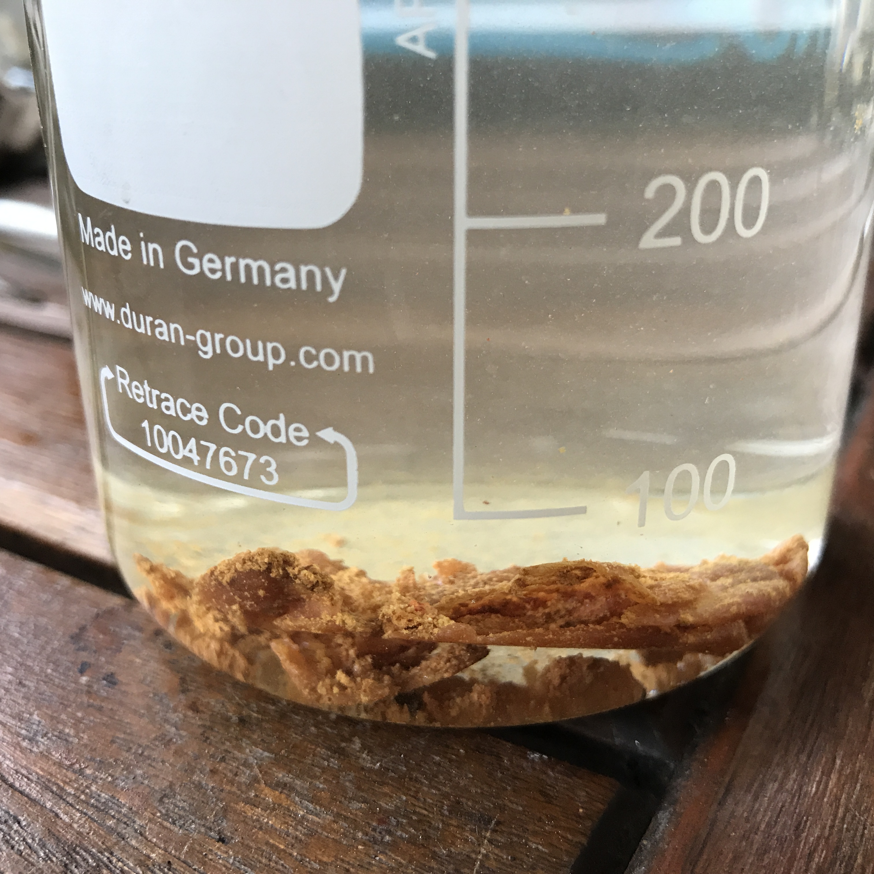

Been quite busy the past couple of weekends trying to get some P4 in OK yield. finally i had some success! after using the small scale method devised by strepta i found the product was hard to recover and not enough. there had to be a better way. it has taken me quite some time to read this thread in it's entirety but the knowledge discovered has been vital to success. using my gas powered forge i heated up the classic mixture of NaPO3, SiO2 and dark Al powder plus a little NaCl flux as suggested several pages back. Also using a variation of the steel can retort Magpie was using for a while was a great idea. previously i had tried a retort made from welded steel tube and plumbing bits but this failed. my forge was actually too hot and melted holes in the steel. it easily pushes 1200C when it is warmed up. figuring that a brute force heating is not needed nor was the thick steel tube setup i opted to go with the steel 500ml paint can. it is good to have it finally working but i wish the yields were better. i did another run today with the retort exit tube deeper in the water and also a cone of steel mesh around it to try to break up the bubbles a bit better. the results were better and there seemed to be bits of P4 caught in the mesh, however i pushed the limits of the retorts capacity and had it breach. next i will line one with refractory of some sort.
Pretty keen to try other methods. i have a 500ml bottle of 85% phosphoric acid i bought over a year ago which i hav barely used 10mls of. also have a bunch of mono ammonium phosphate.
maybe a carbon based reduction in the near future once i make a better setup. I also have everything I need to build an electric furnace including Hi temp fire bricks, kaowool, Kanthal elements, PID and SSR, thermocouple and steel angle. I just need to find the time to put it together.

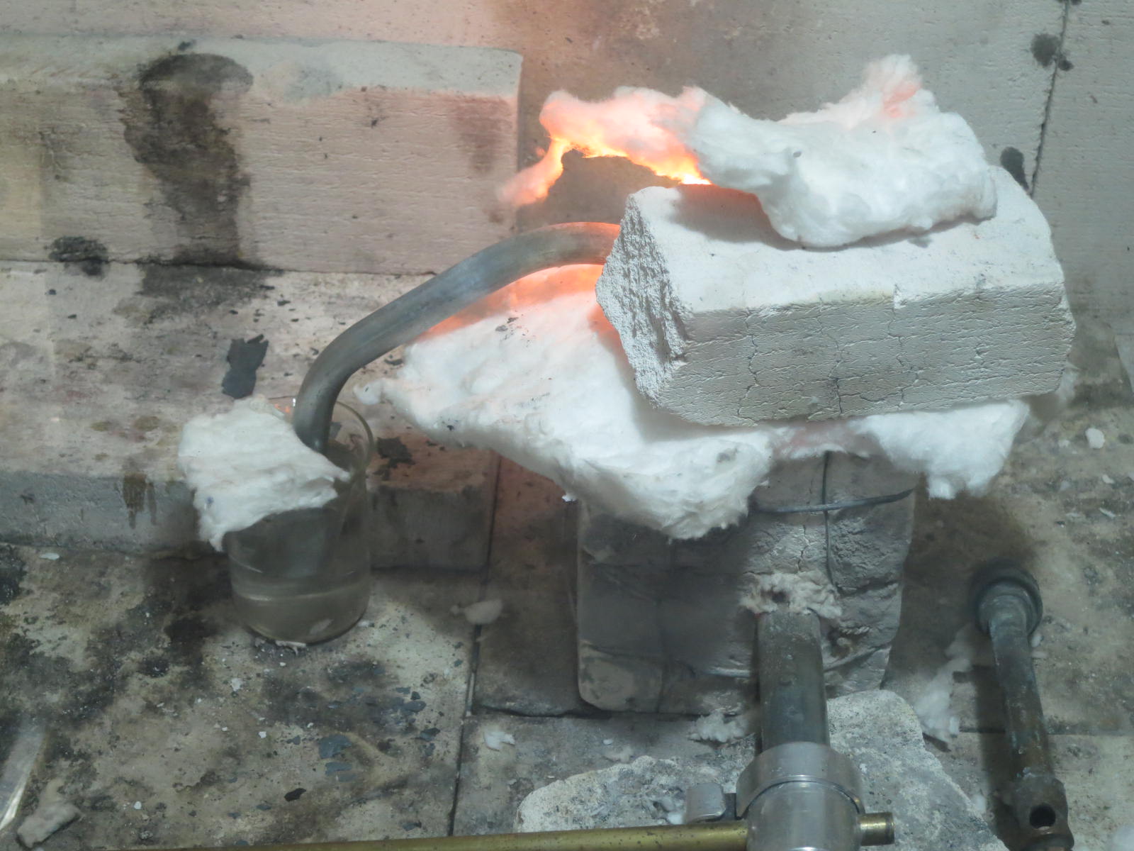

I watched your videos and tried it out.
I don't have NaPO3, but I have Ca3(PO4)2. I mixed 31 parts of it with 18 parts SiO2 (hardware store fine silica sand used for mixing with stucco) and 9 parts Al powder.
6 Ca3(PO4)2 + 18 SiO2 + 20 Al => 18 CaSiO3 + 10 Al2O3 + 3 P4.
weight parts: 1860 : 1080 : 540 = 31 : 18 : 9.
I heated it to 1000 C in a steel tube retort after flushing it with Ar gas with the nozzle under water and after a few minutes bubbles appeared and then a few flames above the water with white smoke. That should be P4, but was unable to capture it.
Here a video of the cooled retort emanating white smoke, probably slowly burning P4 to P2O5.
https://www.metallab.net/jwplayer/video.php?f=/clips/P2O5_fr...
[Edited on 2017-10-2 by metalresearcher]

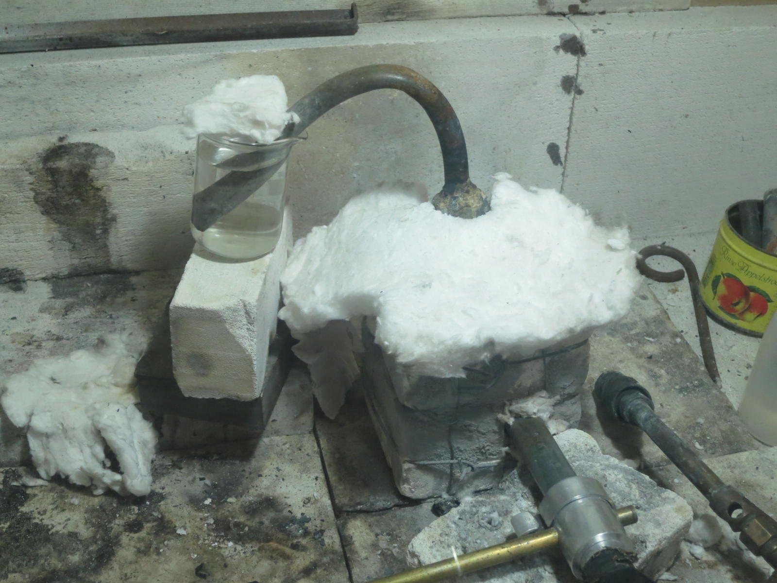

Another try, I used black pyro Al powder instead of gray stabilized.
After Just a few minutes after starting to heat it in a small propane furnace it started bubbling heavily in the beaker (left on the photo) and saw a bright light with a pop, presumably P4 vapor / air mixture which had a small explosion.
After that bubbling stopped even after increasing retort temp to 800-1000 C so after 5 minutes I shut it down.
It appears that the reaction takes place in a kind of 'burst mode' : very quick reaction releasing all the P4 and then it stops.
On the photo: the white blanket on top is kaowool to keep the heat inside.
Next time I'll capture the P4 vapor in a closed tube (e.g. upside down test tube) filled with water to prevent escaping and force it to condense.

I think that more water is in order from the looks of your setup.
But since deeply submerging the outflow pipe in the flask led to clogging in previous trials, maybe one way to prevent P4 from condensing and clogging the tube might be to insulate the tube from the surrounding water with e.g. a few layers of foam tape. This should keep the inside of the tube hot enough to prevent condensation. Then you can put it in deeper water.
You could also consider a multi-stage condenser, with a pipe leading into one flask and the outgas from that flask led down another pipe into the next, etc... hopefully condensation will then occur on the walls of the flasks and not in the tubes. Unfortunately this might not be the easiest thing to construct.
A solution of NaHCO3 in the collection flask -- particularly in the first stage of a multi-stage setup -- would generate CO2 outgas that could help keep the pipes in the later stages clear and thus allow them to be submerged deeper, while at the same time inhibiting combustion. This is a little more speculative I guess.
[Edited on 4-10-2017 by clearly_not_atara]

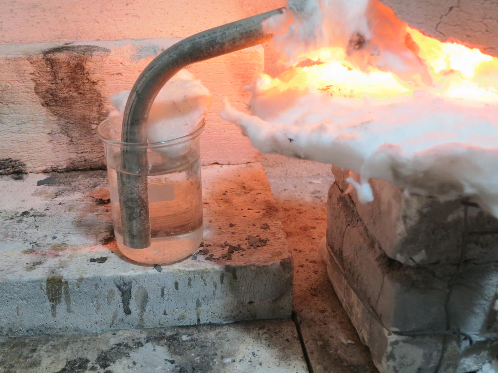

Now tried with carbon.
FAIL :-((
OVERHEATED !
6 Ca3(PO4)2 + 18 SiO2 (fine silica sand) + 30 C(harcoal powder) =>
3 P4 + 30 CO + 18 CaSiO3
weight ratio is 31 : 18 : 6.
I mixed 1.5g + 0.9g + 0.3g and put it into a 15mm OD steel tube of which one end is welded. That end I put in another short 30mm OD steel tube to as a double layer due to the extreme heat.
I had to heat it up to 1200 - 1400 C in the same mini propane forge.
I put the nozzle into hot water of 60 C and started the run.
Soon i started bubbling which continued about 10 minutes and the inside of the furnace was blinding yellow.
Suddenly the bubbling stopped so I decided to shut it down and took out the yellow hot retort which sparked a bit, which means it is close to the melting point of steel.
I let it cool and saw indeed that there is a leak in the inner tube and there were traces of melting of the steel / scale (Fe3O4, which has about the same mp as steel). It must have been at least 1400 C.
Next time a little cooler ....

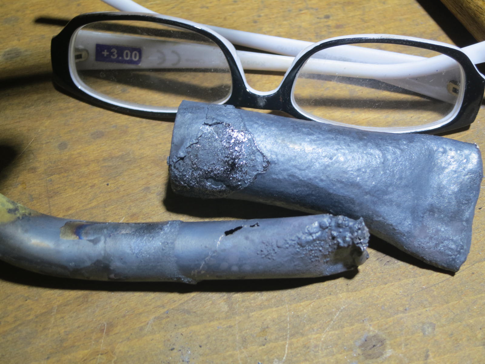

I made a new double walled retort with a 3mm thick walled outer tube and silica sand between the outer and inner tube, the latter being the retort, filled with Ca3(PO4)2, SiO2 (silica sand) and charcoal powder.
I heated it 20 minutes and now it kept bubbling, hoping some P4 vapor would appear, but it stopped again.
After shutdown and cooling it revealed a partially molten outer steel tube and leaking inner tube, so the temp must have been close to 1500 C ! With a simple DIY natural gas burner (not propane as I said earlier) with forced air on a simple domestic supply of 30mbar (1/2 psi).
Next time a retort from iridium ;-)
I think I would revert to aluminum as reducer as the temperatures required for carbon reduction melt and destroy my steel retorts.

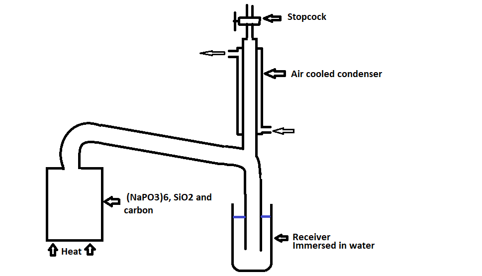

Seems to me that the way forward is by using the carbothermoreduction method.
The major drawback of this it would seem is simply that the process produces waaaay too much gas to be controllable at a large scale.
So the obvious solution would be to find a way to remove the hot carbon monoxide/dioxide without removing the desirable P4, sooooo why not set up a refluxing system above the receiver.
Like you can see in my professional looking drawing.
phoshorous retort.png - 18kB
I realize dropping the temp of the condenser down to below 280*C is no gonna be easy, my drawing suggest using air cooling but if the column between the receiver and retort was long enough then i see no reason why we cannot use water.
The stopcock would allow control over the amount of gas being let out and could be closed if too much phosphorous was escaping out the stopcock as it would be clearly visible as phosphorous pentoxide.
The only major problem i see is that the condenser may not be enough to drop the P4 out of the gas flow, however i would imagine if there were enough space inside and the condenser were tall enough then it should be enough to remove the P4 before it gets to the stopcock.
You wont be able to remove all the gas i know but provided the receiver was submerged deep enough you should be able to get a less intense flow of distillate.
Obviously this would be a much larger engineering project than a typical retort but building a steel condenser and stopcock is nothing too complicated for somebody who has a wielder.
Just my suggestion :cool:
