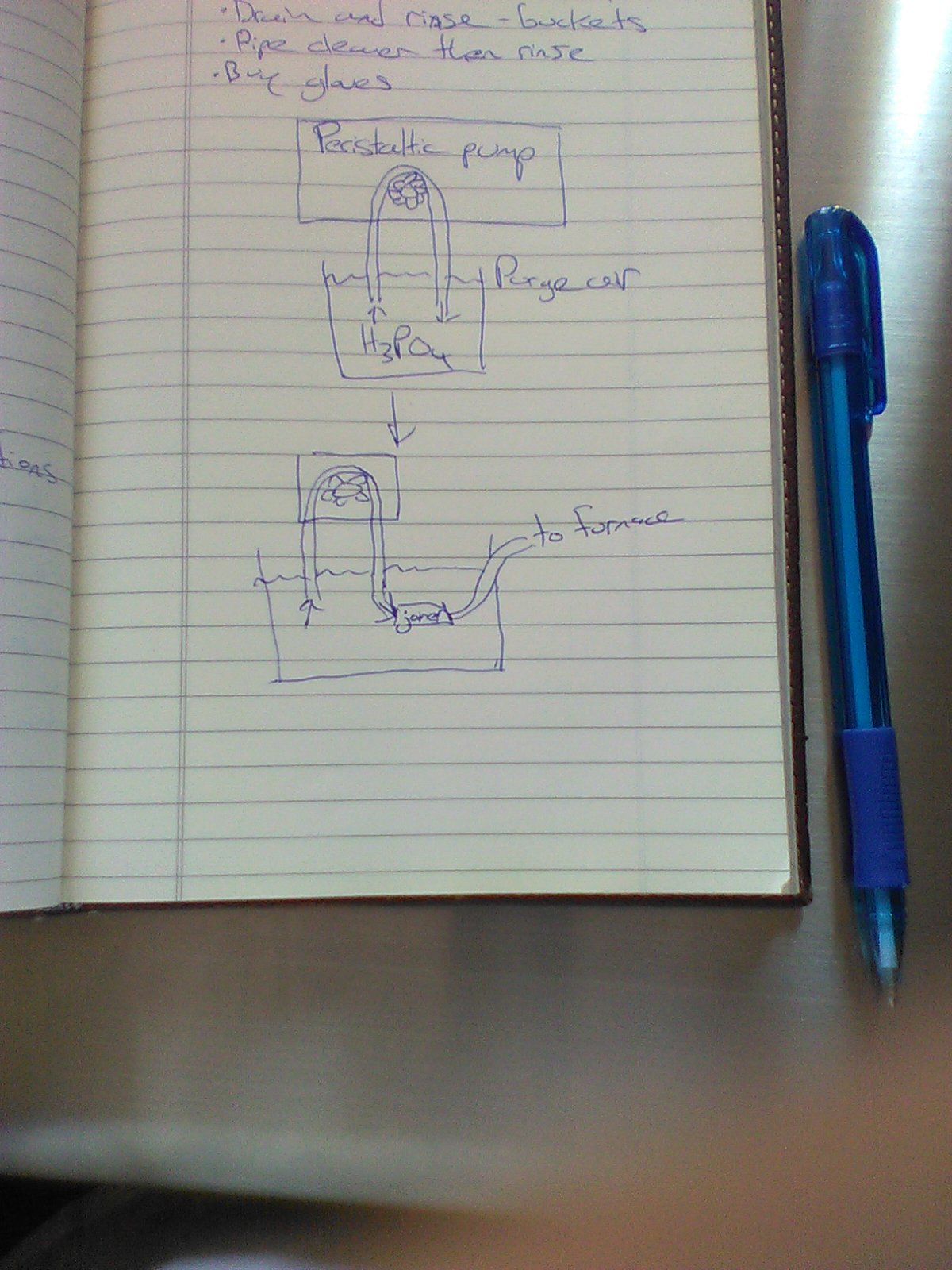

Great news! A 2019 paper (attached) published in the International Journal of Materials and Metallurgical Engineering describes the process of producing phosphorus from the carbothermic reduction of phosphoric acid. This is strong evidence that the method I am trying can work.
Rather than heating the acid gradually in the tube as the Japanese researchers did, I am planning to pump the acid in with a peristaltic pump once the carbon is already hot. The procedure will be as follows:
1) Placing both ends of the peristaltic pump's tube into a beaker of phosphoric acid, purge the peristaltic line of all air by pumping the acid in a loop out and back into the beaker
2) Flush system (furnace, phosphorus collection flask, schlenk line, ...) with argon
3) While keeping peristaltic line and furnace connection tubing submerged in the acid, use tubing joiner to connect peristaltic line to furnace connection tubing (the tubing can be lifted out of the acid once the tubes are joined and a seal is made)
See the attached picture for a visual.
