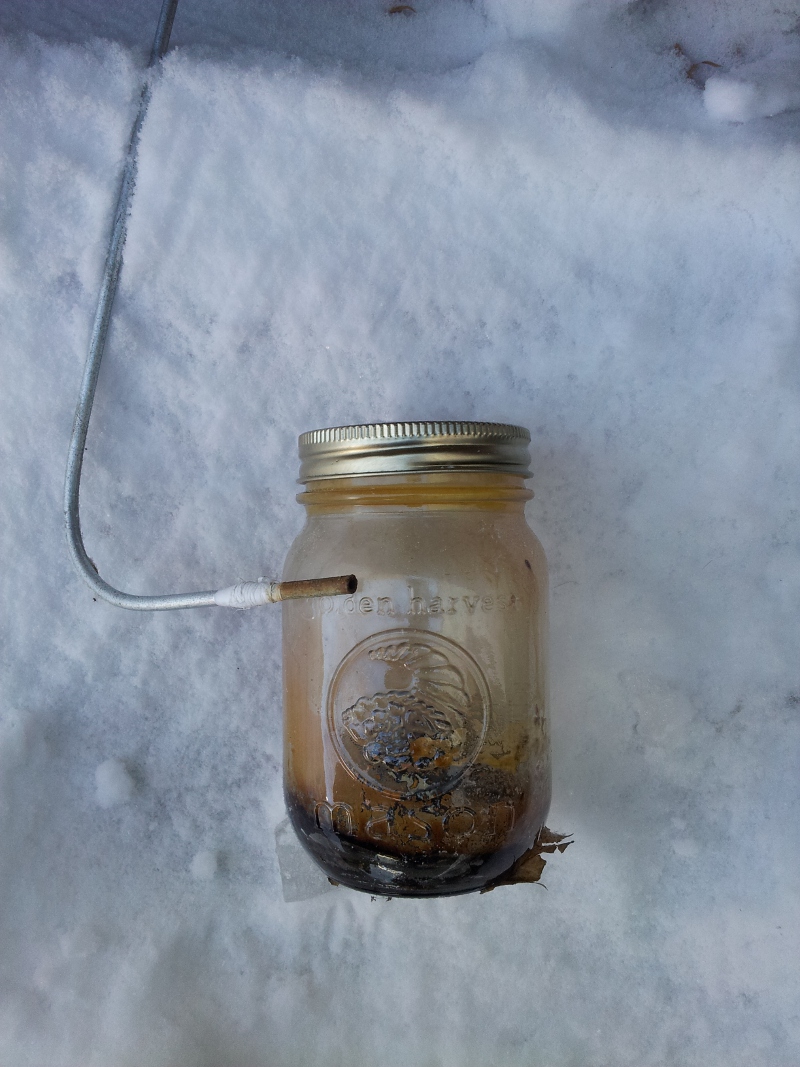

I am not yet getting anywhere near 100% yields with the method I am using, but I believe my picramate is very pure given the yields of DDNP obtained from it. A melting point could easily be taken, to determine purity, but my melting point apparatus is not close enough to get to for the next little while.
The sulfur contamination issue made me remember something I forgot to point out earlier. During the hydrogen sulfide gas generation process there was some sulfur sublimation and deposition going on. You can see it in the attached picture. There was no evidence that the sulfur made it past the cold steel tube, however, as even after 1.5 hours the vinyl tubing between the steel tubing and the diffuser/bubbler was perfectly clear showing no signs of deposited sulfur. Ambient temperature was about minus 200C, of course, which would have really helped keep the sulfur vapor from traveling very far in the steel tube.
Hydrogen Sulfide Generator.jpg - 386kB
[Edited on 6-2-2014 by Hennig Brand]

Ideas For Reducing The Poisoning Risk Associated With Hydrogen Sulfide Generation
Apart from dealing with toxic H2S, the process is very straightforward giving high yields and, yes, a very pure product. From what I have read it seemed like the best option to obtain a high purity sulfide reducing agent. Hydrogen sulfide is extremely poisonous, though, and I won't be doing this again until I have found or developed a little better process. I still have a bit of a sore throat, and feel a little unhealthy, and that is from fairly mild exposure close to 2 days ago. Very dangerous stuff indeed!
In the absence of a good fume hood a strong electrical fan could be placed just over the generator as it was disassembled. What would be even better would be to have the type of blower fan that connects to large flexible air hose so that the H2S gas could be lead safely away from the work area during disassembly. With a decent fan, and maybe also a H2S rated gas mask, disassembling the gas generator would be much safer.
Ok, I think I have a simple yet effective solution to the poisoning by gas generator disassembly problem. Hydrogen sulfide is fairly soluble in water (ca. 0.12 mol/l or 4.1g/l at 200C & ca.0.15 mol/l or 5.1 g/l at 100C). Values taken from "The solubility of gases in distilled water and seawater-V. Hydrogen Sulfide", by A.A. Douabul and J.P.Riley
The volume of hydrogen sulfide in the glass mason jar used was about 450mL (or less) and was not under pressure. Using the simple 22.4 L/mol rule for ideal gases at STP, it was found that the mason jar could contain as much as 0.02 moles or about 0.68g of H2S. Given that 170 mL of water at 200C can absorb that amount of hydrogen sulfide, a 2 gallon bucket of cool water would absorb it easily. The idea was to let the reactor cool undisturbed and then immerse it in a bucket of water. Two bricks could be placed on the bottom of the bucket, with space between them. The generator vessel (mason jar) could be flipped upside down under water before the rubber stopper or top was removed and then placed over the two bricks so that the water could contact the gas. Another brick or dense object would need to be placed over the top of the jar to hold it down. A little sodium hydroxide could be added to the bucket of water beforehand if converting the hydrogen sulfide to sodium (hydro)sulfide seemed advantageous. A little sodium hydroxide in the water would greatly increase the speed of absorbtion.
The process could maybe be improved, but I think the general idea is sound and would greatly increase safety. I guess a person could hold the jar under a sprinkler system when it was opened. :D Or even better a sprinkler system that was spraying sodium hydroxide solution (ouch!) Shouldn't make jokes, but I couldn't resist.
The smartest thing, now that I am starting to fully understand the seriousness of the poison issue, would be to use a much smaller vessel so that a much smaller quantity of poison gas would be left in the vessel after production was finished. The reason a larger one was used was because it put the screw top with stopper well away from the heat source below. It also allowed most of the sublimed sulfur to deposit in the jar so that it didn't end up in the delivery tube. The 16 oz size is also the most common for a mason jar (I think).
Ok, I think this is the best idea yet. The top of the mason jar, or rubber stopper, could have installed a small hose barb the size that is needed to attach an aquarium pump air line. This would either have to have a small valve or some other way of keeping it closed during the generation process and be safely opened after generation. When gas production is complete, simply attach an aquarium air pump and pump air into the reactor which will dilute and carry (or force) the H2S out of the generator and through the bubbler where it is safely absorbed. It might be a good idea to use a fresh sodium hydroxide solution since the one used during generation should be very saturated or close to it and therefore have less absorbtion ability. Also pumping air (oxygen) into the prepared sodium hydrosulfide solution will convert some of the sodium hydrosulfide to polysulfides, which is also undesirable.
[Edited on 20-2-2014 by Hennig Brand]
