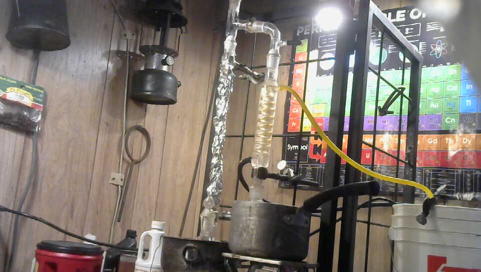

[*] posted on 1-6-2020 at 15:09
I'm trying my first medium-scale brew & still.... 3 gallons of what the yeast pack promises is 20% alcohol are in the fridge and I'm setting up to try distilling in the backyard tomorrow :)

[*] posted on 1-6-2020 at 19:02
I find it quite fulfilling distilling small (gallon size batch of 55% EtOH) amounts of alcohol. And besides, I'm chipping in on the Sars-Co2 abatement. Hand sanitizer is mostly EtOH.
