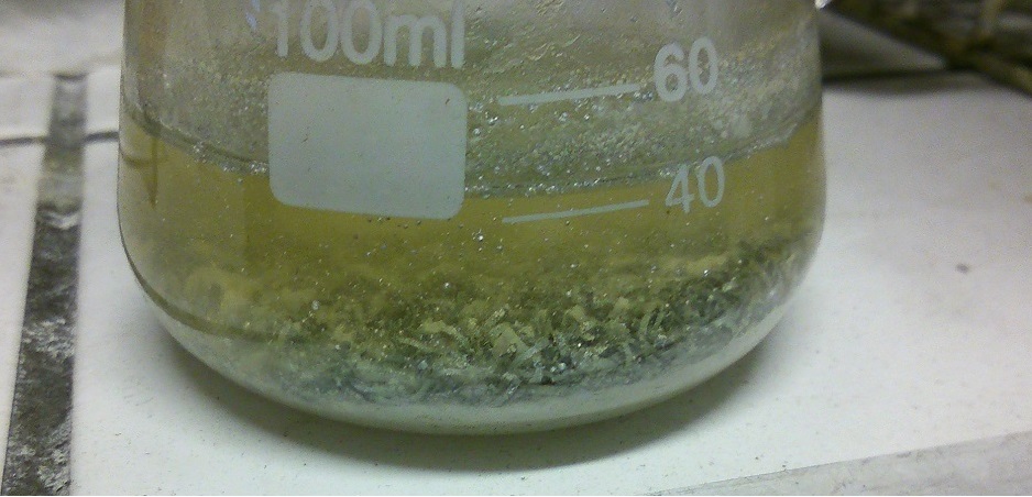

[*] posted on 3-12-2019 at 04:08
Success!
Well, for longer I've been away from this topic than expected, but I'm back with some new results.
I have tried t-amyl alcohol as a catalyst...
... and well it worked!
DSC_1108.jpg - 141kB
I am also now sure that I have issues with insufficient power output of my hotplate. With a lot of hassle I was able to produce only these little droplets of metalic potassium. Well, at least that's something.
I am inclined to think that either menthol isn't a suitable catalyst for producing potassium or that it is much less active than t-amyl alcohol. Shame, because it's cheaper and easier to get... Anyway - achievement unlocked ;)
draculic acid69

[*] posted on 3-12-2019 at 19:34
Nicely done.did u perform everything the same as the unsuccessful menthol runs?
oberkarteufel
Posts: 47
Registered: 11-12-2018
Mood: Mayonesium sulfate
[*] posted on 4-12-2019 at 03:11
Yup, same paraffin oil from pharmacy, heating regime etc. IIRC Total time of heating (first for drying the mixture, then after adding a catalyst) was 5+ hours.

[*] posted on 4-12-2019 at 04:41
I think u just proved menthol doesnt work for potassium.

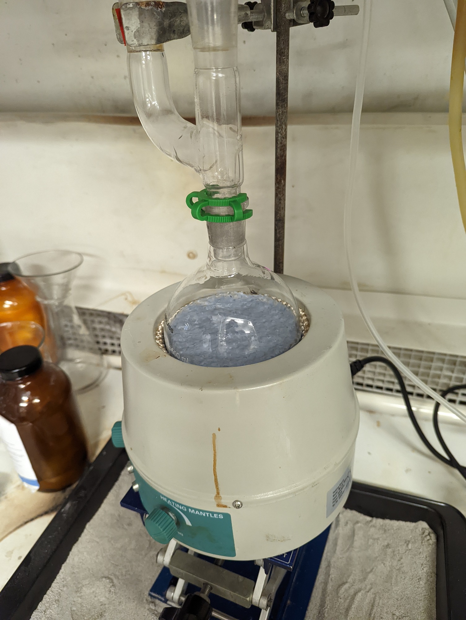

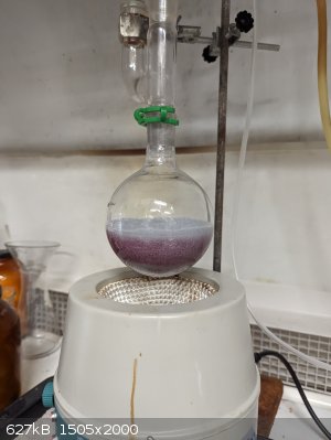

[*] posted on 25-7-2022 at 15:38
My K-Metal Synth looks a bit suss
Basically followed what DBX did but with a bubbler on top to monitor H2 production and I threw in a little K-Metal to dry it out (and protect the glassware)
Isopar as mineral oil
2mg Powdered Magnesium
10g KOH
Slice of K-Metal
Heated to 150deg C and held until H2 production slowed
Added 3mg Powdered Magnesium
Heated to 180deg C (just below reflux)
Added 2mL of T-Butanol in small additions (went blue here) over 30 mins
Raised to reflux (just over 180deg C) and held for about 1 hr (started going red/purple)
[Edited on 25-7-2022 by isoPaarden]
