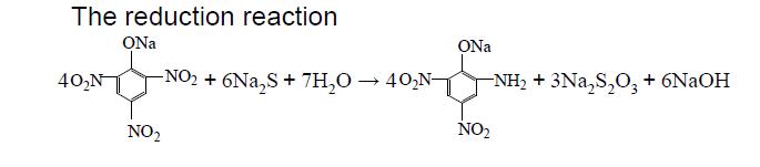

No you are still not understanding. The Na2S forms first when you are gassing NaOH with H2S and is converted to the acid salt NaHS by further saturation with H2S but the NaHS can be reverted back to Na2S by adding the needed Na equivalent as NaOH or NaHCO3. It isn't at all an excess of base that is reducing your yields IMO it is a deficiency of base for the NaHS being used for the reduction instead of Na2S being used. The reduction of picric acid to picramic acid is a misleading way of characterizing the reduction which is actually a reduction under basic conditions of a picrate salt to a picramate salt. What exactly is the pH range that is limiting for the monoreduction, I am not certain, but even under basic condition it is possible to go further than the monoreduction and form some byproduct diaminonitrophenol. This can occur even during reduction using glucose and NaOH when the reducing agent is in excess of the amount needed for the monoreduction. So the maximizing of the yield for the monoreduction will be dependant upon pH and time of reaction and temperature and the amount of excess of theory of reducing agent that is present and the concentration of the reaction mixture. All of these parameters will have to be fine tuned to maximize the yield. There are some additional references I will be posting.
It is odd that during the testing of reduction by glucose that the molar ratio used would not include the theoretical 6 moles glucose, and a bit in excess of theory like 6.5 or 7, but instead the charting of the reduction would jump from 5 moles to 10 moles, leaving everyone to wonder what occurs for the reaction dynamic in the near vicinity of the theoretical.

It is a convoluted imprecise description article that could have been written better, and it becomes obvious there is error for example 6 in table 1 where the ratio should be 1.15 to 1 and it looks like a transposing error from example 4 above in the same table. The arithmetic I did showed a ratio of 2.273 to 1 for what is shown on the table as 2.3 to 1 rounded. Anyway I think the patent I posted earlier about the reactions involved when gassing NaOH with H2S is absolutely correct that the Na2S forms first and this would square with other process chemistry studies which have shown the trend of higher sulfides forming first preferentially and then the sulfur value lowering as forced by conditions favoring change to what would ordinarily be a less stable sulfur compound under ordinary conditions. The sulfur compounds have varying stability particularly for solutions which are subject to instability after bottling and what begins as a pure solution of one sulfur compound gradually changes to an equilibrium mixture of various sulfur compounds and can even precipitate sulfur in the process of reaching an equilibrium. The composition of the mixtures that are formed is algebra that is affected by time and temperature. I was trying to get a handle on this to guesstimate what may be the best strategy for sequencing a dry method reaction of solid NaOH and solid sulfur with minimal water and calculating the dilution and temperature and time for reaction, sequenced with subsequent additions of added base as hydroxide or bicarbonate or carbonate as would produce an optimized mixture of reducing sulfur compounds for the Zinin reduction, where the byproduct would be soluble thiosulfate and no precipitation or minimal precipitation of free sulfur as byproduct would occur, and no sulfur dyes as byproduct with picramate would be an issue. I still think there is an optimization possible for such a sulfide route, but the algebra for achieving it would likely come down to trial and error. The math only is helpful so far, and it complicates things when the math reported by others is wrong for typos or editing errors, leaving a mystery to figure out. That's what we have here.
The appeal of the sulfide reduction is the concentrated reaction mixture and the rapidity and high yields possible at 98% or possibly even the quantitative yield is attainable.
And I think high yields are possible even using dry method produced polysulfide Zinin reagents which are not reported so far as I know except by me :D And maybe my math is not so good sometimes. I shall continue to scratch my head and think on this some more. But there are possible also interactions with manganous and ferrous salt used concurrently with sulfide, and variants that suggest quantitative yields are possible with the ferrous salt. The reference I posted regarding the formation of basic ferrous salts I think provides information which may be useful ultimately in a strategy to utilize the ferrous salt as a regenerable reducing agent, possibly regenerated even by sugar. Avoiding the sulfide entirely even though it is efficient is desirable since it seems to be a "nasty" synthesis leaving some impurity even in those procedures where a high yield is produced. A cleaner and more pure product that could still be easily synthesized is what motivates examination of the alternative methods.

There is a difference in the pH which is needed for the Zinin reaction to be favored depending upon the sulfur value or sulfur ranking of the sulfide employed, and yields can be optimized accordingly by varying the reaction conditions to accomodate the sulfide being used. It is necessary for that to be done so that apples and apples are being compared, rather than apples and oranges, when evaluating the "best obtainable yield" for a particular sulfide being employed for the reduction. The solvent system and the concentration and temperature and time of reaction are also factors along with the pH. There would need to be a broader more extensive study done to fairly compare the results gotten for use of NaHS and Na2S and Na2S2 or for complex polysulfide mixtures, with and without the concurrent use of ferrous and manganous salts, and I think the use of schemes involving two phase reaction schemes with organic solvents immiscible or partly miscible with the aqueous phase. There has likely already been proprietary studies done by industry since this is an old compound having been manufactured on a plant scale for more than a century.
There are general principles for optimizing Zinin reductions which are in general most kinetically favored for the disulfide reagent. However, there are exceptions to the general rule where one particular sulfide may be preferable as the anomaly for a particular reduction. Also the purity and the byproducts may differ for different choices and govern the choice for what process is most preferred, so that absolute maximum yield is a lesser priority, and other factors govern the choice of method. Reductions conducted under basic conditions produce a soluble thiosulfate byproduct, but for reductions approaching neutral or acidic conditions, free sulfur will be produced as a byproduct that can complicate purification of the desired product. So the economics of the process chosen will vary depending upon the requirements applicable to the quality of the desired product and its practical use as an intermediate for further reactions, and the purity requirement applicable there. For a dye intermediate there may be one specification, and for other uses a different specification may require a different process be used for producing a different specification end product.
As a note of interest, I was reading a description of Na2S-9H2O as being a *white* coarsely crystalline material having the appearance of rock salt, and being highly soluble like NaOH.
With regards to your H2S generation and saturating of an NaOH solution to produce the NaHS, there is a good measured indication of reaction progress and endpoint result gotten by weight monitoring of the reaction flask as described in the articles. The scales won't lie to you about what you've got. Possibly if you mean to maximize the yield, to increase 90% to 96%, instead of the NaHS being what you desire to produce by treatment of NaOH solution with H2S, that instead you may perform that reaction only to the midpoint, so that your solution contains the normal sulfide Na2S, then evaporate to obtain the crystallized hydrate. The added work involved may be poor economy so it is possible that the easier method producing 90% yield from an aqueous system is more desirable than the alternative method used to increase yield at the expense of more work.
Looking at the Hodgson and Ward article in light of the Hodgson and Birtwell article about the interactions of Na2S and NaHCO3 in methyl alcohol appears to be a scheme for improvising NaHS in situ which is the inverse of what I had guessed they were doing from the confusing description. I was on the right track but going the wrong direction, so it was actually the purpose of mixing Na2S and NaHCO3 in methanol to make NaHS by an alternative method to the separate synthesis of NaHS from a treatment of an NaOH solution with H2S from a gas generator. The Communications by Clayton article uses NaHS gotten from treatment of NaOH solution with H2S. But the Hodgson - Birtwell and Hodgson - Ward variation uses alternative method of producing the NaHS in methanol. Actually what I believe is achieved could be a hybrid method where a simultaneous Zinin reaction is proceeding where in part the reducing sulfide is NaHS and in part the reducing sulfide is Na2S and in what exact proportions is unknown. The hybrid scheme could actually serve to aid pH control by a kind of buffering effect, but I will have to again check the reaction schemes difference for NaHS and Na2S to evaluate that aspect. Evidently an effect of that nature is involved because of the yield increase from 90% to 98%, although the solvent methanol could also have bearing to an unknown extent. Further thought and analysis about this aspect is needed to fully understand the implications and what accounts for the 6-8% differing yields. Actually that range of difference is small enough to be within the range of variability that depends on how much skill by different chemsists is employed in conducting the synthetic process and manipulations. An under 10% difference range is within the variation range of tweaking and fine tuning so what may be significant as actual chemistry differences becomes less conspicuous.

[*] posted on 4-4-2014 at 09:03
It still seems logical that having the reducing agent being made up mostly of sodium hydrosulfide would be best. If you look at the reaction equation where sodium sulfide is used there is a mole of sodium hydroxide formed for every mole of sodium sulfide consumed. This seems to be the reason that sodium sulfide, when used by itself, results in such low yields. If sodium hydrosulfide is used as the reducing agent, the amount of sodium hydroxide in the reaction mixture will be kept very low since the sodium hydrosulfide (acid salt) will neutralize, or mop up, the sodium hydroxide produced by the reaction and form sodium sulfide in the process.
Still a little confused as to why sodium sulfide mixed with sodium hydrosulfide would actually produce higher yields than using just sodium hydrosulfide by itself.
Reaction equation taken from Chinese explosives presentation slides attached.
Sodium Picrate to Sodium Picramate Reduction Equation.jpg - 11kB
[Edited on 4-4-2014 by Hennig Brand]
