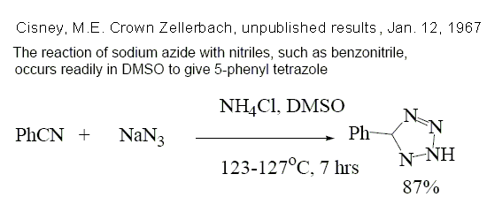

5 phenyl Tetrazole
The salient problem as I see it with high energy density nitrogen heterocyclic
compounds is the number of steps to synthesis. The following citation outlines
a synthesis of the Tetrazole moiety as depicted in the attachment below.
Apparently DMSO solvent facilitates higher yield.
5 phenyl Tetrazole
www.che.gatech.edu/ssc/images/pdf%20research/synthesis.pdf
Yields often are much higher under solvent free conditions. An advantage of
using no solvent (or less solvent), is that reaction times can also be shorter.
This baits the question whether acetonitrile can be substituted and provide a
facile pathway to the group described in this other paper here.
1 & 2 Methyl-5-Nitrotetrazoles
http://handle.dtic.mil/100.2/ADA099627 , refers to this next url
http://www.dtic.mil/cgi-bin/GetTRDoc?AD=ADA099627&Locati...
5 phenyl Tetrazole.GIF - 8kB
