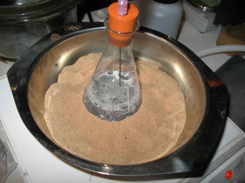

However to explain why I see a problem look at the volume of Mg in the pictures you just posted at the start of the experiment. Now at the end there
is a huge reduction in the amount of metal in the experiment presumably converted over to K. However I do not see any precipitate which there should
be a LARGE amount of if logic serves me correctly. Not only just large but given the fineness and fluffyness of inorganics precipitated in a non polar
solvent my instincts would tell me that that entire flask should be filled with a white precipitate yet as the reaction proceeds all im seeing is a
conglomeration of metal into shinny spheres and a total reduction in reactants volume with no explination as to where they are going. It also appears
as though the KOH flakes are untouched as though the metal has melted around them.
Even before pok answered that, I believe that’s very weak criticism. It’s very hard to estimate the amounts the ‘should be there’ just with
the naked eye. Pok’s answer is satisfactory to me.

I received my 2-methyl-2-butanol and my KOH today but my Shellsol (driectly from Kremer) may be stuck in the atrocious weather we're seeing over
Europe...
[Edited on 10-12-2010 by blogfast25]
plastics
Posts: 141
Registered: 6-11-2009
Like many on this thread I am intrigued and fascinated by Pok's work
My head says that this synthesis just cannot be possible but my heart is enthralled by the site of those beads of potassium metal
I have tried a couple of 'quick and dirty' goes at the synthesis myself using liquid paraffin without success. There is certainly initial generation
of gas after gentle warning and I am able to get the tert butanol to reflux successfully (see pictures). After a couple of hours I just end up with a
sludge of magnesium turnings and white powder (? MgO ? Mg(OH)2 this is definitely not the KOH flakes I started with)
I have now received some shellsol D70 from Kremer pigments and will try again over the w/e. For anyone interested I ordered the solvent from Kremer
and it arrived in the UK today (Friday) - not bad service
