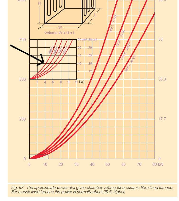

Attempting to make a furnace from Molydbenum Disilicide elements and insulating bricks. These elements can be driven up to 1800C giving a furnace temp. of around 1700. I will not be going even close to those temperatures. Coming from the kanthal handbook the diagram shows you how much power you need for a given furnace size. The diagram assumes a wool lined furnace. If you use bricks you must increase power by about 25% to get the same temperature. For a 10 cubic decimeter oven you need around 4 kW to get 1500C. (arrow on page).
If I were to use a double layer of bricks will I get much higher temperature?
My problem is I have only 2 kW worth of elements. I will have to make a smaller furnace that the 10 (if using single layer of bricks).
How much difference will a second layer of bricks make. I suppose this is not a simple question to answer. Any educated guesses welcome. I am unable to use heat transfer/modelling software.

[*] posted on 7-3-2018 at 21:04
My educated guess is that you will need 2.6 kW. I will give my assumptions and the derivation tomorrow. I am too tired now.
[*] posted on 8-3-2018 at 06:25
for the previous post, here is my analysis:
Assumptions:
1. The furnace is cubical.
2. Standard shaped bricks are used for the walls, floor and ceiling. The brick thickness is 2.25", or 0.0572m, the original wall thickness.
3. Thermal conductivity, k, of the bricks is 1.04 W/m*K.
4. The internal cavity of the furnace is cubic, 0.215m on a side, W1.
5. The internal cavity temperature is 1500°C.
6. Furnace outer surface is 100°C.
7. The original furnace requires a heat source of 5 kW.
8. The furnace is modeled per the example shown in Chapter 3, example 3.39, p.160, of "Engineering Heat Transfer," 2nd ed, by Rathore and Kapuno, jr. found at books.google.com.
https://books.google.com/books?id=ERtpN94lCOsC&printsec=...
Original furnace ( case 1) computations:
(i) conduction shape factor, S1 = Swall + Sedge + Scorner
w1 =cavity width =cavity length = cavity height = 0.215m.
L1 = wall thickness = 0.0572m.
S1 = 6(0.215m)(0.215m)/0.0572m + 12 (0.54)(0.215m) + 8(0.15)(0.0572m)
=6.311m.
(ii) actual heat loss = 5kW
compute heat loss, Q1, = kS1(delta T) = 1.04(6.311)(1400) = 9.19 kW
For the furnace with a 2nd brick layer:
L2 = 2L1 = 0.430m
shape factor S2 = 6(0.215m)(0.215m)/0.114 + 12(0.54)(0.215)
+ 8(0.15)(0.114) = 3.96
Q2 =1.04(3.96)(1400) = 5.77kW
Using proportions to get the heat loss:
(5.77kW/9.19kW)5 = 3.14kW for the furnace with the added bricks.
[Edited on 8-3-2018 by Magpie]
[Edited on 9-3-2018 by Magpie]
yobbo II
Posts: 820
Registered: 28-3-2016
[*] posted on 8-3-2018 at 20:10
Thanks alot Magpie.
Another (rather complicated) route to get high heat from the 2 kW worth of Moly Disilicide (super kanthal) might be to place nichrome (super kanthal A1 say) wire around the 'first layer' of bricks and keep their outside surface at (say) 800C. The second layer of bricks then goes outside this inner chamber. The moly Disilicide then goes into the inner chamber to put temperature way up.
Is this a crazy idea?
Note: it is easy to mix up Super Kanthal A1 (high spec. 'nichrome' wire) with Super Kanthal (Molybdenum Disilicide)
Yob
[*] posted on 8-3-2018 at 20:30
You are welcome.
That should work.
I tried to calculate the wall thickness for a loss of 2kW directly but the shape factor calculation broke down, so can't do this.

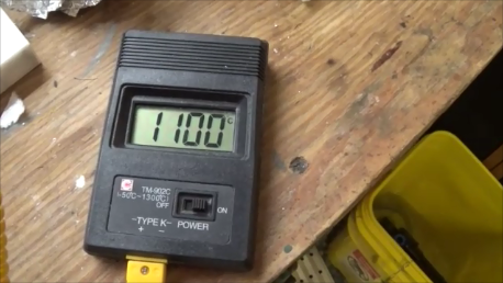

I just built a tube furnace which is capable of reaching 1100 C.
The heart of the furnace is an alumina tube, 25/20/200 mm (OD, ID, length). This cost me about $15. Around it I wrapped around 100 turns of 22 gauge nichrome wire, which took around 8 meters. Cost of nichrome was $2. Then I painted on two thin layers of high heat mortar. The first was just enough to keep the wire in place, the second a little thicker and covered all the exposed wire completely. I bought a 10 ounce tube of the mortar but only used ~5% of it, for a cost of $0.25. While letting it cure, I cut a section of 4 inch duct slightly shorter than 200 mm. I also cut some caps for the duct out of aluminum flashing (adding holes for power and the tube itself in the middle). I already had these materials, but they would cost ~$5 to buy. I then wrapped the tube with a ceramic fiber blanket. It took about one square foot of 1/2 inch thick ceramic fiber to make a good fit. This was rated to 1300 C and cost $3.50. The final part was putting everything together with a couple of large hose clamps ($3).
Total cost: $28.75
The insulation works well, it only takes ~80 watts to maintain the temperature at 1100 C. The outside gets hot but it's not too bad, especially considering how hot the interior is.
Tubef1.png - 150kB Tubef2.png - 78kB 1100C.png - 180kB
