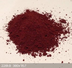

Carried out the synthesis of potassium tetraperoxochromate(V) the other day, and it went pretty well. I obtained a nice quantity of very dark red-brown (almost black) crystals. This was my second time performing the synthesis; the first time I got a fine crystalline red-brown powder, which I assume to be the exact same compound, but with smaller particle size. Below is a pic of the solid from the first synthesis: (the second is still drying)
Screen Shot 2015-04-06 at 1.12.00 AM.png - 228kB

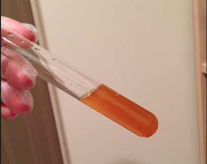

However, I also found that adding 30% hydrogen peroxide to a solution of the tetraperoxochromate produced a dark, maroon coloured solution that slowly evolved oxygen gas. This solution seemed stable for quite a length of time, but after I left it for a while I found that it had decomposed back into a solution with the same colour as the original tetraperoxochromate solution. I then added some HCl to the resulting solution and found that it followed the same behaviour as the original tetraperoxochromate solution in the formation of the blue peroxo complex. (yet this did seem to linger around longer before decomposing. Not exactly sure what happened, but I'll be sure to repeat it when I get the time)
Below are pics of the maroon solution generated by the addition of hydrogen peroxide to the tetraperoxochromate and the original tetraperoxochromate solution for comparison
Screen Shot 2015-04-06 at 12.48.28 AM.png - 125kB Screen Shot 2015-04-06 at 12.49.27 AM.png - 134kB

I have never seen such a deep red solution from a chromium peroxo complex. It apparently only exists at very high concentrations of H2O2 and at the right pH. Do you have any Ba-salts? It might be interesting to see whether you can precipitate some Ba-salt of this. The solution must be very dilute if you started from K3CrO8, so it may be quite difficult or time consuming to precipitate the barium salt.
What happens on dilution. Does it keep the red color, or does it turn yellow/brown?

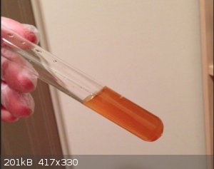

[*] posted on 7-4-2015 at 20:15
Upon dilution the red colour seems to be maintained.
Below are thee pics; the original tetraperoxochromate solution, the concentrated dark red solution from hydrogen peroxide addition, and the dilute solution.
Screen Shot 2015-04-07 at 11.57.34 PM.png - 201kB Screen Shot 2015-04-08 at 12.02.40 AM.png - 113kB Screen Shot 2015-04-07 at 11.58.02 PM.png - 149kB
The concentrated solution evolved oxygen at a much quicker rate with respect to the more dilute solution.

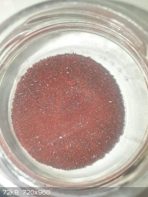

A mixture of crystals and powder.
received_785261648865589.jpeg - 72kB

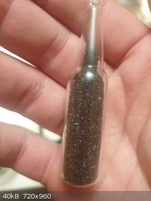

Small crystals
received_473480217000430.jpeg - 40kB

[*] posted on 1-2-2021 at 05:00
Definitely much more red than mine. Interesting to see the color differences.
Do you still have some outside of your ampoule? Take a small amount and put that in a test tube (really small amount, just the tip of a small screwdriver) and then heat the test tube over a flame. It should decompose with a single POP sound (explosive, not burning).
Last weekend I made a little movie of the explosion with my high speed camera (I have a camera, which can do 1000 frames per second at just over 1000x380 resolution, with shutter times on a per frame basis of 1/12800 second). With this camera I found out that the decomposition reaction of K3CrO8 is really fast. I just have the same image in my video, and then in one frame, you see a gentle haze over the solid material, and in the next frame all is gone and there is a yellow smoke, filling the lower 5 cm of the test tube (yellow color is due to K2CrO4). So, the decomposition takes somewhere around 1 ms. It is accompanied with a loud POP sound. For this reason I tell you to take only a tiny amount of K3CrO8 for this experiment. You don't want shattered glass flying around your ears.

[*] posted on 1-2-2021 at 08:31
Woelen, Unfortunately now I only have crystals in this ampoule. All gifts to friends who can not synthesize at home. I have tested it many times. The crystals explode like popcorn and jump into the air. As you said it takes on a yellow color. I mixed the sulfur a few times and it made a very loud noise. Interesting because I just put the mixture on the air, however if it is not like a hill, then it explodes like gunpowder.
