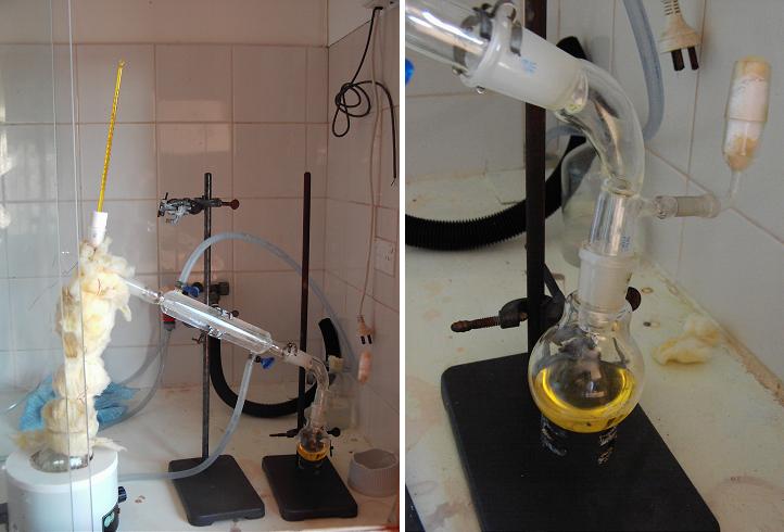

    Step 1 - formation of S2Cl2 from the elements
    This procedure is borrowed from Schlessiners "Inorganic Laboratory Preparations" - with the procedure in Brauer judged unsuitable. 100 grams of garden-grade sulphur were charged into a 250ml flask, into which dried Cl2 from the TCCA generator was fed at a rapid rate (about 5 bubbles/sec = 1 drop 15% HCl per 2 secs onto TCCA in 1L flask). The Cl2 was dried with a small dehydrated CaCl2 plug, and then bubbled into H2SO4. The H2SO4 bubbler was deemed suitable as contamination with H2SO4 spray in this case is of little relevance, as the product will be sulphonated in any case. A water cooled condenser led to a 250ml collecting flask - with the exhaust gases vented to a NaOH solution. When the sulphur melted the Cl2 delivery tube was lowered almost to the bottom of the flask (as otherwise it would not introduce the Cl2 below the S surface once a substantial amount of product had evaporated) and the walls of the flask were soon covered with at first yellow, and later red drops. See picture below
    <IMG src="http://www.sciencemadness.org/scipics/Len1/SOCl2_fig1.JPG">

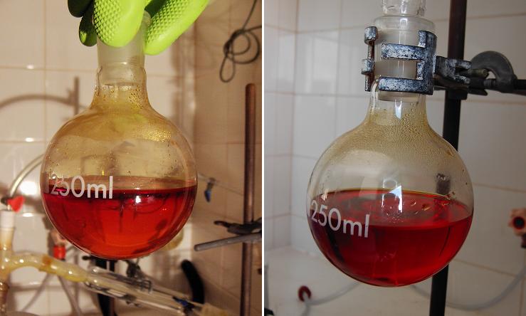

    After an initial lag (when the S2Cl2 product dissolved in the sulphur) drops of yellow/orange fluid started to gather in the receiver (about 1 drop / 2 sec). A 40% duty cycle on the controller ensured a steady flask wall IR temperature of 220C. Testing with conc. NaCl solution showed no Cl2 was passing the flask uncombined. After about 400ml of HCl had been added (90mins) the boiler flask was bone dry and completely empty, save for a few black particles of soot. The receiver flask was half-full of an orange solution, which as soon as no distilate was coming over immediately started to redden from the surface, and feeding proressively down, due to formation of red SCl2. See picture below.
    SOCl2_fig2.JPG - 51kB
    The generator was stopped and flask weighed at this stage - total product weight was 208 grams, giving a yield of 98% based on sulphur. Considering almost no Cl2 escaped, this provides very strong support for S2Cl2 being the formula for the component boiling below 220C.
    SOCl2_fig3.JPG - 45kB

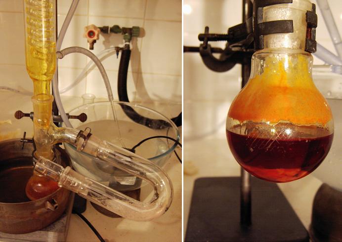

    Step 2 - dissolution of Cl2 & formation of SCl2.
    S2Cl2 has very high density (about 1.7) so 71.9 grams of the product from step 1 were weighed into a 100ml flask placed in an empty vessel to allow cooling of the contents (this increases the solubility of Cl2 as with all gases). A small amount of steel wool (< 100mg) was dropped inside the flask. The outlet of the reaction flask was protected from moisture with a CaCl2 plug and an H2SO4 dried stream of Cl2 was passed in as before at the rate of 4-5 bubbles/sec.
    SOCl2_fig4.JPG - 53kB
    The colour of the liquid started to redden almost immediately - at the end it looked almost black (due to depth of colour, thin streaks were still red). While there were some perturbations on the surface of the sulphur chloride initially, no gas was seen to exit the flask. The contents warmed to about 36C, when water was added to the pan which cooled the flask to 20C. At this stage the reagent surface was calm despite furious bubbling in the H2SO4 drier. Some perturbations began to appear on the sulphur chloride surface again when the weight gain of the flask corresponded to a stoichiometry of SCl2 - this could be used to determine when to stop the addition. Some red condensed drops of SCl2 also became evident in the upper parts of the flask, carried there by the Cl2 flux, and showing that as opposed to S2Cl2 the SCl2 compound has a low b.p. At this stage the weight of the product had risen to 109.8 grams so 37.9 grams of Cl2 had been absorbed. The stoichiometry of the solution therefore corresponds to SCl2.002. The iron wool was extracted from the solution, and was found to be completely uncorroded - except for a dark-black surface sheen.

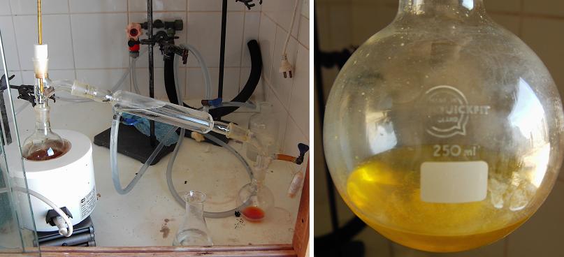

    Step 3 - oxidation of SCl2 to SOCl2

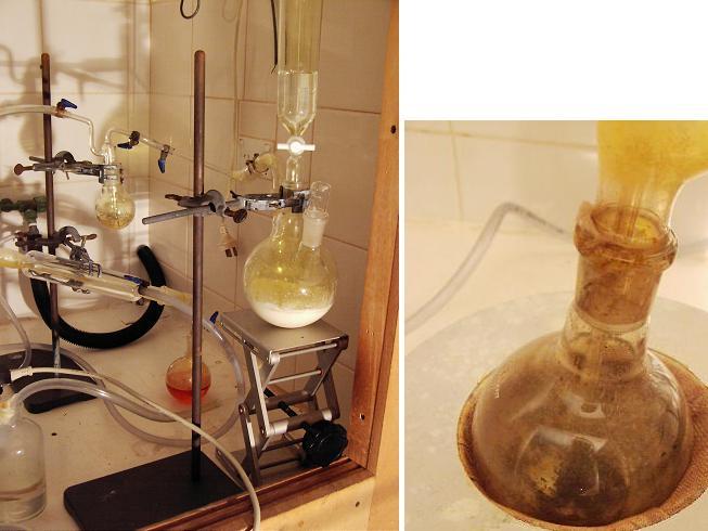

    The procedure from Brauer was employed for this with a few modifications. Essentially the SCl2 is placed in a cooled vessel attached to a reflux condenser and SO3 is added. Although some sources quote direct dripping of 65% oleum into the SCl2 reagent, this introduces substantial useless water into the reaction, while evaporation of 65% oleum is wasteful of SO3 (the b.p. of 25% oleum is already 140C) hence 90% SO3 made using the SO3 Illustrated Guide, was evaporated into the SCl2. Due to the low b.p. of this material a heat gun was applied directly to the U-tube containing the SO3. Brauer recommends using H2SO4 to prevent ingress of moisture into the refluxing mixture - however this is quite inappropriate as very little SO2 is evolved immediately and the temperature inside the vessel fluctuates enough (initial heating followed by natural cooling) to create the real possibility of suckback of the H2SO4. A CaCl2 tube was employed in its stead. The cooling vessel consisted of an iron pan placed on a hot-plate - this way after the addition of SO3, which produces heating, is complete, reflux could be maintained by external heat. The setup is seen below.

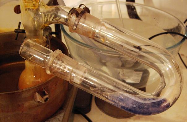

    SOCl2_fig5.JPG - 50kB

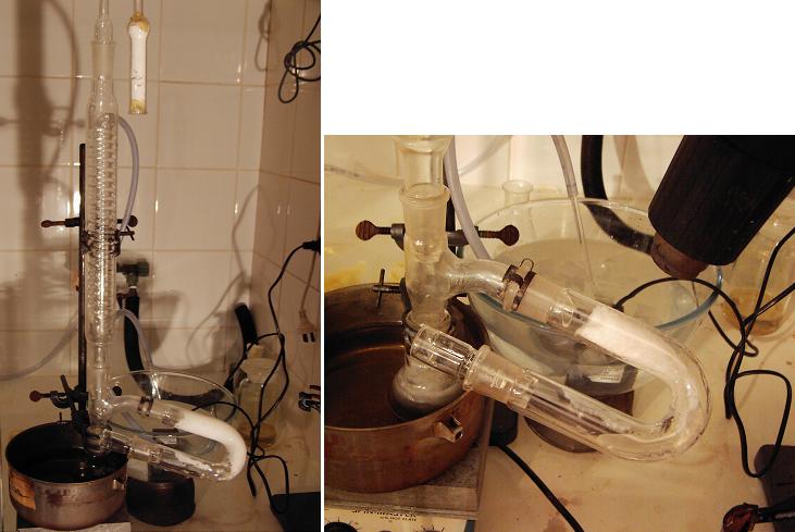

    There is the danger here that if the SO3 at the bottom of the U-tube is heated to boiling before the SO3 at the top had melted, a major part of the U-tube contents can be ejected under pressure into the flask containing the SCl2. Hence the tube is heated evenly, strating from the top, letting that section melt, before working further down, until all contents are molten and at the bottom of U-tube. Soon the SO3 starts boiling, and dripping into the SCl2 containing flask. Drops of the condensing SO3 as well as SCl2 start refluxing and the condenser insides become yellow due to Cl2 and SCl2 vapour being released by the heated mixture. Sulphur also starts precipitating on the flask walls, inside the condenser, and inside the flask, slowly sinking in a lump to the bottom. This is what Brauer meant by 'the contents of the flask might solidify'. The excess chlorine liberated started eating at the precipitated sulphur on the walls (in a repeat of the S2Cl2 formation reaction), so we in effect have a perfect demonstration of the two equations from the theory section, showing that this is the main reaction mechanism
    S2Cl2 + SO3 -> SOCl2 + SO2 + S
    2S + Cl2 -> S2Cl2
    SOCl2_fig6.JPG - 53kB

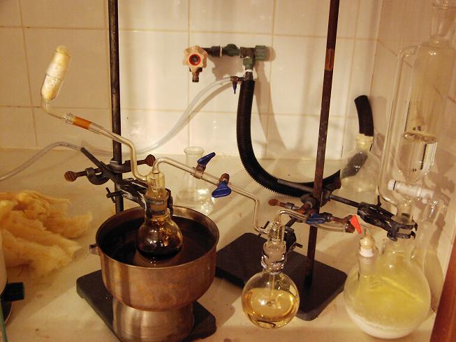

    Once sufficient SCl2 refluxed and SOCl2 formed there was some dripping of this back into the SO3 vessel, where together with excess SO3 they combined into a deep blue liquid compound - see picture below. As the chlorosulphonic anhydride S2O5Cl2 is supposed to be colourless, I am not sure as to the composition of this substance formed when SO3 is present in excess.
    SOCl2_fig7.JPG - 44kB
    Once all the SO3 had been added, the mixture was refluxed at 80C for half an hour. Upon cooling some of the sulphur had cleared. The mixture was then distilled. As soon as the temperature is raised the receiver and condenser are filled with free chlorine, which has the effect of dissolving any sulphur deposited on the flask walls. A key point Brauer doesnt mention, is that even with the SCl2 being in excess not all SO3 is converted, so the first distilate is SO3 boiling at 44C and not condensing very well. The distilate must be vented outside. Next the thermometer jumps to 59C and a red liquid comes over - this corresponds to the characteristics of SCl2. The temperature then rises to 75C while a few ml of reddish liquid comes over. Most of the fraction comes over as light yellow drops in the range 75-95C range, which redden as free chlorine passed over it. Sufficient S was then added to convert the sulphur chlorides to S2Cl2,
    SOCl2_fig8.JPG - 39kB
    and the product distilled through a lagged collumn. There was no lower b.p. compound this time, as soon as some liquid had started coming over the temperature shot up to 76C and did not rise to more than 78C before no more distilate came (the mantle was operated at 25% duty). The sulphur, and some terribly smelling highly sulphur chlorides stayed in the boiler. The distillation was probably still a little fast, about 2 drops/sec. A total of 59 grams of a light yellow liquid smelling of SO2 and S2Cl2 had been obtained from 64 grams of SO3 added, the 109 grams of SCl2 being in excess. The yield based on SO3 is then 62%.
    SOCl2_fig9.JPG - 47kB

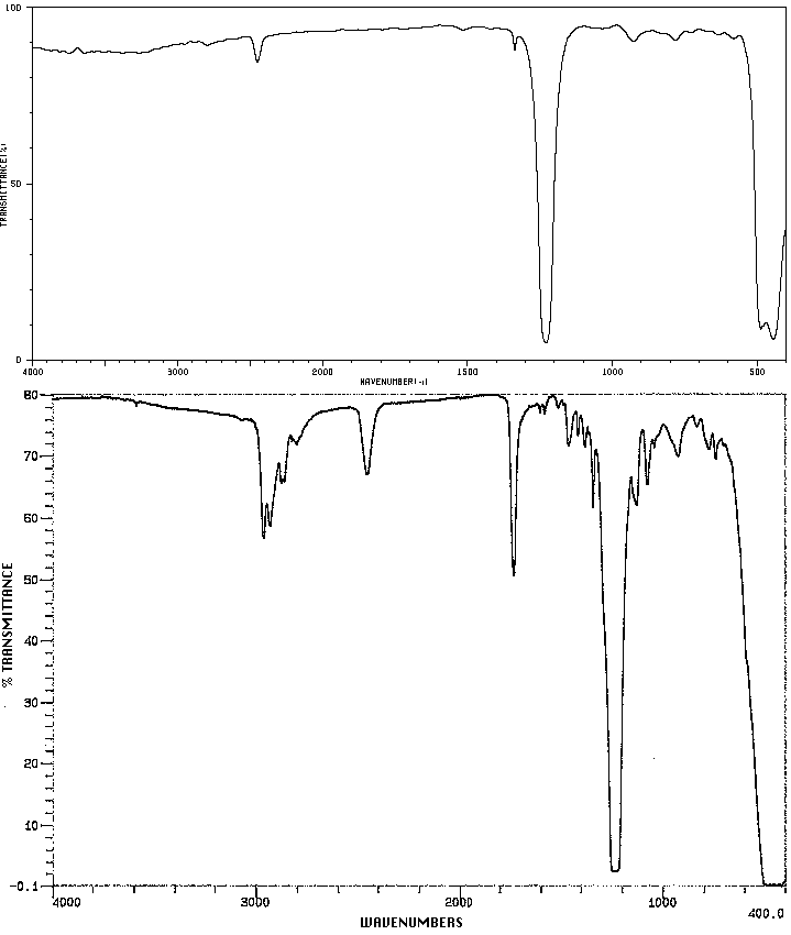

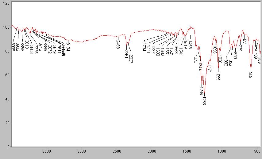

    An IR spectrum of the product is shown below compared to the following IR spectra in the literature. As can be seen substantial impurities are still present in the SOCl2 due to the difficulty in purifying this compound of sulphur chlorides. The reference spectra manifest this problem too - being sufficiently different from each other. This is characteristic of a product exhibiting some instability, so its compoisition varies with time and with different sources. It should also be mentioned that due to traces of SO3 present in the sample, which reacts with atmospheric moisture to form H2SO4, a reaction with the KBr window of the FTIR sample card produced some spotting of the KBr window, which could have led to some of the artifacts observed. The product should be washed in quinoline to remove the acids and distilled from linseed oil as mentioned in Vogel, however due to a lack of the former this process has not been carried out at this stage.
    SOCl2_fig10.JPG - 39kB
    SOCl2_fig11.GIF - 11kB

    I still am not happy with the result while the IR spectrum is not a perfect match. So I guess the next step is quinoline synthesis, as I cant buy it anywhere - Skraups synthesis looks a beauty in its own right!

    BTW Len, is that glass wool your using to insulate your distn head? I've tried using plumbing insulation, but it's not pratical to fit around the setup...
    And how much TCCA did you use for your first chlorination?
    I like your idea of using the U-tube to transfert the SO3, i find it pretty clever. Do you have schlenks? You could try collecting the SO3 in a small schlenk, with a claisen to attach a condenser above it, then connecting it to your SCl2 still, and use a light flow of argon with a little heating of the schlenk to transfert the SO3 in a graduall way. Using the U-tube in a similar way might eject big pieces of SO3 if it clogs up though.. Just a idea.

    Klute, yes it is glass-wool, you can get bags of several cubic meters, and it stands up to 800C! Very useful stuff. I seem to remember European hardware stores also carrying them.
    The TCCA was 200gms, thats of course a bit excess - I just break up one pellet and put the lot in. Its enough for 2 moles of Cl2 and uses about two 250ml charges of 15% acid. Theres an error in the text (which due to Polverones kind modification of the forum) I can now change - 100gms S gave 208 gms of product.
    Alas I dont have any schlenks. The first time I heard of them was in your posts. I might now acquire some. I am a physicist by profession (you I presume are a chemist) so the only chem labs I worked in are ones attached to phys labs - and they never had such apparatus (or canulas for that matter).
    I was concerned about the U-tube ejecting a major part of the contents under pressure - as you say. I heated from the top, and waited till that section melted before working further down, until all contents were molten and at bottom of U-tube. Thanks, I shall change the description as its important for safety.

    I notice that you use what looks like a long Graham condenser for refluxing. Is that by intention or is that just what you have on hand?
    I have a shorter Graham but it does not have ground glass fittings, so have never used it - it's an antique, given to me about 40 years ago. My West condenser (similar to a Liebig) has the gg fittings so that's what gets used.
    I don't even have a U-tube. You have indeed put it to some interesting uses.

    Here its the technological nineteenth century - I have to use what I have at hand - any working improvisation will do. Im sure a West will work fine, I have only a Leibig.
    I have just found out that I cant get aniline unless I want it for work. So to get to quinoline, to purify the SOCl2 its going to be a long haul from sodium benzoate, potassium nitrate, tin, and glycerine.
    The U-tube is a relic from the SO3 experiment, where its perfect for batches up to 100grams in ensuring perfect condensation in the receiver and not the condenser. If a flask is used in its stead, some condensation will occur in the condenser (because of SO3 vapour flux directly through the flask), and then you have to get it out of there by passing hot water through the coils - something I wanted to avoid. You could also transfer the SO3 from the U-tube to the flask - but again the less operations with SO3 the better!
    [Edited on 21-4-2008 by len1]

    Is that in fact a Grahan or is it a spiral reflux condenser? A Graham really is not so appropriate for reflux because of the narrow bore. A spiral reflux condenser is great, particularly the double walled sort. Lots of condensing surface and therefore capacity.
    Sic gorgeamus a los subjectatus nunc.
    [*] posted on 21-4-2008 at 08:12
    Good point Sauron. It does indeed look like the cooling water goes through the coil.
    Below is a picture of my Graham where the cooling water is in the jacket instead. That's the box in which I received it, mislabeled as "CONDENSER, Liebig's." The distributor is Central Scientific Co (CENCO) which in the old days seemed to be the mother of all scientific equipment.

    As far as Im aware theyre both called a Graham condenser - here the second type with the water in the jacket is also called an inland revenue condenser, and is good for hard-to-condense gasses such as ether (where I used it). It would be completely inappapropriate, even dangerous as a reflux!
    I do not have a West. When such i required I use a Leibig.

    Graham condensers have a very narrow bore and are usually used only for vacuum distillations where the vapor path is through the narrow-bore (5mm or so) spiral. They have a pressure drop across the spiral.
    The condenser in which vapor passes through the outer portion and coolant through spiral isn't a Graham, it's just a spiral condenser, and effectively it's a shortened, but very efficient, reverse of a Liebig. It is also possible to have an outer jacket with coolant, further increasing the cooling capacity.
    The West is same as Liebig except that the jacket is close to the core diameter so coolant velocity is increased for any given rate of flow.
    The Graham would be utterly inappropriate in any application where vapor can solidify. Liquid condenses in lower part of spiral if used diagonallu and has to be pushed through, causing back pressure. So for delivery the true Graham is best used vertically.
    Wide bore Grahams are possible. But I have never seen one., The only condensers I have ever seen with wider bore coils are Buchi multi-cpol rotavap condensers, and the coolant flows through the coils. The desktop ones have two coils, and the 20 L and larger models have at least 3 coils, and the option of using two such condensers in series (Buchi E-type setup) for maximum condensing rates. I own a 20 L Buchi R152 with such a setup.
    I would have thought SO3 would have been a no-go with a Graham, unless of course you kept coolant above the mp.
    But obviously, you are succeeding, and therefore, all I am doing is kibbitzing. I really only meant to clarify Magpie's remarks.

    Graham condenser
    A Graham condenser has a spiral coil running the length of the condenser. There are two possible configurations for a Graham condenser. In the first, the spiral contains the coolant, and the condensation takes place on the outside of the spiral. This configuration maximizes flow capacity since vapors can flow over and around the spiral.
    In the second configuration, the jacket tube contains the coolant, and the condensation takes place inside the spiral. This configuration maximizes collected condensate, since all the vapors must flow through the entire length of the spiral, thus having prolonged contact with the coolant.
