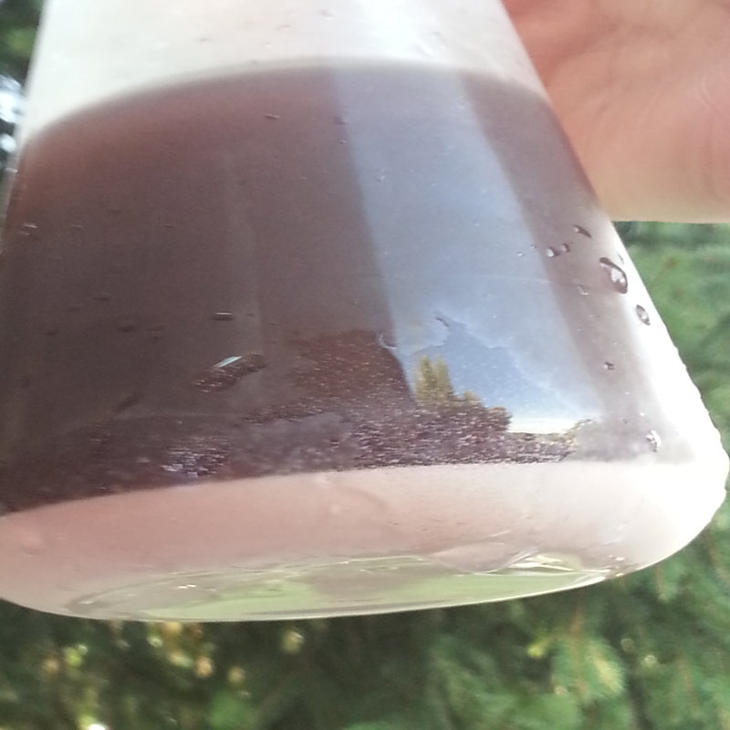

[*] posted on 18-6-2016 at 08:12
I know this thread has been inactive for a while, but I'm experiencing something weird running the sulfonation reaction and I wonder if anyone has had the same thing- the reaction starts off in the usual way, with the light pink/purple slowly giving way to a dark purple/black solution, but at some point a couple hours in, the reaction mixture solidifies as a blueish grey concrete-like mass. This is strange because it happens extremely rapidly; from the time it begins thickening to the time it hardens completely is usually less than five seconds. This not only results in no yield, but is a real pain to clean out of glassware. I've been using enoz moth flakes that claim to be 99%+ naphthalene, but I'm wondering if this might be false. I haven't found anything in the literature that would indicate what could be happening here (there doesn't seem to be much out there in general about synthesizing the 1-naphthalene sulfonate salt), has anyone had this happen to them?
Edit: On further examination I've found what may be the strangest part of this- it only happens when being stirred. When I've used a thermometer (the first attempt) or a jury-rigged mechanical stirrer (the second and third attempts) it solidifies. When I covered the beaker with Saran Wrap and just left it in the sun all day, the reaction proceeded pretty much as it did for previous people in this thread, albeit with a low yield. Strange
