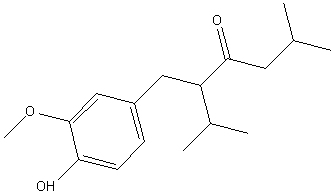

This is a beautiful synthesis with acetone, but I wanted to try with vanillin a variety of other ketones to create a variety of zingerone analogues.
But I am running into difficulty with my first variation.
2,6-dimethylheptan-4-one (diisobutyl ketone) is not water-miscible as is acetone, so the initial aldol condensation is slow. Stirring the mixture for two days only produced about 5% of a second product by TLC, and refluxing (at 163 degrees) produced a lot of tarry gunk.
I wonder if anyone has any recommendations.
Options might be to repeat with an excess of some solvent... methanol or ethanol, or maybe to try an acid-catalysed aldol. But I am unfamiliar with this route.

[*] posted on 15-1-2010 at 11:26
Use NaOH in MeOH instead of NaOH in H2O, and only 3-fold excess of the ketone (instead of the ~6-fold in acetone example).
The reaction will have to be monophasic or else all the vanillin sticks in the aq. phase in the form of the phenoxide, and because diisobutyl ketone is not particularly soluble in water the reaction might never go anywhere. If you still have the reaction mixture you might try adding a quat PTC catalyst and stir vigorously at 40-60°C.
The product would be a compound not yet described in the literature, so I can not help you with a literature synthesis. Due to the alkyl branching, it is possible that the product will be either a viscous oil at room temperature or a hard to crystallize solid, in which case you will have to find an alternative work up instead of the recrystallization described above. Flash chromatography anyone?

[*] posted on 15-1-2010 at 12:01
Right, so redo in a big excess of MeOH.
Do you have a review of acid-catalysed aldol, or can you offer any comments?
Well, the new spot (Rf 0.77) was only just visible as a UV-absorbing spot wheras vanillin (Rf 0.71) was huge. Solvent CHCl3/MeOH/H20 74/15/1. Calling it 5% is a guestimate.
Edit:-
5g vanillin, 4g NaOH, 50 ml DIBK and 500 ml MeOH formed a clear, very light yellow homogeneous mix. I'll check it daily and post any results.

Paddywhacker
Posts: 478
Registered: 28-2-2009
[*] posted on 17-1-2010 at 13:14
Progress report. The yellow colour intensified over a day at ambient temperature, but seems not to have gotten any darker after another day. At 2 days there is still only vanillin by TLC (Rf 0.54 with hexane/EtOAC 50:50) by UV. Nothing by iodine stain. Should I wait longer or reflux, or try again?
I was interested to note that there was no sign of Cannizzaro with the aromatic aldehyde.
Thanks for the advice. This counts a small-scale to an oldschool chemist like myself, but I really should get with the microscale program.
Medchem, this zingerone analogue looked accessible, and was not listed according to chemspider, and SAR is an endlessly fascinating crapshoot, so this it was.
Methyl isobutyl ketone is less hindered then the DIBK that I used. Maybe I'll try next with that, but I don't like to be an early quitter.
Final report, 02 Feb 2010:- I figured that I was led astray by the compound co-eluting with vanillin on the TLC and worked it up.
The intermediate had a melting point of 74-76 Celcius.
In-situ reduction with zinc powder and acetic acid in ethanol with Pd/C catalyst gave an oil that recrystallised from ethanol in the freezer but remelted at room temperature. A dilute aqueous mouthwash did evoke a hint of ginger.
Without instrumental characterization, of course, I might have nothing except contaminated vanillin. I will try and get an IR spectrum once university starts.
