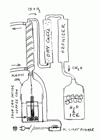

There has been continued interest here in production of Formaldehyde
http://www.sciencemadness.org/talk/viewthread.php?tid=132
http://www.sciencemadness.org/talk/viewthread.php?tid=525
http://www.sciencemadness.org/talk/viewthread.php?tid=5993
The established method of production is by partial oxidation of Methanol vapor
in air against a silver catalyst at 450 - 650 ºC , yielding formalin
2 CH3OH + O2 => 2 CH2O + 2 H2O , containing unreacted methanol.
The following known pathways suggest another method of preparative value.
An electric arc passed between carbon electrodes under water consumes
the electrodes C + H2O => CO + H2 forming water gas.
A mixture of CO + H2 under the action of dark (silent) electric discharge
yields formaldehyde => CH2O
The first process has been known a long time , it's mentioned on page 485
as a Preparation of Carbon Monoxide in
" A Treatise on General and Industrial Inorganic Chemistry " 1920
http://books.google.com/books/download/Treatise_on_general_a...
More recently rediscovered as a means of coal gasification , the important thing
is not the claims made by the promoter , but that the production of CO + H2 is
plentiful and abundant depending only on the amount of electric power consumed.
http://www.blazelabs.com/n-aquagen.asp
http://www.blazelabs.com/n-newfuel.asp
The next process combining CO + H2 into Formaldehyde is somewhat obscure.
It is simply an ozonizer aparatus which is instead infused with CO and H2.
Seemingly , no one realized the water gas process complements co-generation.
This is difficult to make right , results are mixed , only some have seen success.
Interaction of Carbon Monoxide and Hydrogen Under Silent Discharge:
Production of Formaldehyde - http://www.springerlink.com/content/q2k5754wk726t676
http://resources.metapress.com/pdf-preview.axd?code=q2k5754w...
http://www.fischer-tropsch.org/Bureau_of_Mines/abs_of_lit/li...
Losanitsch and Jovitschitsch , Ber., (1897) 30, pg 135
Löb , Z. Elektrochem., (1906) 12, pg 282
Koenig and Weinig _ http://www.fischer-tropsch.org/Bureau_of_Mines/abs_of_lit/li...
A basic setup would be a carbon rod greased with vaseline to make it electrically
insulated , standing in the open end of a metal can in proximity to perhaps 40 cm
of granular metalurgical coke in the bottom , submerged in a half liter of water. This
can stands inside another canister filled with water running into it to provide cooling.
The can is grounded corresponding to the electric socket ground and the carbon rod
is the hot wire. Electric power is regulated by a small choke in series with the circuit.
A cutoff plastic soda bottle top fits over the inside can so that it is air tight. The
opening runs the gas produced into a chilled reflux column intended to stop water
vapor. The gas is further dried by passing through a container of Calcium Chloride
" ice melt salt ".
The dry gas now enters the " ozonizer " to be converted into Formaldehyde , from
there directly absorbed into a receiver holding perhaps a liter of chilled water. The
entire device will have been initially purged of all air containing only water gas. As
the Formaldehyde formed is continuously dissolved providing a partial vacuum , the
positive pressure of the water gas formed drives the flow toward the reciever. The
beauty of this is that no metering of the CO , H2 gas is required since it is produced
quantitatively in the exact proportion necessary at the source. The gas flow must
be turbulent to prevent separation , as Hydrogen is less dense than CO.
If one wants to produce hexamine directly , the receiving liquor can contain a
solution of Ammonium Sulfate , which should precipitate Hexamine di-sulfate.
Important - Carbon monoxide being an odorless poison gas requires a detector
of it's presence be close to the setup when it's run to warn of any leak. These
are available in hardware stores for around 50 - 60 dollars. Failure to take this
prcaution means you may never wake up.
Eclectic

I was asked to sketch the apparatus I proposed above
