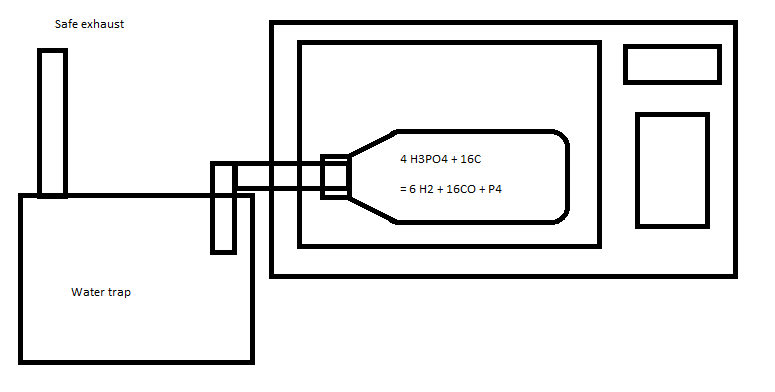

This is most interesting. I was thinking of making magnesium silicate retort (MgOH + SiO2 = MgSiO2 etc.), which is supposed to be transparent on the
microwaves and has a melting point of 1900C and is regarded as having high resistance towards chemicals in high temps. Options are to use direct
heating with coke up to 1600C, or then applying the microwave.
The problem with the microwave seems to be the reaction energy. The patent cites that they were able to produce about 2 grams in 2 hours using 1kW of
microwave power. This is far off scale of what would be feasible even for amateur.
Essentially my concept is of magnesium silicate "bottle", which would have, probably solid fitted steel tubing retort which would be impregnated
underwater. This pot would be placed within microwave, or then into coke bed and fired up. The gases would be led into the water tank aside the
hopefully forming phosphorus, and the waste gases would be safely exhausted via meters long chimney up to the skies for the birds' and green partys'
trouble.
Though phosphine is denser than air, it should be destroyed in situ. This provocates the need to lead the exhaust gases via tubing and bubble them

I was thinking of something like this:
Just essentially a refractory ceramic (MgSiO is best afaik, ceramics are higly transparent to microwaves) bottle, most likely DIY, with steel tube
attached to the mouth and aligned down to water trap. The williepete will melt at 44C and evaporate at 280C and the reaction heat should be sufficient
to allow it to condense and flow into the tube, the vessel preferably aligned few degrees down so the liquid phossy will flow out. The reaction vessel
will be filled with copious amounts of CO and H2 and it will dispace any air present long before wp is produced.
