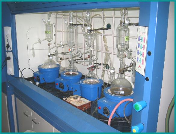

I'm interested in the idea of making SPS systems for home use. They're not complicated at all and the pressures are very low. You can easily buy cheap stainless pipe rated to 4000psi, and these are running at 15.
The only complaint I've seen against these is having the column repacked. But that seems to require 6 months to a few years of use in full scale uni / chem labs. At home, it could last absolutely ages before it needs redoing. It could also be significantly smaller, since we're doing some reactions, sometimes. There aren't 30 students tapping it off every single day.
An accident in disguise;
A very expensive, but probably easily copied at home, SPS array (looks like someone's gone crazy with the Swagelock catalogue :));
