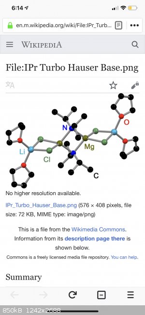

i was reading about turbo-hauser bases
and that common ones are
iPr2NMgCl·LiCl, iPr-Turbo-Hauser base
TMPMgCl·LiCl, TMP-Turbo-Hauser base
i also read that those two differ in their reactions

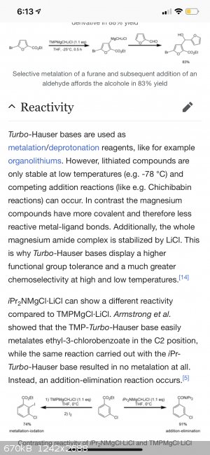

[the 9th picture down (here)]
https://en.m.wikipedia.org/wiki/Turbo-Hauser_bases
“iPr2NMgCl·LiCl can show a different reactivity compared to TMPMgCl·LiCl. Armstrong et al. showed that the TMP-Turbo-Hauser base easily metalates ethyl-3-chlorobenzoate in the C2 position, while the same reaction carried out with the iPr-Turbo-Hauser base resulted in no metalation at all. Instead, an addition-elimination reaction occurs.[5]”
[5] Armstrong D. R.; García–Álvarez, P.; Kennedy, A. R.; Mulvey, R. E.; Parkinson, J. A. (2010). "Diisopropylamide and TMP Turbo-Grignard Reagents: A Structural Rationale for their Contrasting Reactivities". Angew. Chem. Int. Ed. 49 (18): 3185–3188. doi:10.1002/anie.201000539. PMID 20352641.
i noticed that it addition-substitution reacted with an ethyl ester, so i was wondering if it would replace
1) OH acid
2) H aldehyde
3) OMe methyl ester
i assume it would work better with the OH, (but what about the aldehyde?)
