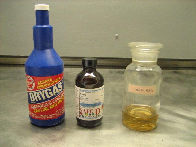

As requested, here is the first synthesis using my homemade autoclave.
Preparation of N,N-dimetylaniline
This synthesis followed the procedure in Fundamental Processes of Dye Chemistry by Fierz-David and Blangey, 1949, p.133. This can be found in the SM library.
Special Equipment
This synthesis requires the use of an autoclave capable of 60atm. I used my homemade autoclave, construction of which is documented in the Prepublication section of this forum.
Reagents
Methanol was Drygas gasoline de-icer. It tested negative for ethanol and acetone in an iodoform test. Sulfuric acid (96%) was Rooto drain cleaner. The aniline, which was amber, was from Daigger. All reagents were used “as received.”
Procedure
Due to the highly poisonous nature of aniline and N,N-dimethylaniline, all procedures were conducted in my hood using gloves.
A. 1st Heating Period (6hrs at 215C)
133mL of methanol and 91mL of aniline were mixed in a 400mL beaker using a magnetic stirrer. One mL (of 5mL) of sulfuric acid was added to the stirring solution. This resulted in a small but violent reaction. The rest of the acid was added by the drop. The solution turned an opaque creme color, presumably due to the formation of aniline acid sulfate. Resulting pH was 5.
