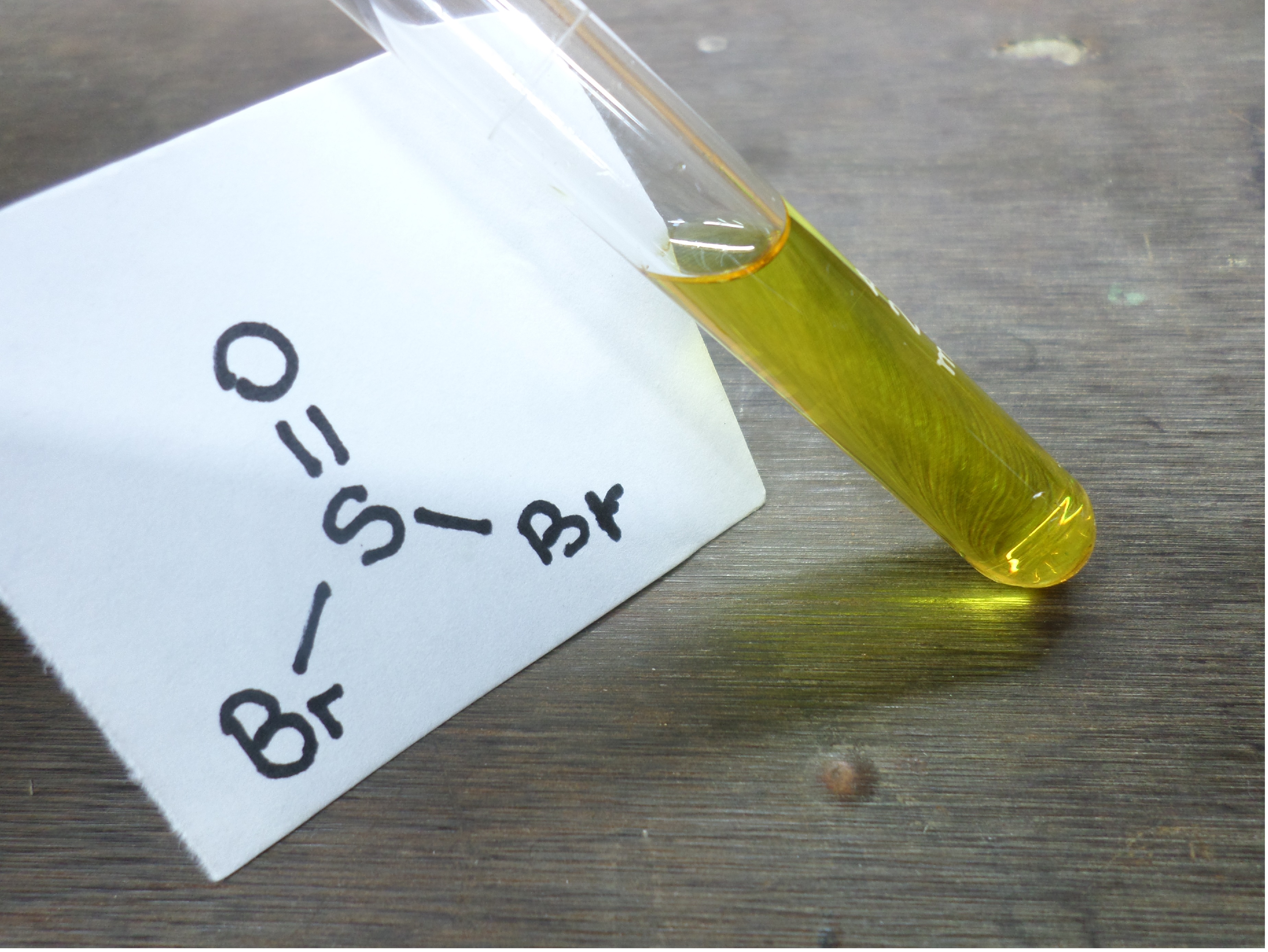

Here's some Uranyl Nitrate sample and Thionyl Bromide :)

shouldn't uranyl nitrate be UO2 (NO3)2?
is that an uranium (IV) (with oxygen!?) nitrite?
i think you messed up the formula a bit:D

@Ubya: Uranyl ion has uranium in its +6 oxidation state. The ion is UO2(2+) and the nitrate salt is UO2(NO3)2.

Ups ... Sorry :) Yup i did messed up the formula jej e.. Sorry .. Nex post is on UV for Herr Haber and the correct formula =) .. btw nice Ferrous Sulphate.I'm very interested in your synthesis of Dioxane, so i'm expectant for the post :)

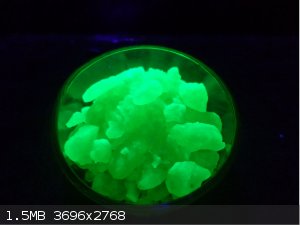

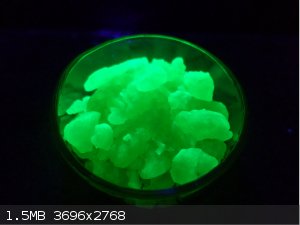

[*] posted on 4-6-2019 at 17:39
Here's 20gr of Uranyl Nitrate in UV light :)

[*] posted on 5-6-2019 at 03:35
That sample of uranyl nitrate is beautiful.
yup i know, i was messing around trying to interpret the wrong formula:P
@chem science: beautiful sample, uranium is one of my favourite elements, if not the most
