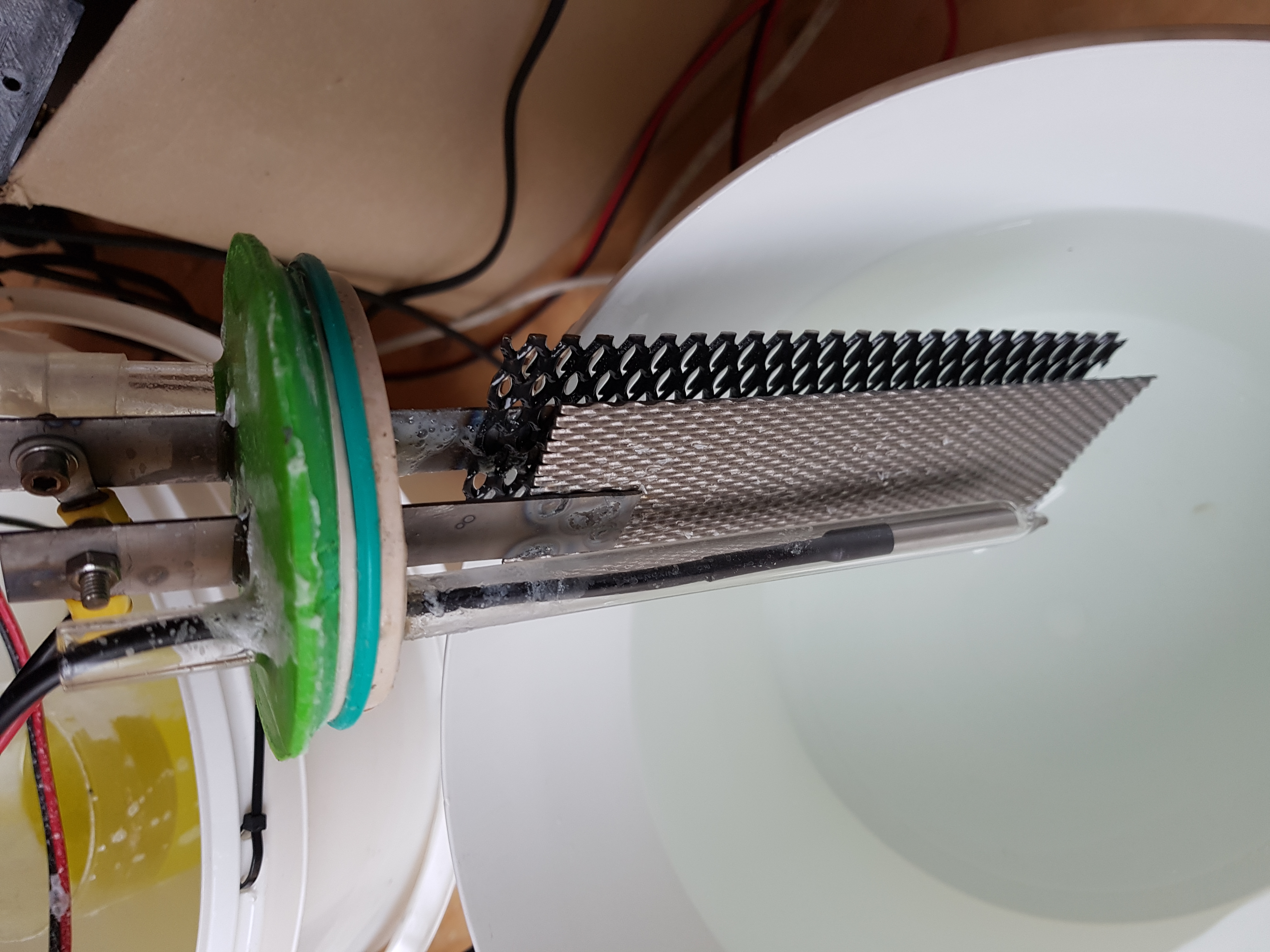

Hello everybody,
I don't know if there is something like a "show your projects" section on this forum but I like to share my first results on a test run I did with my
chlorate cell. I don't have exact numbers yet since this was just a test to see if the materials of the cell would hold up. Especially since I 3d
printed the lid myself and I couln't find any information about the chlorine resistivity of PETG. I just know that it's resistant to a lot of things
so I gave it a go.
My cell is build with a MMO anode and a Ti cathode witch are glued into a lid I printed with my 3D printer. Besides the anodes there are also 2 glass
tubes in the lid. One is closed off and can be used to insert a thermometer while the other is open and used to vent of the gasses. The cell holds
about a liter electrolyte witch consists of a saturated solution of NaCl with a pinch of K2Cr2O7. The cell was run for 4 days straight while the
temperature changed between 60°C to 80°C, due to the changes in ambient temperature. I unfortunately cannot do not know the current it ran at
because I don't have a way to measure this (yet). One of the projects I am currently working on is a device that measures voltage, current and
temperature and logs these values to a SD card over time. I will be using this in the future to measure the cell and calculate the efficiency.
The product you see in the attachment is KClO3 witch is precipitated from the solution by a double displacement reaction between KCl and NaClO3. The
slight yellowish color is due to the K2Cr2O7 witch is still present. I would like to do a crystallization to gain some purity. All the filtrate will
be saved for a future run, a bit of potassium in the cell couldn't hurt but I hope that the solubility won't get to low. Any tips or ideas on this?
Besides, i don't really have a goal for the KClO3.
I used to do some pyro back in the day but KClO3 is something I never used and never going to use in pyro due to safety reasons.

vanBassum
Posts: 36
Registered: 16-4-2019
Hello everybody,
The ultimate goal would be to build a KClO4 cell. A drawback of KClO4 is the low solubility, therefore I would like to start out with NaCl to create
NaClO3 and oxidize that further to NaClO4. At last a double displacement would leave me with KClO4. I don't expect to do this anytime soon though
since I don't like messing around with soluble lead salts to make my own electrodes and platinum is a bit above the budget right now. Also, I've read
that platinum could be destroyed when the ClO3 contents become to low, so lead oxide would be preferred.
I have given the K2Cr2O7 some thought before use because of its toxicity but I think if everything is contained in the cell with a tube bubbling
through a neutralizing solution of some sort it will be manageable. I am using a gas washing bottle with a fritted disk for this, so I am not to keen
on using hydroxide since that will attack the disk. And those bottles are not cheap... Right now its just filled with water and a bit of sodium
carbonate.
I currently don't own a beaker large enough to do a re-crystallization so I ordered some online but that will take some time to arrive. I also have
thought about using something like a glass coffee pot as a beaker although I don't know if it is suitable. Besides I am going on a vacation in a short
while so the re-crystallization has to wait.
On another note, the PETG and glue holds up quite nicely. Only some discoloration in the plastic is noticeable but its hasn't weakened for as far as I
can tell. I will cut it in half eventually because it needs a small redesign at witch time I'll do a closer inspection. The lid is pressed in the
glass container using a FKM ring to seal it, but it is a bit to small so it doens't seal properly. I included a picture to show the general idea.
Yesterday is started to work on the current amplifier to measure the current and voltage. The principle of operation can be found here: http://tinyurl.com/yyx4db2z I have soldered this to a prototyping PCB but something isn't quite right yet so I'll have to fix that. Ones I'm happy
with it I'll share some photos and source for the arduino so people can recreate it.

Very nice cell construction! If you are not sure about the sealing efficacy of the gaskets and see no heavily detrimental effects upon productivity
without the dichromate, then I would advise to avoid the additive, unless you are conducting the synthesis run outside. In my practice I've not had a
situation where the cell would show such low productivity that additional "boosters" are unavoidable or dearly needed. Even with nonoptimal electrode
sizes and conditions. Woelen mentioned that his cell was of nonagreeable efficacy without the dichromate.....perhaps your set of conditions is similar
and the additives are well justified in that case. It sure does help with raising the current efficiency of the synthesis and it is the industry

A porcelain crucible is often suggested.
You'll mainly want to make sure that the melt is free from metallic impurities that can catalyse the decomposition of chlorate to chloride.
You can remove trace amounts of remaining (di)chromate by adding barium chloride (barium dichromate is insoluble around neutral pH).
I recall this method was even used industrially for preparing potassium perchlorate, until better methods were discovered.
PS. Welkom landgenoot
[Edited on 26-4-2019 by phlogiston]

I got around doing a re crystallization. After witch I dissolved everything again and used a bit of BaCl2 to get rid of the chrome. This was done by a
hot filtration, I could clearly see some greenish particles in the filter. After everything was crystallized out I did a small washing step and put
everything on a dish to dry. (I do have a lab microwave / grill witch i got for free from a fried.)
Right now I am trying the decomposition. My hotplate is fortunately hot enough to melt everything in a beaker and keep a fairly steady temperature.
Its liquid but not bubbling. Only a few very small bubbles are floating around. A bit like coke in a glass. I some very small white precipitate
floating around in there. This is presumably the percholate or chloride.
I have some methylene blue but it didn't turn purple in a solution known to be KClO4. Any suggestions?
[Edited on 1-5-2019 by vanBassum]
