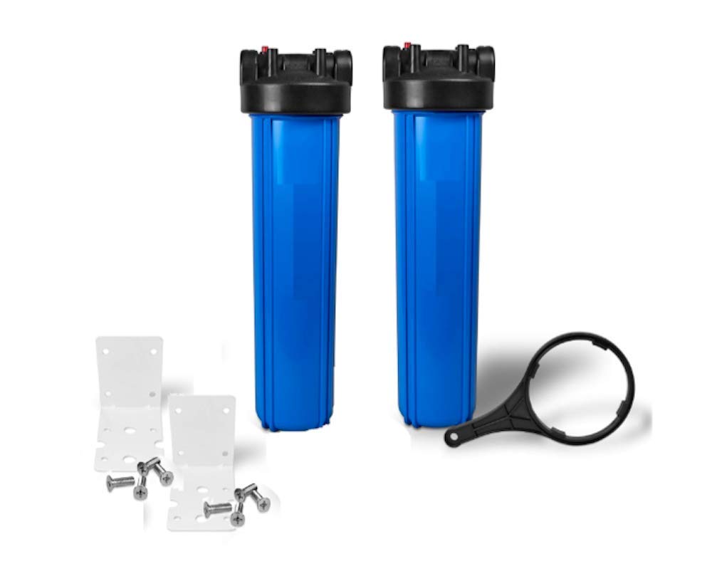

I could do the same with activated carbon but I also have 2 of these:
http://www.sciencemadness.org/talk/post.php?action=newthread...
water filters.jpg - 34kB
With these I could add 5um 4.5" diameter x 20" long activated carbon filters and then a 1um or 5um particulate filter in the other canister. I could use 1-2 of these and use one for MgCl2 and another for NaOH to remove water.
Doing the above would allow for the use of any air compressor and not just oil-less or higher priced units (ones I don't already have). I have all of the above already, so I'd like to try it as a proof of concept.
