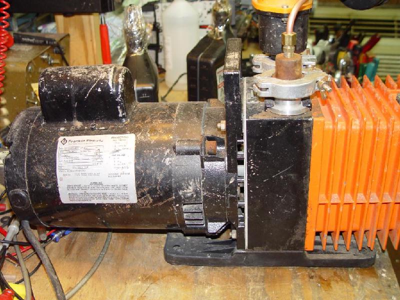

This is the next pump I added to my vacuum station, around a grand used rebuilt, good to 0.1 micron. So I have a single stage rotary for rough to around 70 microns, a new 2 stage to one micron, and If I can work the plumbing out I will add the 0.1 micron Alcatel. It runs very quietly. For now I think I will just clean it and do an oil change, test it to see how well it does. Will take some plumbing work to keep a nice short, large diameter route into the base of my bell jar platform but worth it. Best I could do before this one was around 1 micron. This hobby is expensive, a grand to move the decimal point by one place from 1 to 0.1.
The Alcatel only had a few days worth of run time with the oil kept clean by changing, then was stored for a few years. Kind of wondering if I should buy the rebuild kit before I start using it because it was stored (but never run) in a desert sandy location. Every time I went to that storage room sand was across the floor from blowing in under the door. I worry that there could be microscopic particles of sand in there even though I flushed it out and put new oil in. The exhaust muffler only had a cloth plug in it to keep dirt in the air out. Pic below is just off the web, when I get around to it I'll take a pic of the one I have here (identical to the advertising pic below).

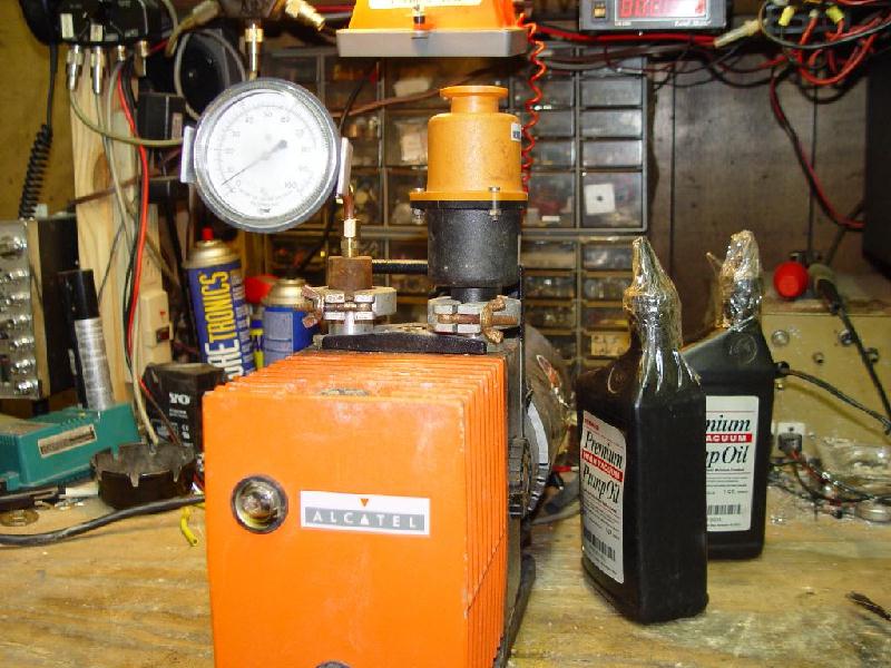

[*] posted on 2-1-2011 at 16:26
I don't pump down any chemical experiments, mostly physics type experiments. Looked at the price and it is high for that oil. For anything chemistry related I have a few Gast diaphragm types which would survive corrosion better and in general are inexpensive pumps. Thinking about removing the top pump as it barely does 150 microns and I need room for large tubing for the Alcatel. Besides I have learned through experience it is better for two pumps to be closer together in maximum vacuum capability.
Below are a few pics of my system. I built it for getting down in the 55 micron range and providing various plumbing to allow gasses in for laser work. Wanting to play with the Farnsworth Fusor idea I decided to find a way to include the Alcatel pump. That thing is 10 times less noisy than even my new two stage pump. Very smooth even if it could use a touch up paint job. I cannot measure the vacuum with it, will have to get some better gauges as it pegs everything I own. Looking at Pirani gauges and looking at plans to build a Capacitance Vacuum Gauge, still undecided.
Finished my top but am waiting for a freon leak checker (off ebay) as I cannot get below 100 microns due to a leak somewhere. I could not think of an easier way to look for tiny leaks. I still wonder if extruded Plexiglas is the reason. Next I want to build a cage around the bell jar just in case.
One last thing. Does anyone know where to get user info for Alcatel? Damn hard to find, with the name connected to Lucent in a completely unrelated technology. I am looking for oil level in the site glass information. What is full, over, under, etc., and off or running when you look in bubble in sight glass. Refilled it after flushing and is centered in the red circle on, raising to top of glass off. Looked natural that way, took exactly 1 Qt to reach this level. No idea for sure and with these things going for up to $700 on ebay broken - as is, I sure do not want to make any mistakes. Worth much more in perfect running condition as this one is. I never use my high quality pumps until I have already reached the 150 micron range just to keep them in top condition.

Thanks Vulture. I searched that site a week ago but found nothing useful for the 2004A. In general all I found searching was rebuild kit parts lists and one part location PDF but not a word otherwise. By this I mean some form of rebuild instructions which may have included oil level info, etc.. Emailed but heard nothing back. If you ever find your file I would be happy to see it posted here. Just a little maintenance information would be helpful. Long ago I decided to not invest in anything the MFG makes hard to find info for but this Alcatel is so smooth and quiet (as well as very high vacuum) an exception must be made.

Thanks Vulture this PDF is perfect. Answered all of my questions. This plus the parts placement PDF for the 2004A give me all I need even if I never do find the correct owners manual. I will keep searching for a service manual if it exists just in case I ever decide it needs a rebuilt. With a flushing (wasting a QT of new high vac oil combined with refilling with a new QT (just under) it runs so perfectly I doubt I will ever need to rebuild it. I am amazed at the quality of Alcatel pumps.

Just an update and a question. I finally found my < 100 micron leak, it was the neoprene itself. 5/16" thick material and it is actually leaking through the material. I made a new seal with a new piece - same problem. I need to find some of the 1/4" stuff identical to the old one used in the big magazine lithography machines. No luck so far but I did learn it was a silicone type material which worked great under one micron.
Question: does anyone know of any sources for porosity information for various rubber-like materials? The neoprene I used was large 12"SQ sheets used for making automotive gaskets. Nothing else locally around here and as stated in another post those fleabay sellers want insane prices for their stuff.
For now I am working very hard to remove the old epoxy to reuse my original gasket. Not fun and I really want to make a brand new one if possible within my budget.

Looking at the pump, I see signs of rust on the external components. That suggests it's been somewhere fairly damp, as I've not seen the rust on mine and 'grey drizzle' is the predominant weather system in the UK. :P
If you look at the photo I've included at the end, you can see the insides of these pumps (Alcatels) look a lot like a sandwich, with blocks that slide together. You can also see, they're CAKED in rust. This is quite normal in my experience, and is a sign that damp air has been running through it - e.g. people have been leaving the pump running in a workshop as they get something ready, or they've been using it to boil off moisture.
Opening a pump and finding it looks like this is not a great experience, but it's also less of a problem than it looks. The actual chambers inside are usually still shiny. The outside of the pump head rusts because the film of oil drips off it when not in use and the pump heads are often cast iron.
When you say neoprene seal, do you mean the one around the oil box (the orange thing)? That shouldn't actually be exposed to the vacuum, it's more like a collection pan that the oil sits in.
I would say you first goal should be a gauge so you can actually CHECK the pressure it's reaching, which is real important for physics work. If you're predominantly interested in lower pressures, there are a number of HVAC gauges you can buy that use the convection / thermal conduction properties of gas for measurement.
