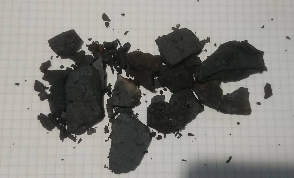

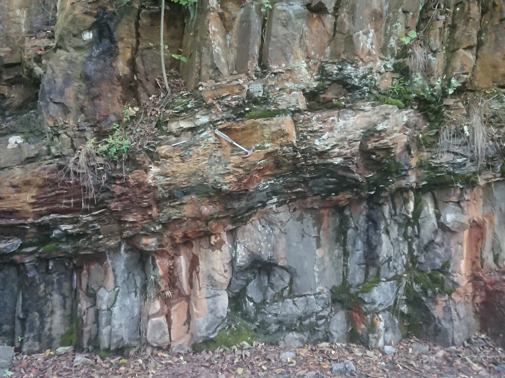

[*] posted on 30-8-2019 at 10:28
Huh, this was easier than I imagined. After a 20km trip with not a single sign I struck pay dirt less than 5km in the opposite direction. I'm sure I've driven past that spot a thousand times before...
Shale1.jpg - 450kBShale2.jpg - 234kB

[*] posted on 18-9-2019 at 09:41
There's uranium in them hills for sure. I'm using a radon meter in a small box, a 45g sample raised the radiation from a background level of 10Bq/m3 to over 350.
