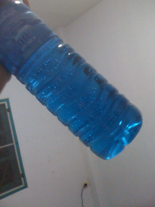

i poured some nitric acid and h2o2 on copper (there was also gold in the solution, they were computer pins) and got this solution in a bottle, which
i'm posting. i poured just plain old nitric acid on some of the same kind of pins earlier and got green solution, if i dissolved along with h202, the
solution was blue and clear and no NO2 gas was produced.

Cu(s) + 4HNO3(aq) --> Cu(NO3)2(aq) + 2NO2(g) + 2H2O(l)
the subreaction is
Cu(s ) + 4 H+(aq ) + 2 NO3-(aq ) --> Cu2+(aq ) + 2 NO2(g ) + 2 H2O(l )
Adding H2O2 allows for the oxidation of the copper without consuming HNO3. In a similar fashion HCl + H2O2 will attack copper metal, while air/oxygen
free hydrochloric acid will not react - copper is below hydrogen in the electrochemical series.
Adding the H2O2 also added a lot of water, the resulting solution of cupric nitrate is much more dilute, and does not contain NO2 is solution, thus
the colour difference.

from what you're saying, since there's no NO2, and the HNO3 wasn't consumed, then there should still be nitric acid in the solution...?
that's about as far as my thinking got: no brown gas=N still in solution in some form
the bottle is gathering small bubbles and slight pressure over the course of a week.
still some peroxide i guess.
i'll try to electrolyze it with two copper electrodes and see what happens.
i'm hoping that like copper sulfate, i can suck up the metal and be left with acid.
(same color...8-)
that's best case scenario though.
we'll see. i'll experiment and post.
