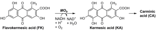

OH- is a stronger nucleophile than H, but I suppose it would be naive to think that simply adding NaOH to a flavokermesic acid solution would cause the ring to undergo nucleophilic substitution? (To be clear, I'm referring to the flavokermesic -> kermesic acid part of the sequence in the attachement; kermesic acid has one more OH group)
What if I did a process similar to benzene > phenol where you first add sulfuric acid to sulfonate the ring to get benzenesulfonic acid, then add enough NaOH to neutralize it to sodium benzenesulfonate, and then add excess NaOH to get sodium phenolate, and finally acid to reprotonate the phenolate to get phenol? (Of course, flavokermesic acid instead of benzene) I guess one problem is flavokermesic acid has 3 open spots for the sulfuric acid to attack and I have no guarantee that it would attack the right place to make kermesic acid, so it would likely produce a large amount of waste.

Hydroxide groups are meta/para directors, as all phenols have at least a meta position available I guess you will get a mixture of all three isomers.
