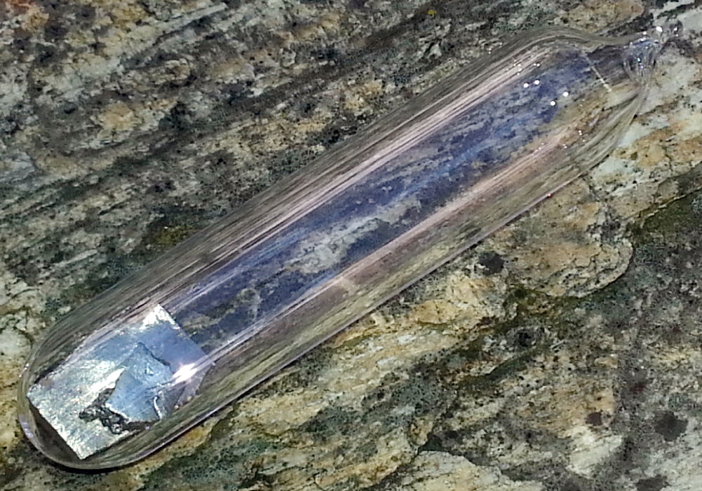

A blackened sample of U is shown in one of the accompanying pictures. I had another 18+ grams of similar-looking metal as a half dozen small chunks. They were solvent washed as described above and then added to a 10 mL lot of the acid-peroxide solution. The solution liberated small bubbles (and thus is suited for outdoor or fume hood work lest any aerosolized U enter the air) and the solution slowly assumed a color reminiscent of dinitrogen tetroxide. The color may also be from solubilized oxide and no attempt to decide which one was actually responsible was made. After 5 minutes, with occasional gentle stirring, the metal faces which were smooth were etched to a flat to moderately shiny silver color. Areas of the metal which presented fractured surfaces were also cleaned by the etchant but more slowly. For many presentational purposes, the metal can then be rinsed with water followed by acetone, then dried under a stream of argon and sealed into an ampoule under vacuum or argon. The second picture shows what the sample looks like at this point.
To achieve even nicer surfaces on samples with appropriate surface morphology, scrubbing underwater with a mild abrasive such as SiC impregnated polymer mesh pad or by using a simple abrasive cleanser, like Comet may be performed. The metal may be further subjected to gentle cleaning with a small stainless steel wire wheel mounted in a Dremel tool if desired. This requires protection for the operator by employing a rudimentary glovebox or similar isolation scheme because of the radioactive dust that it generates. A 9-gram sample ultimately cleaned by this method is pictured below in an ampoule under argon.
