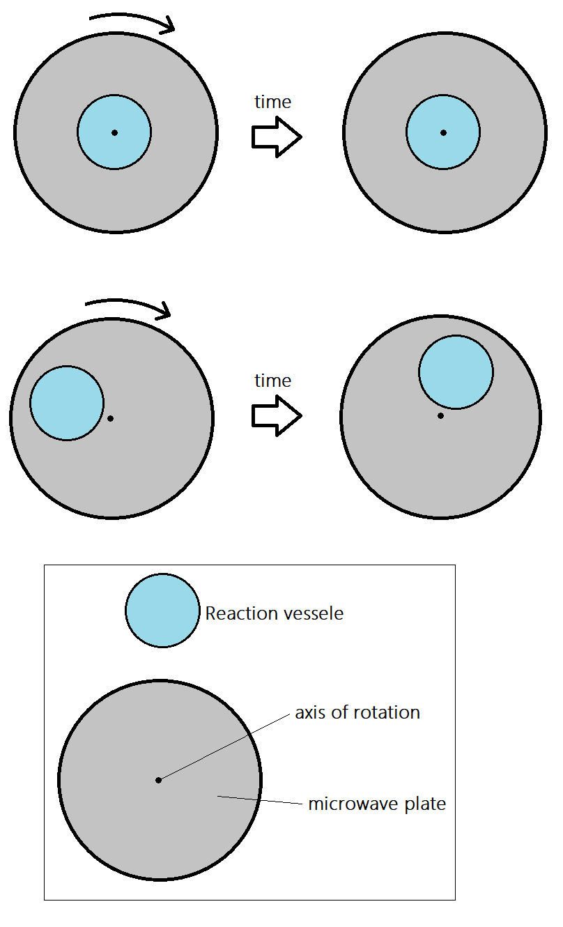

For every synthesis, I have used a microwave reactor but never a domestic one. Now I am curious about a few things: Why the reaction vessel needs to be at the center of the rotation plate? and Why should I use 250 ml Erlenmeyer even I have just about 5 ml of the reaction mixture as described in some scientific paperwork?

Hey, I am too interested in microwave chemistry, and I think I might answer your first question.
(Disclaimer - this explanation based mostly on my intuition)
First watch this video by nilered(watch from t=9:12 to t=10:39):
https://www.youtube.com/watch?v=l0u8Vtf2GoQ&t=35s
As you can see, microwaves form "hot spots" and "cold spots"(explained in the video).
If the reaction vessel is in the middle of the rotating plate, than the axis of rotation of the vessel will be in the middle of the vessel. This allow for a more even exposure to any hot/cold spots due to symmetry.
Keep in mind that even when the reaction vessel is in the middle, the exposure still won't be perfectly even. it will merely be better compared to not putting it in the middle.
Attachment: phpoyTUVg (27kB)
This file has been downloaded 556 times
[Edited on 10-1-2020 by B.D.E]

[*] posted on 10-1-2020 at 00:10
I see, but also my area of interest are Ionic liquids. So when I put a vial with BMIM for example in the center of the rotation plate it needs much more time to get hot than when I place it at the side.

[*] posted on 10-1-2020 at 02:30
It is possible that your microwave produce more "hot-spots" in the peripheral areas rather than in the center.
Putting your vessel in the center merely mean that it would be exposed more evenly to the radiation. It doesn't necessarily mean that it would be exposed to more radiation.
Maybe there's another explanation for putting the vessel in the center. Maybe it's just more convenient. For instance if the researchers were to check the repeatability of the experiment, the simplest way of doing it is to always place the vessel in the center of the microwave.
Those are at least my ideas :)
