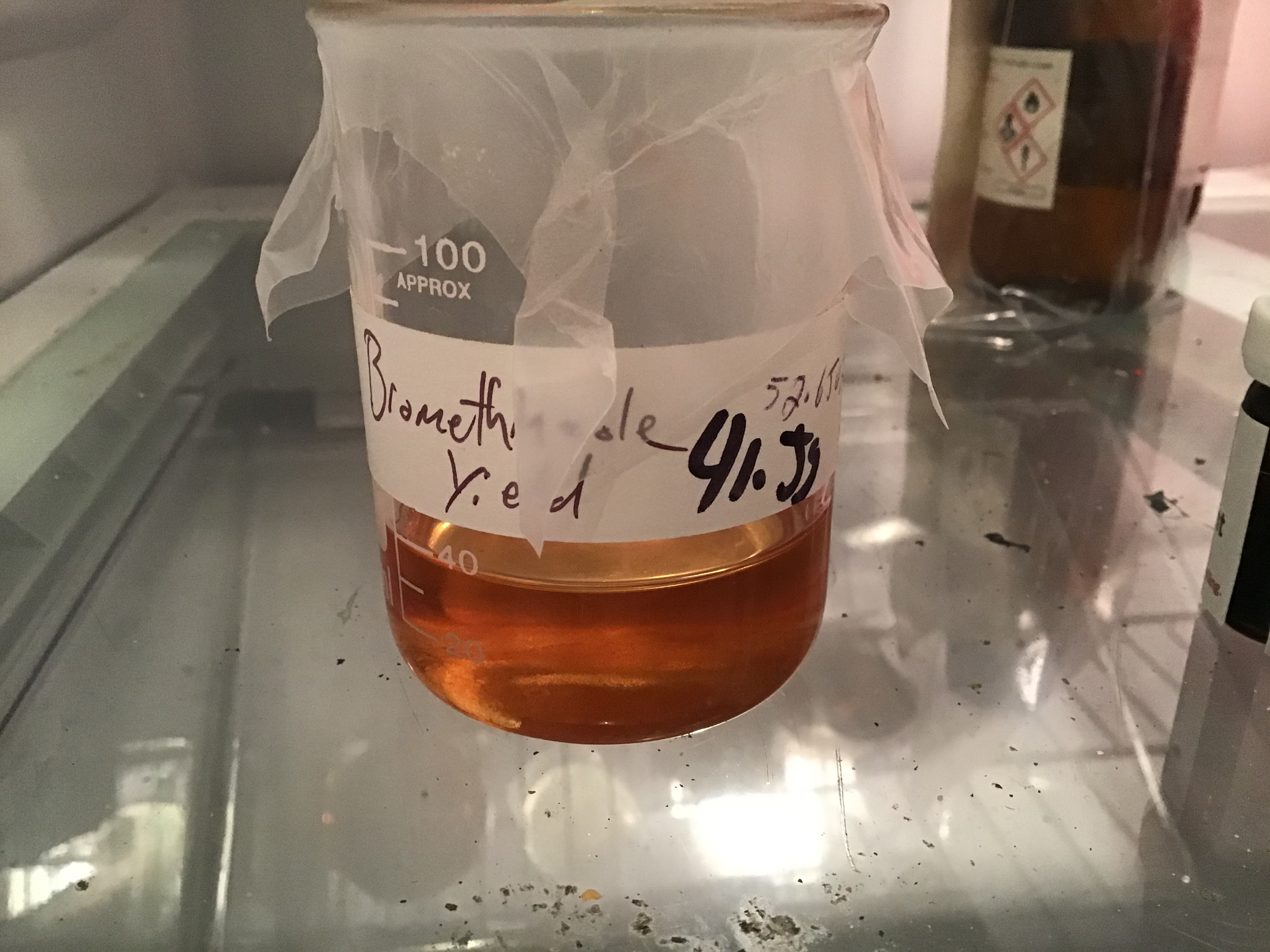

Bromethiazole Synthesis (halogenation replacing hydroxy group)

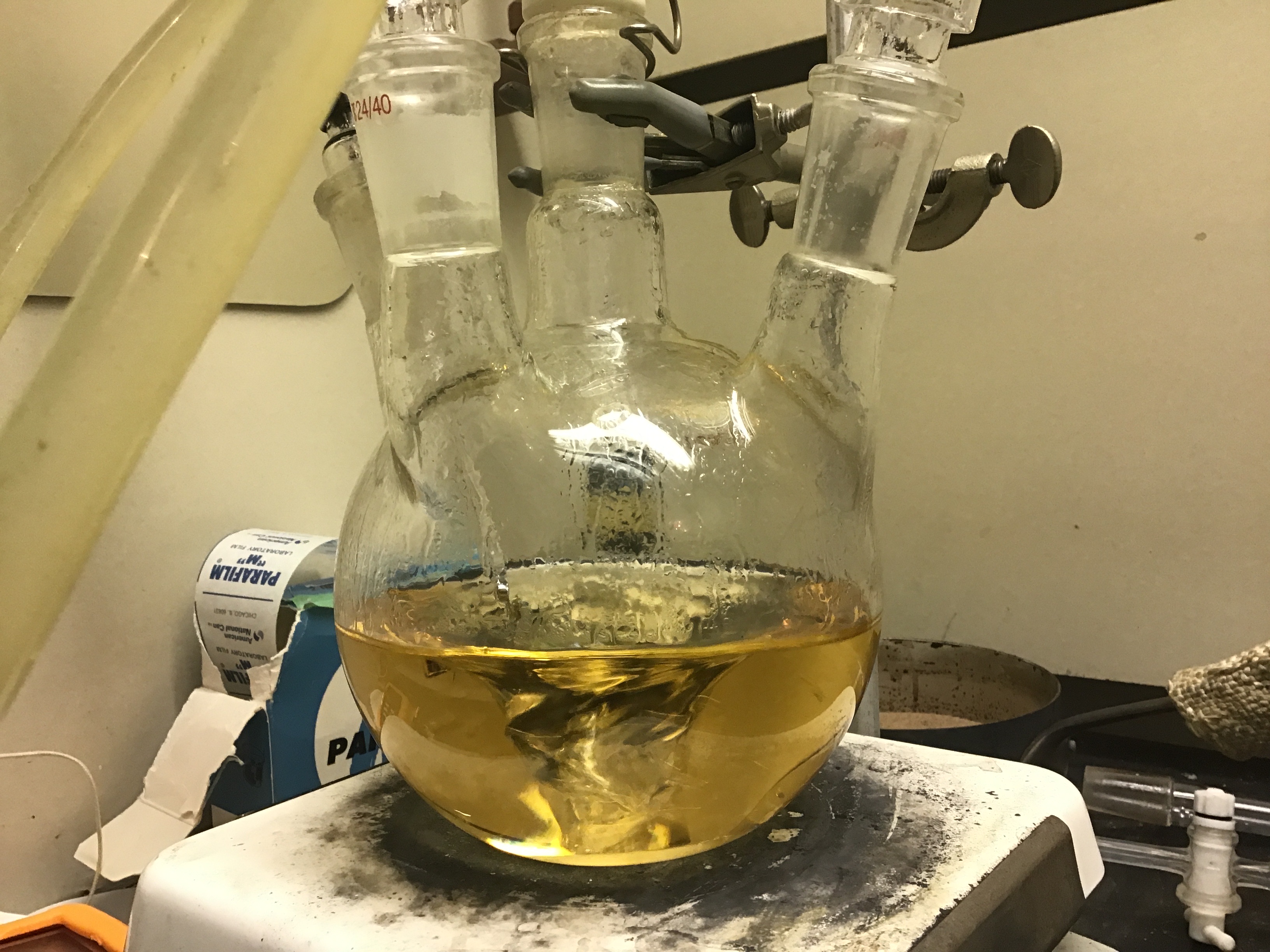

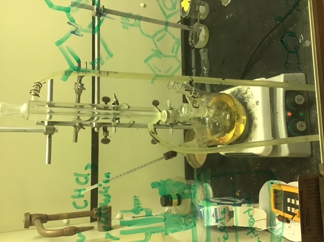

This was a fun project. I made the HBr and then used it for this halogenation to get a high yield. (78%)
I started from Sulfurol
From 21.23g HBr / 80.91g/mol HBr x 1/1 x 143.207g/mol sulfurol = 37.5g sulfurol required. I added twice the amount of HBr as it makes the salt and you require extra for the halogenation. I ended up heating the mixture for two hours and the temperature settles at 110c when heating.
My yield was 78%

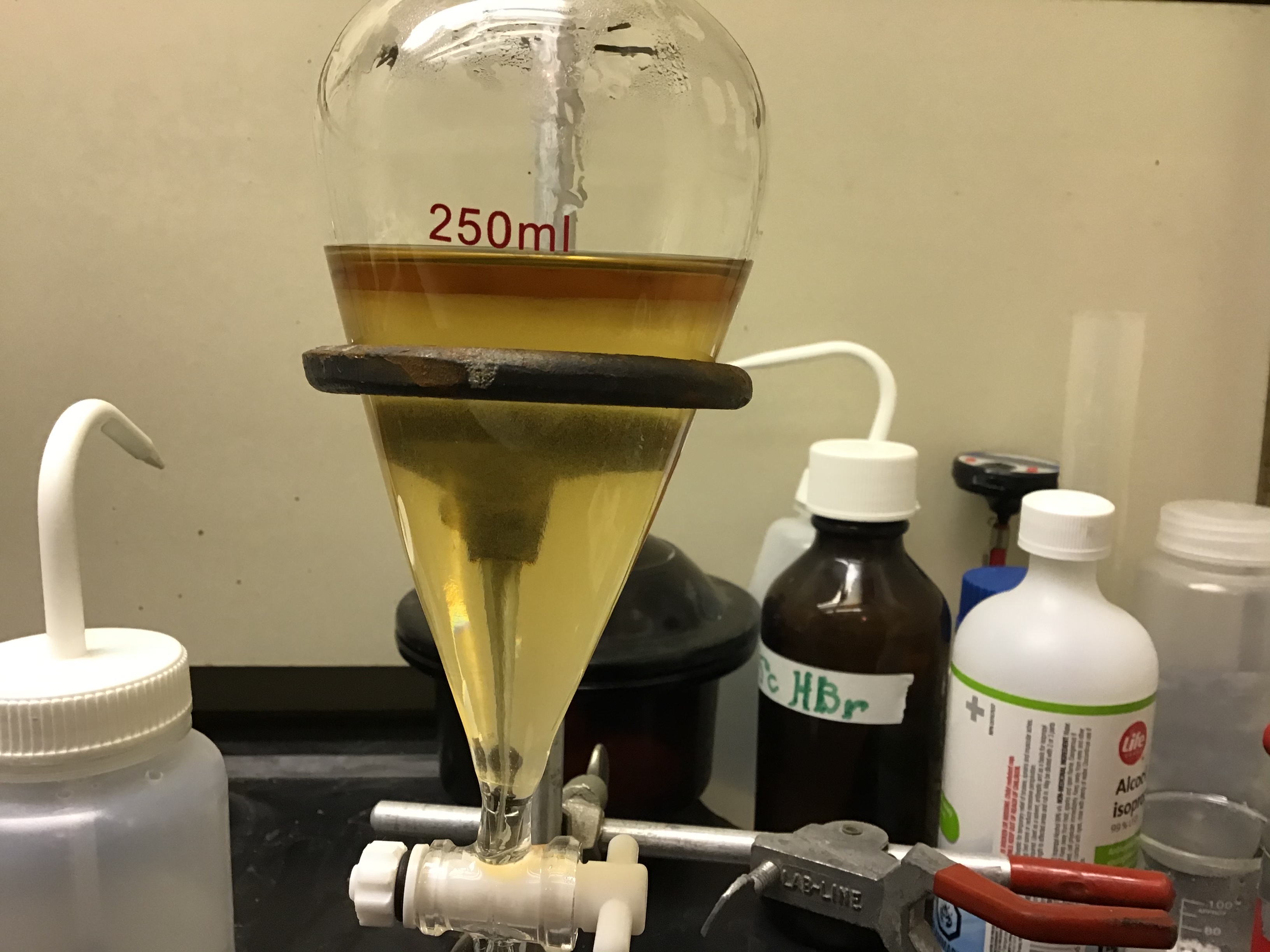

To separate the bromethiazole, you must basify the solution to remove the HBr from bromethiazole.
21.23G HBr / 80.91g/mol x 1/1x 40g/mol of NaOH= 10.469g NaOH. I added a bit extra.
You must add NaCl to make a brine to separate it in the separatory funnel. Collect the freebase bromethiazole and for me it is for research only. I will likely make the HCl salt and store the crystals as an accolade.
Fun project...here are some pictures!

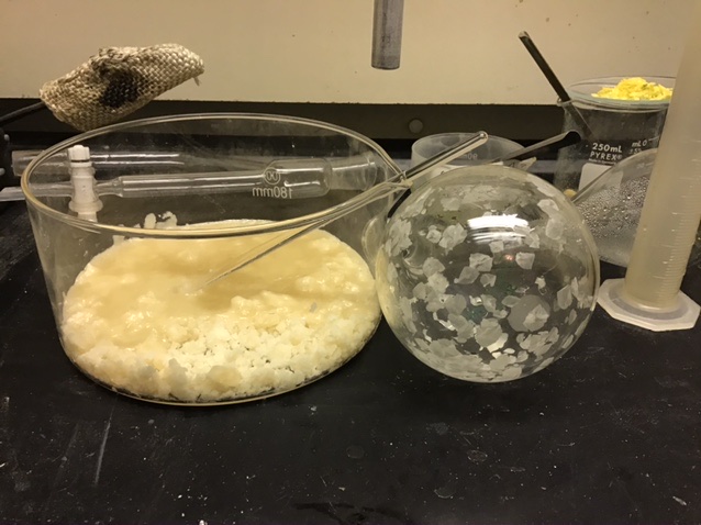

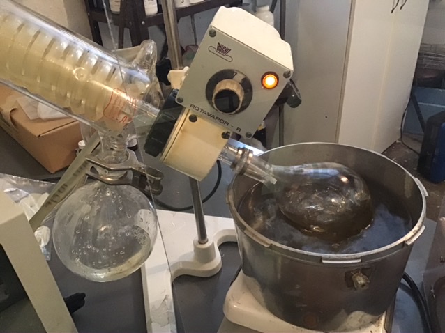

Here is another synthesis you may find interesting, of Clomethiazole Hydrochloride. This time with conc. hydrochloric acid for chlorination, replacing the sulfurol hydroxy group. I had a bunch of it so I used 210mL sulfurol based on density of 1.192g/ml and i used 290ml of conc. HCl. Very straightforward. I will post some pictures of the rotovap’d crystals later on.
(Theoretical Yield is 345grams of the hydrochloride salt)
You will never get the chemistry out of me...i was raised with organic chemistry experience :)

And some extra pictures during and after completion!
5B06EF4D-B320-4D4A-BB13-93CB37F07A89.jpeg - 92kBD3AE8654-EE18-4B77-AAEE-53AD9E236EE7.jpeg - 95kB
