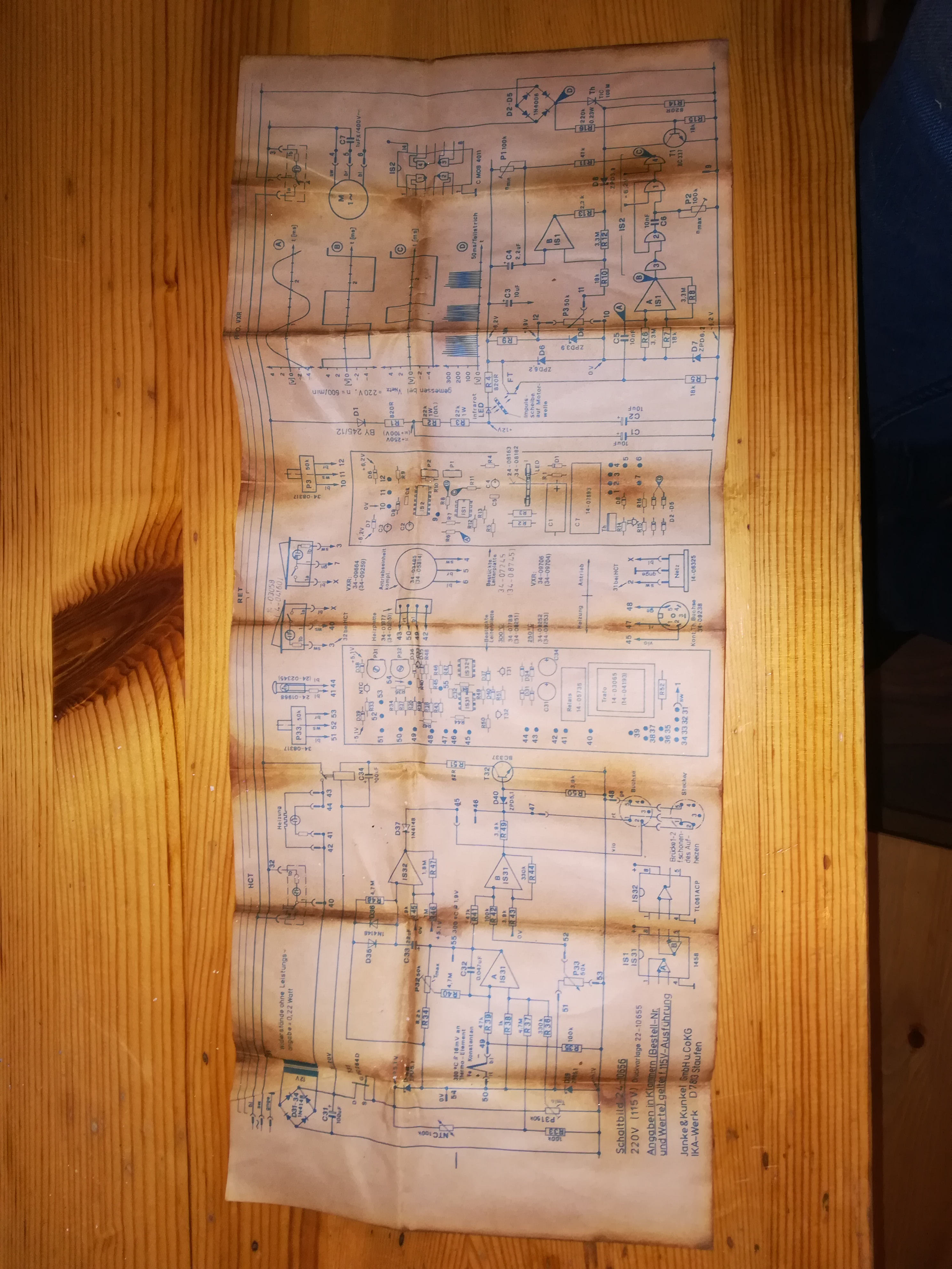

Now I am not an electrical engineer and I am somewhat lost. Luckily, being German made, it had a schematic drawing of all electronic components inside
(see attachment) . Also the circuit board is not miniature so even an amature like me can do some soldering and hopefully fix it.
Can any of you give me some pointers as to what may be faulty or what components I need to check?

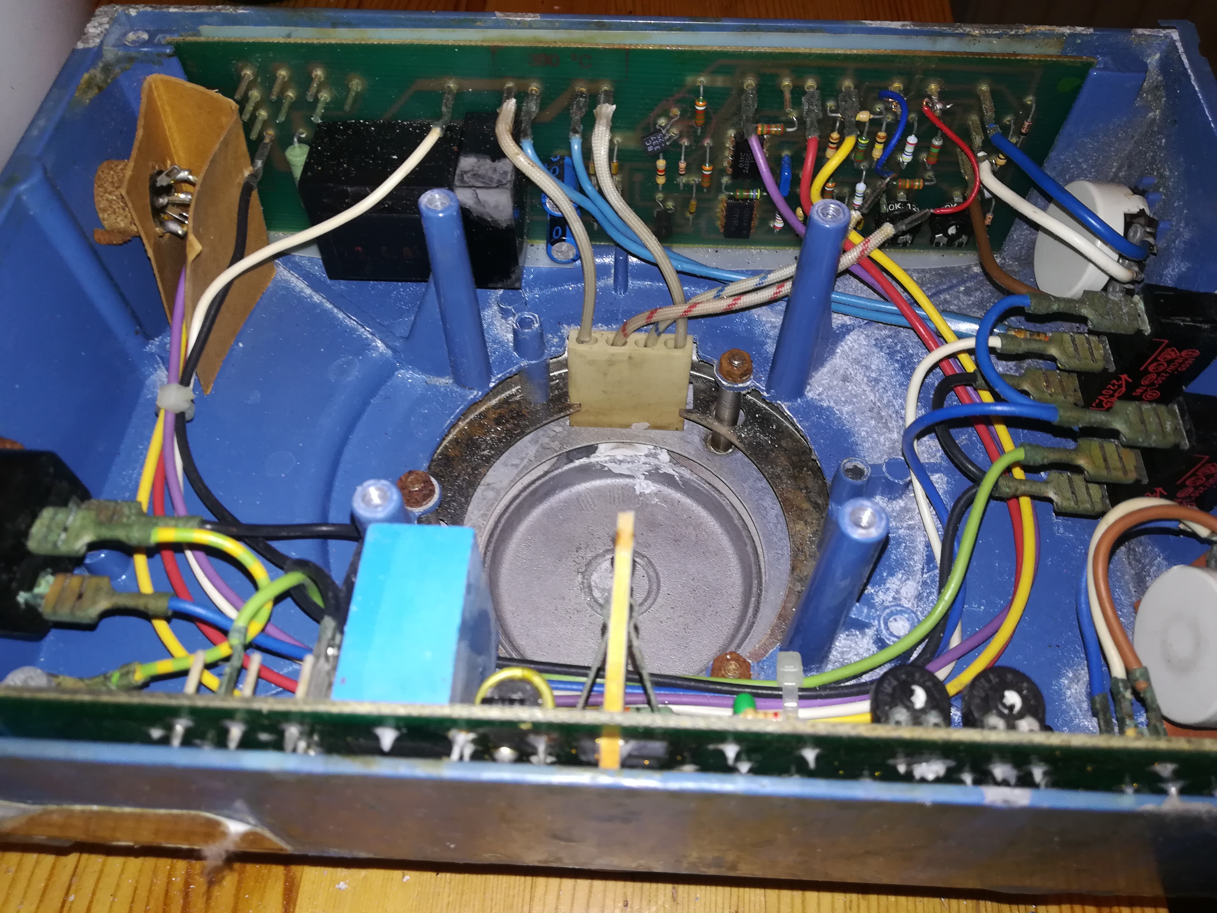

So I've took the stirrer plate apart and made pictures. First off I cleaned some grime off of the IR-diode and receiver with some alcohol/cotton ball.
Behavior unchanged, still only an on and an off as to stirring.
Next I decided to check whether there was any IR there by making pictures/foto's with my mobile phone. (red. Mobile phone cameras pick up IR, check it
with your TV remote). There was no IR.
To be continued....

Now for the actual insides, first is the stirrer side of things, second (the one with the connections for the thermocouple and heating element
(ceramic plug)) is the heating side of things.
The electrical motor and magnet have been removed for more easy viewing.
Edit: sorry for making an end on picture, the optical elements are sticking out on the left of the yellow green capacitor/condensator.
[Edited on 20-3-2020 by Sigmatropic]

Thank you soooooooo much. While the boards are different it has the same basic layout and wiring, so I should be able to rewire it from the pics.
Hope it's something simple on your end, a blown led should be fairly easy to replace.

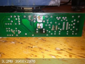

So I checked continuity between the legs of IS2 and the bottom of the pcb which gave variable results. When I pulled it out the legs broke, go figure.
I've replaced it with a new one but the problem persists, stirring still is basically an on-off at ~100 rpm on the dial.
Attached is a picture of the bottom of the stirring pcb. It shows some signs of (over) heating around R2 and R3 and separately around R1 and D1. Based
on the soothing on the pcb backing the big plate from R2 to C1 appears to have gotten warm. This is directly below C7.
C1 gives a reading of 16-17 uF, close to the 10 uF indicated.
C7 reads 0.85 uF, also close to the 1 uF indicated (although it's indicated as 1 uFX/400 v, whatever that may mean). Seems to me C7 is part of the
motor starting circuit and that obviously still works.
R1, R2, R3 and D1 give good readings.
Suggestions are welcome (: .

R2 and R3 are feeding the phototransistor and one of them appears chipped in the photo, and with the scorching on the board could indicate a failure.
If the signal to chop the voltage is not going to the motor, it makes sense the motor would behave that way as the voltage needs to increase enough
for the cap on the start windings to create the imbalanced magnetic fields for the motor to start turning, then its just full on from there.
The phototransistor initiates the signal to the chopper drive to cut power to the motor at the proper frequency to effectively spin it slower. The
TL062 op-amp near those resistors looks severely corroded. Since it's plugged into a socket, you may be able to remove it and clean up the corrosion
or replace it, they are cheap.
The whole motor speed control can probably be removed and replaced with a triac dimmer switch rated for inductive loads. It's not ideal but works,
