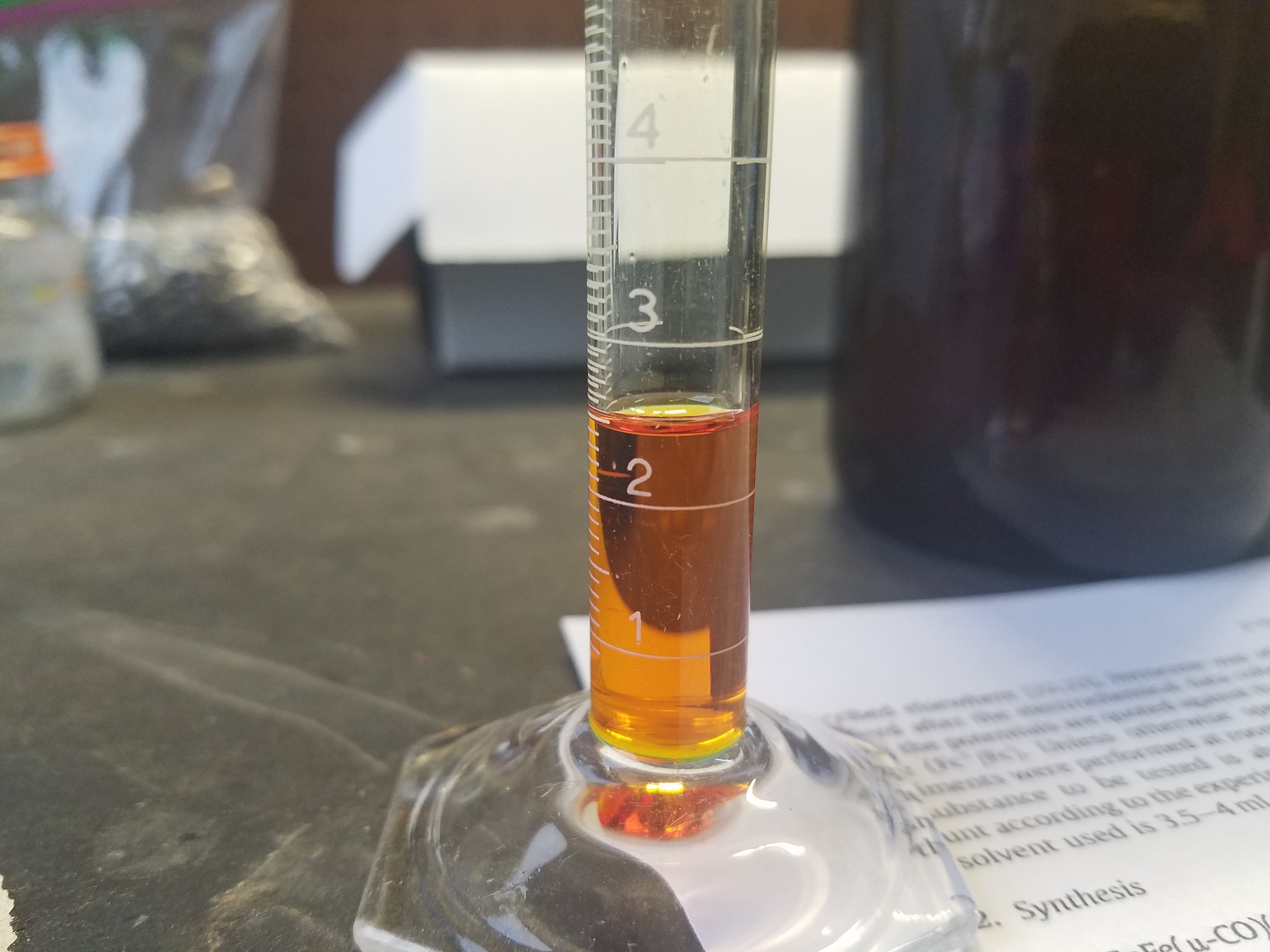

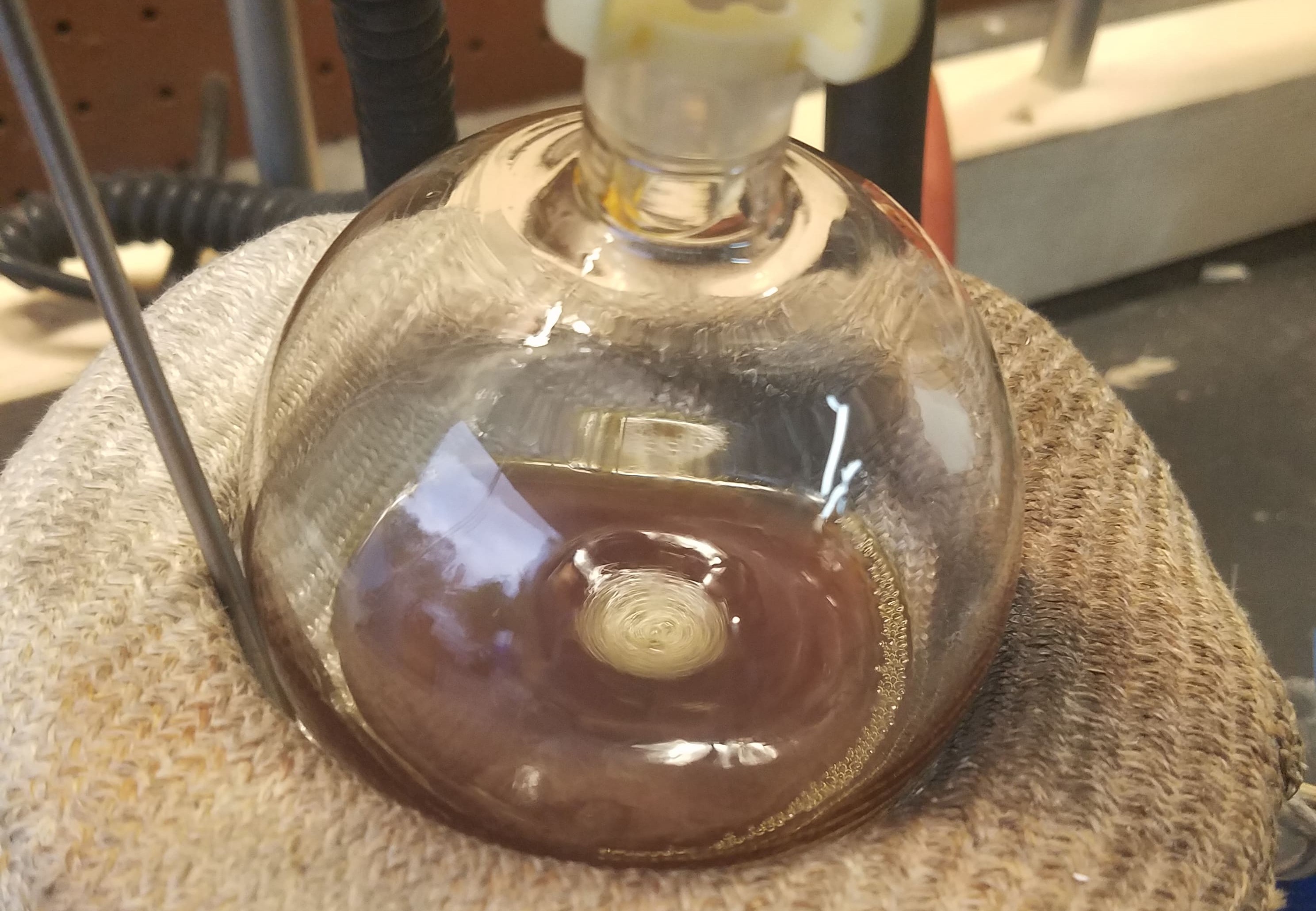

I believe this compound was previously posted here, I followed the same procedure, but provided some pictures as well. A 250 mL oven dried flask was fitted with a stir bar and water condenser, evacuated, and refilled with Ar. Under strong argon flow was quickly poured in dicyclopentadiene (50 mL) and Fe(CO)5 (12.5 mL). The reaction was vigorously stirred at room temperature for an hour under Ar to remove dissolved oxygen. The reaction was heated to exactly 135 oC, I used a heating mantle that I cranked up bit by bit until the temperature was stable. Here are the ancient bottles, and a sample of the pentacarbonyl. Although it is slightly air sensitive, it can be measured out in a graduated cyclinder if you work fast and are in a well-ventilated area.
20200420_181803-min.jpg - 930kB 20200420_183913-min.jpg - 831kB 20200420_184453-min.jpg - 859kB

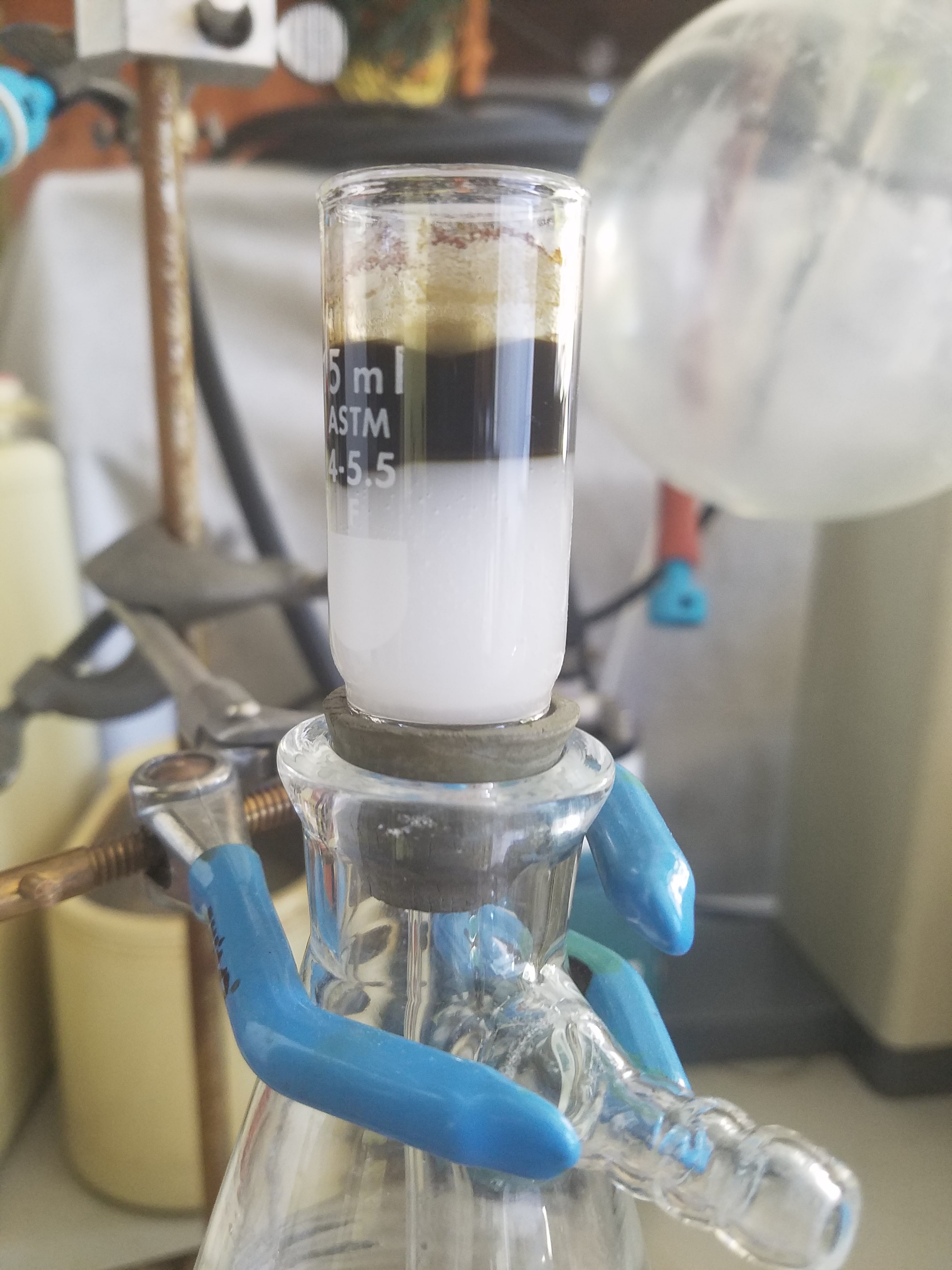

After heating for 20 h under Ar, the reaction was cooled to RT, hexanes was added (40 mL) and the flask placed in the freezer overnight. The crystals were broken up, filtered and rinsed with hexanes to yield 2 as a dark purple solid (13 g, 74%). Here is also a rare opportunity to see my molten fridge...

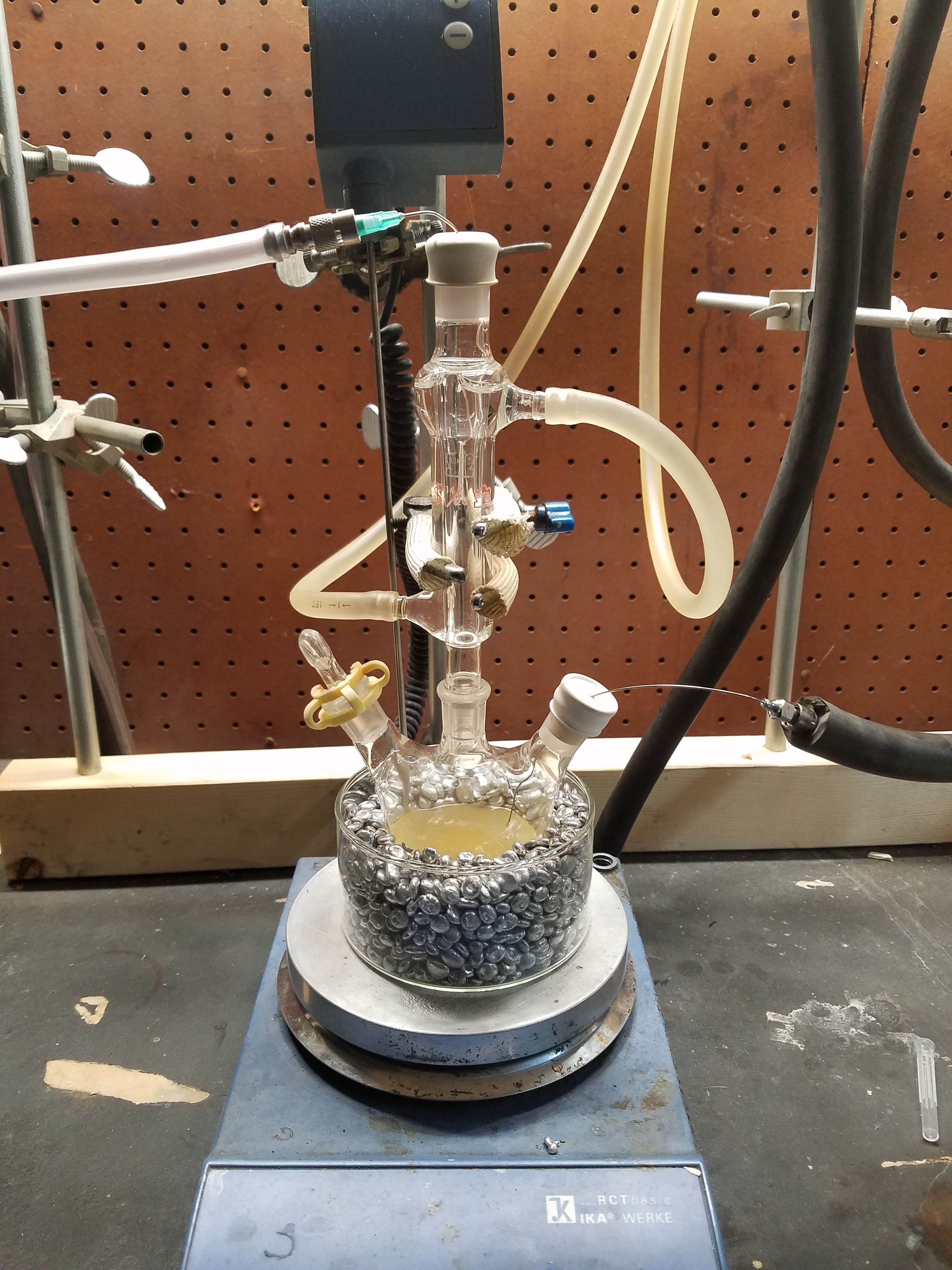

Triethylammonium hydrogen undecacarbonyltriferrate (4)
It took me ages to find the structure of 4, it's a rather obscure compound. To a 100 mL flask with a condenser and stir bar is added distilled water (24 mL) and triethylamine (8.3 mL). Ar was bubbled through the mixture for 5 minutes with stirring to degas the solution and pentacarbonyl 1 is added (11 mL). The mixture is heated to 80 oC overnight under Ar and then left to cool. The red oil solidifies to crystals upon cooling, which collected by filtration and rinsed with water several times. The solid is air stable and left to dry in air for several hours, yielding about 12 g of pure 4 as a dark solid. Note that this compound is actually a salt!

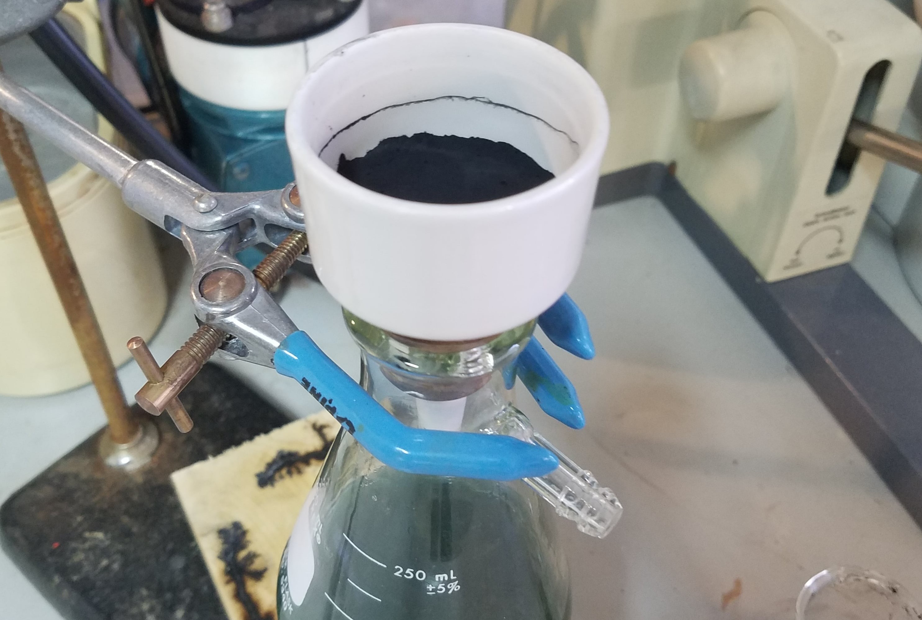

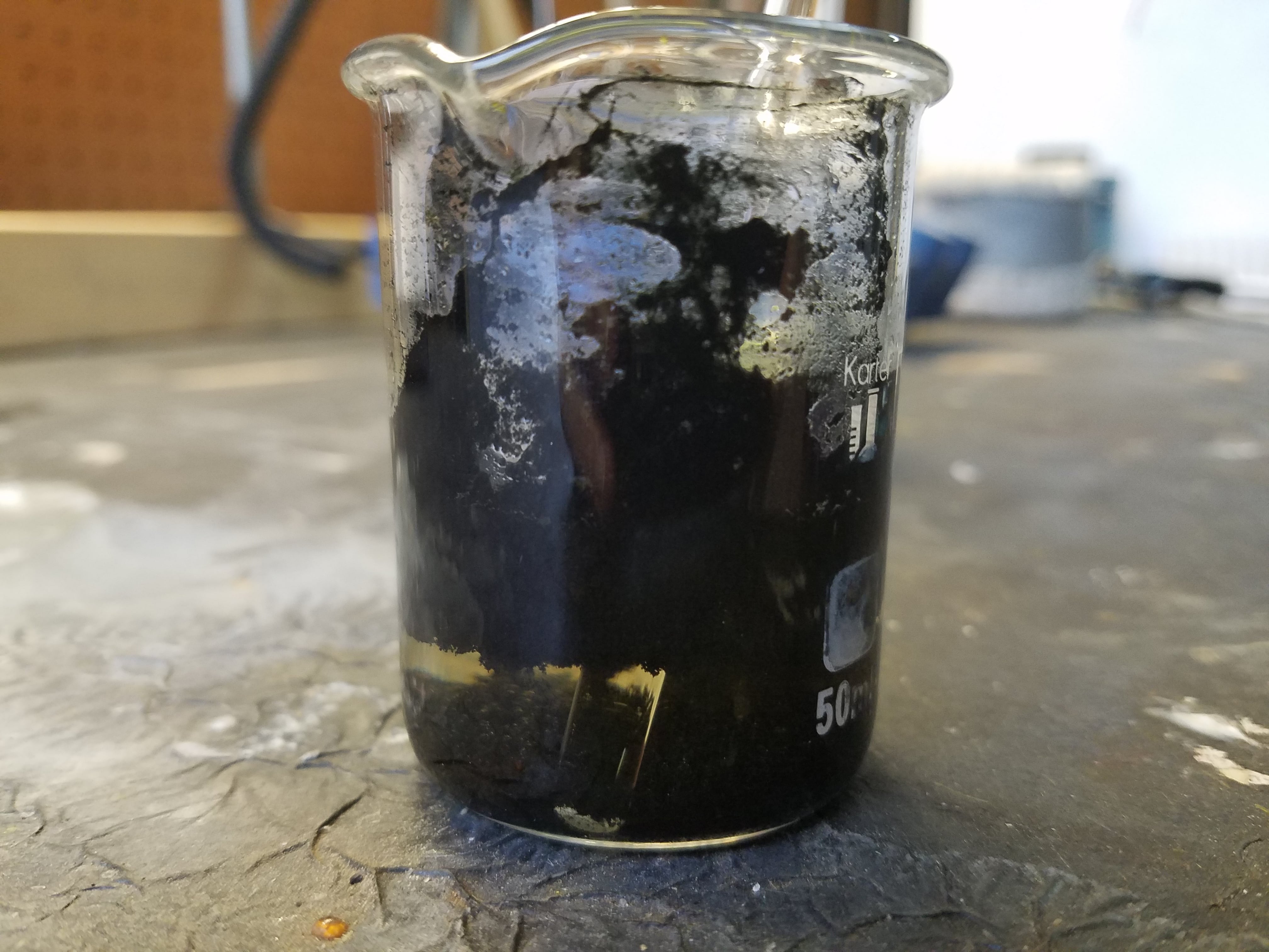

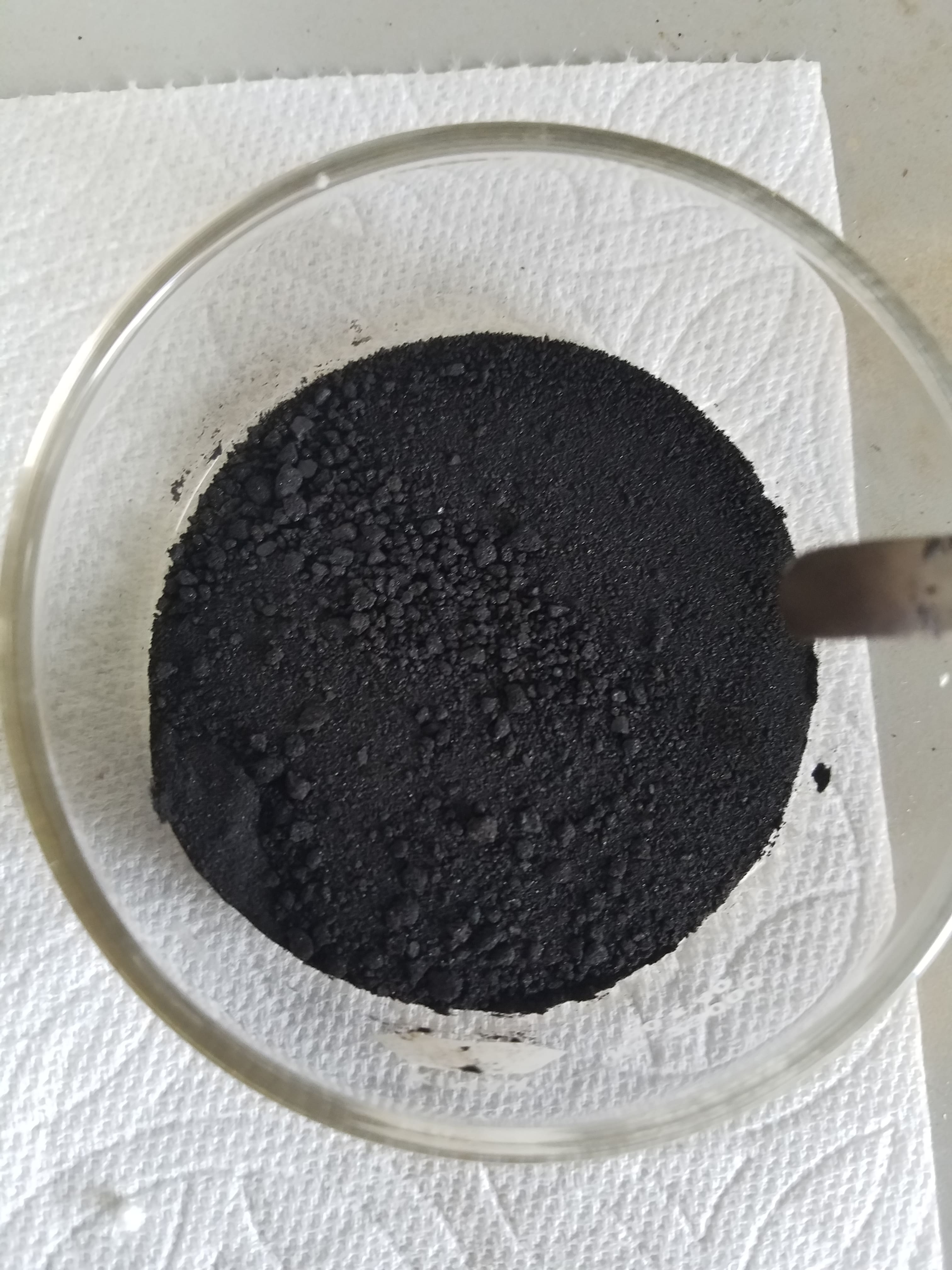

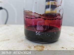

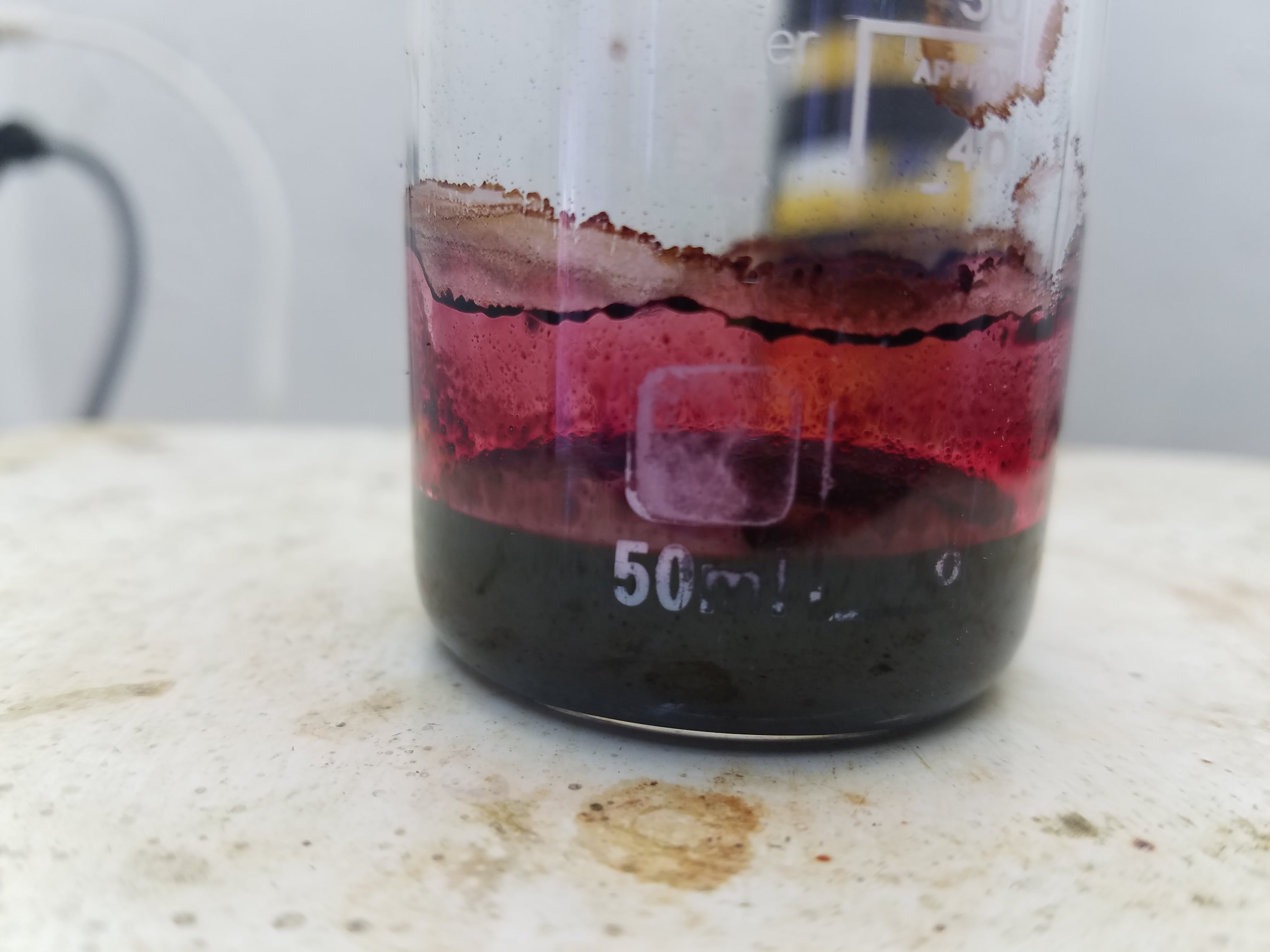

In a beaker, 4 (2 g) was dissolved in MeOH (5 mL). To this was added 16% aqueous HCl (9 mL) and the mixture stirred vigorously with heating (~70 oC). There is significant frothing as H2 and possibly CO is liberated. After a while the solution becomes clear with the title compound floating as a black solid. The solid is filtered, rinsed with water and MeOH and dried to yield about 2 g of 5 as a dark solid. The powder is really fine and has the potential to be pyrophoric. I had no issues, but something to be wary of.
20200426_165158-min.jpg - 387kB 20200426_190405-min.jpg - 825kB 20200426_191255-min.jpg - 744kB

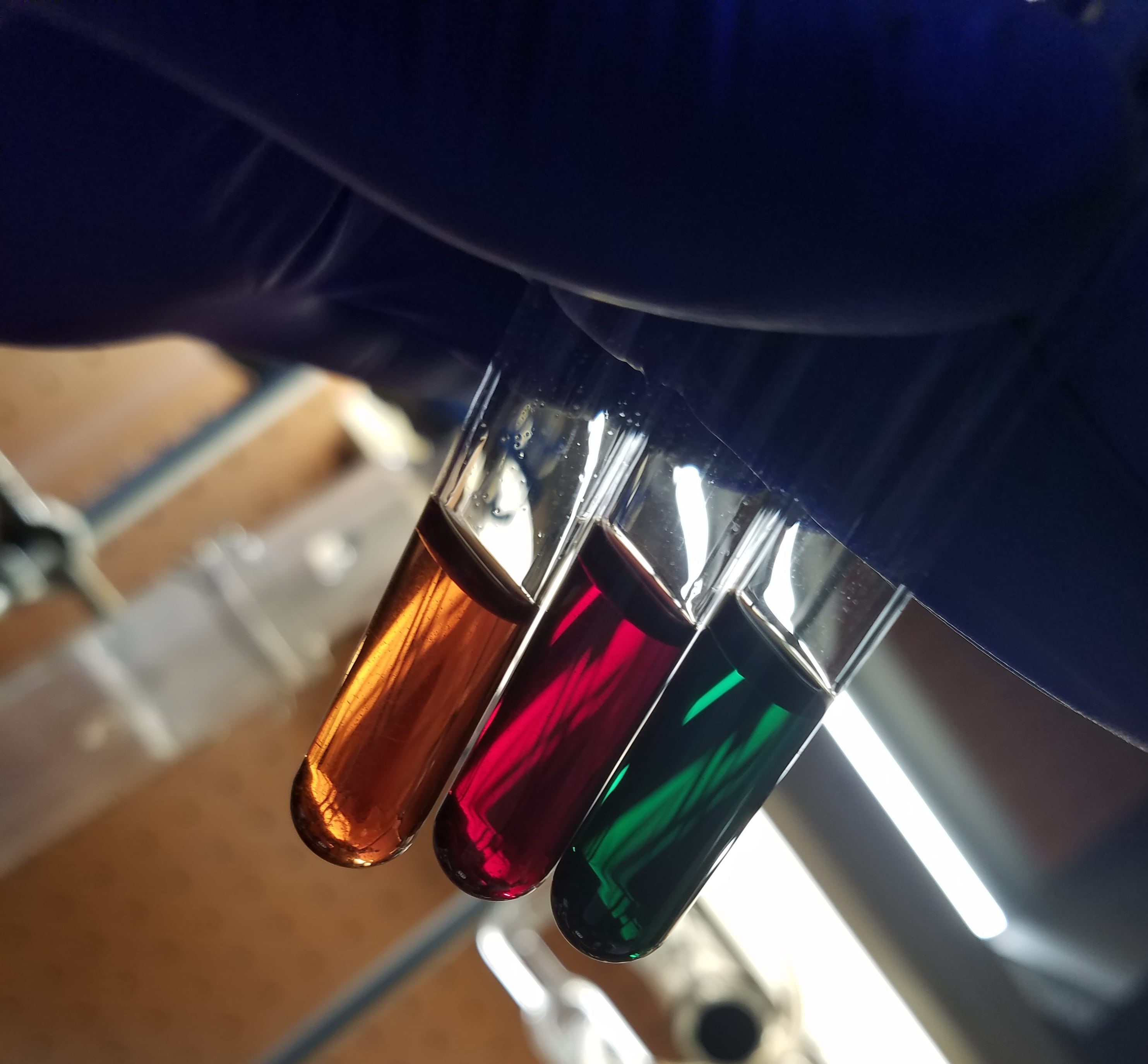

Although 2, 4, 5 are all black solids with slight hues under bright light, their solutions are highly colored. Here are tiny amounts of the respective pure compounds dissolved in acetone. This dark green is fairly unusual for an Iron0 species.

Nice work, I love the last picture! The Inorg. Synth. paper says such solutions will deposit iron mirrors if they are left standing in air - have you gotten one?
